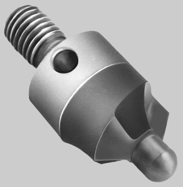

Threaded countersinks come with either removable or integral pilots. The integral-pilot style (Figure 2) predominates, because it has a controlled fillet radius at the intersection of the angle and the pilot, which is generally favored by the aircraft industry for countersinking. This design eliminates the sharp corner, which is a stress point on the tool. The radius is ground at the same time the pilot is ground to ensure tangency.
In most cases, if such a radius were ground into a removable-pilot tool, the user could employ only one size of pilot for that tool. This eliminates the chief advantage of a removable-pilot tool – to allow the use of many different pilots so that a separate countersink isn’t needed for each hole size. And if the pilot did not line up correctly because of runout in the hole or pilot shank, the user might score the hole or end up with a partial radius in the workpiece.
Figure 2: An integral-pilot carbide countersink. |
The carbide version of the integral-pilot tool is manufactured in two ways: carbide tipped, in which the cutting edges are carbide and the pilot is HSS; or solid carbide, in which the entire front end of the tool is carbide. The carbide-tipped tool is less expensive but has a shorter tool life than the solid tool, due to the wear on the HSS pilot. The more abrasive the workpiece material is, the shorter the tool life. The solid-carbide tool is superior if one considers cost per hole rather than cost per tool.

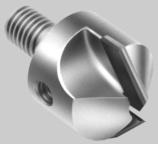

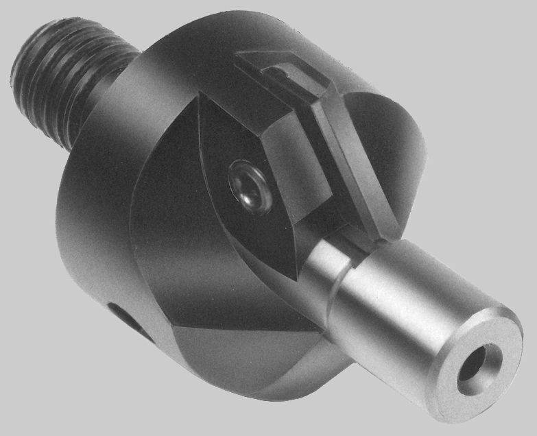

One of the problems shops face when working with PCD is the limited ability to grind certain tool geometries. But Craig Tools Inc., El Segundo, CA, has developed a tool that addresses this problem—the Versi-Sink, a replaceable-blade, removable-pilot, threaded-shank countersink (Figure 3). Unlike other PCD countersinks, the replaceable-blade tool has a controlled fillet radius. Normally, this filleted radius is difficult to achieve on a PCD countersink, especially in a 2-flute configuration, without causing lip-height variation. Craig accomplished this by grinding the blades separately on a specially jigged machine and then mechanically holding the blades in the body. The Versi-Sink accepts replaceable blades that have the controlled radius or replaceable straight blades for use when the radius is not required. The tool can be used in a 1- or 2-flute configuration. The pilot also is replaceable, so that as it wears out or the hole size to be machined changes, a new pilot can be installed and the same set of blades used. The radius will remain tangent to the pilot diameter as the insert locates on a ground flat on the pilot shank and can be set by the mechanic without the use of an optical comparator. This provides more versatility than the traditional removable-pilot countersink.
A brazed-tip, 2-flute, nonradiused PCD countersink can be used when the fillet radius is not required (Figure 4). The 2-flute design is generally preferable to 1- or 3-flute designs. Balance and cutting action is superior as long as the tool has good lip height. If one flute protrudes too much, then chatter and egg-shaped holes will result. In the past, this problem was more prevalent, so users opted for 1-flute PCD countersinks to avoid this problem and to minimize the diamond cost.
Figure 4: A nonradiused PCD countersink with replaceable blades and pilots. |
The 2-flute brazed PCD countersink is easy to recondition, provided the user has the right equipment. These tools, like all PCD tools, have very high clearance angles that must be maintained when the tool is reground to prevent a drastic reduction in performance. This problem often occurs when a user attempts to service these tools in-house. PCD is extremely difficult to grind on a standard tool-and-cutter grinder. In attempting to just clean up the cutting edge, the operator may reduce the amount of clearance by removing less material to make the job easier. This practice effectively reduces the clearance at the cutting edge. Therefore, it is usually much more cost-effective to send the tool back to the manufacturer for reconditioning.
