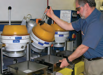

Courtesy of Rosler Metal Finishing USAA six-load, centrifugal disc mass-finishing system from Rosler features automatic loading and auto screening.Mass finishing parts at the machining center offers economic advantages.There are major economic and scheduling advantages to having a part come off a machining center complete.
April 15, 2011

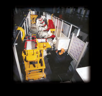

A Rosler automated centrifugal disc system finishes parts, separates them from the media and feeds the parts to final packaging.

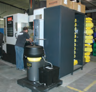

James Krier, sales and marketing manager for Burr King, Warsaw, Mo., noted that in the past 2 years he has seen more applications for deburring equipment at lathes and mills. While others provide roll-around units, Burr King offers a small, skid-mounted system that is moved with a floor pallet jack.
For the 1.3-cu.-ft. finishing machines typically found at machine tools, operators either chute the parts straight into the finishing machine, manually place them one at a time or input a batch at a time, depending upon part size. Vibratory machines are available in many sizes. Smaller machines fit well next to a machining center, whereas larger ones, such as a 3-cu.-ft. machine that measures 3 ‘ to 4 ‘ in diameter, are better suited for placement at the end of a cell.
Burr King vibratory machines have a filtration pack that removes fines from the unit’s recirculating 8-gal. water tank. The 2-sq.-ft. footprint of its 1.3-cu.-ft capacity machine is one of the smallest in the market, according to Krier. That system and the company’s 4.5-cu.-ft. machine use 15-amp, 120v power, normally from an overhead drop. Not requiring 220v is a major advantage for many shops because it simplifies moving the deburring machine.

For quickly finishing parts in a work cell, centrifugal disc machines are available. Steve Alviti, president of Bel-Air Finishing Supply Corp., North Kingston, R.I., noted that centrifugal discs used in cellular manufacturing have typical cycle times of 5 to 30 minutes, with a load/unload time of 2 minutes. The 10G centrifugal force in an open-top centrifugal disc machine allows users to apply very small media, which reaches into small part features. However, this size of media is not effective in vibratory operations because vibratory forces cannot move the media with enough force to deburr.
One Bel-Air cellular system finishes bone screws. The traditional way of making bone screws involved machining, deburring, secondary operations, passivation, inspection and inventorying them in lots of 2,000 parts. When QC at one part manufacturer found even a few rejects, it typically meant the entire lot of 2,000 had to be scrapped. It took 21 days, the process’ cycle time, until the next lot could be produced. By reducing lot size to 200 parts and putting a deburring machine and an ultrasonic cleaner at the machine, the manufacturer’s cycle time fell to 4 days, reject rates decreased dramatically and inventory shrank by 400 to 500 percent.

Courtesy of Burr King
A pallet-mounted vibratory system from Burr King is positioned at a machining center to finish parts after they’re machined.

More cellular finishing, including automated and semiautomated, is performed in Europe than in the U.S., noted Harold Wagenknecht, president of Rosler Metal Finishing USA LLC, Battle Creek, Mich. Rosler makes cellular systems for finishing small to large parts. For example, Rosler manufactures machines as small as ½ cu. ft. with bowls from 1.5 cu. ft. to 64 cu. ft. for finishing a host of parts, such as orthopedic implants, as well as machines for parts up to almost 2 sq. ft.
While most cellular systems have relatively standard layouts, sometimes Rosler designs vertical systems rather than horizontal ones because the cost of floor space is so high in some plants.
