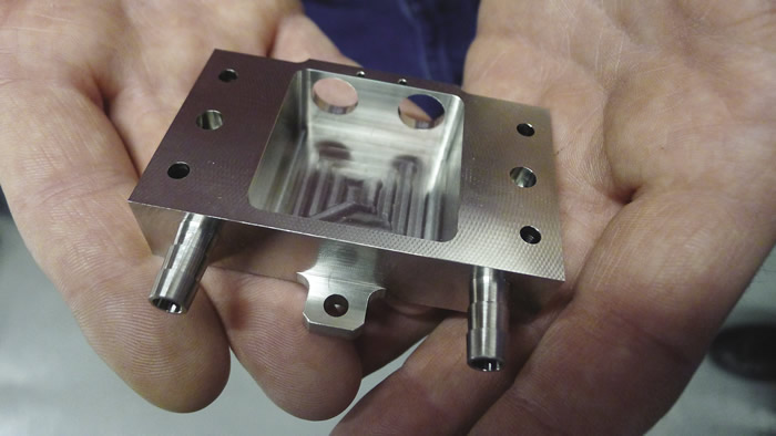

Kluba Machine LLC has built up a diverse customer base encompassing aerospace, defense, food processing, automotive and agricultural equipment since it opened its doors in November 2012. Each customer has a customized manufacturing process.
The Washington, Mo., job shop makes close-tolerance parts, generally small enough to hold in your hand, on four CNC vertical mills, two of which are 4-axis, and a CNC turning center.
For a new shop to make a go of it in these competitive times, it must keep the usual metrics in mind, such as quality, throughput, cycle times and total cost per part. But for owner Joe Kluba, the metric that weighs the most on his mind is spindle uptime. At a job shop where he used to work, spindle uptime was typically 37 percent, with an occasional surge to 42 percent. Kluba understood he would need to do better than that to compete with shops with mature processes.
Kluba Machine produces close-tolerance parts, with each part having a customized manufacturing process based on the specific needs of the customer. Images courtesy CNC Software.
