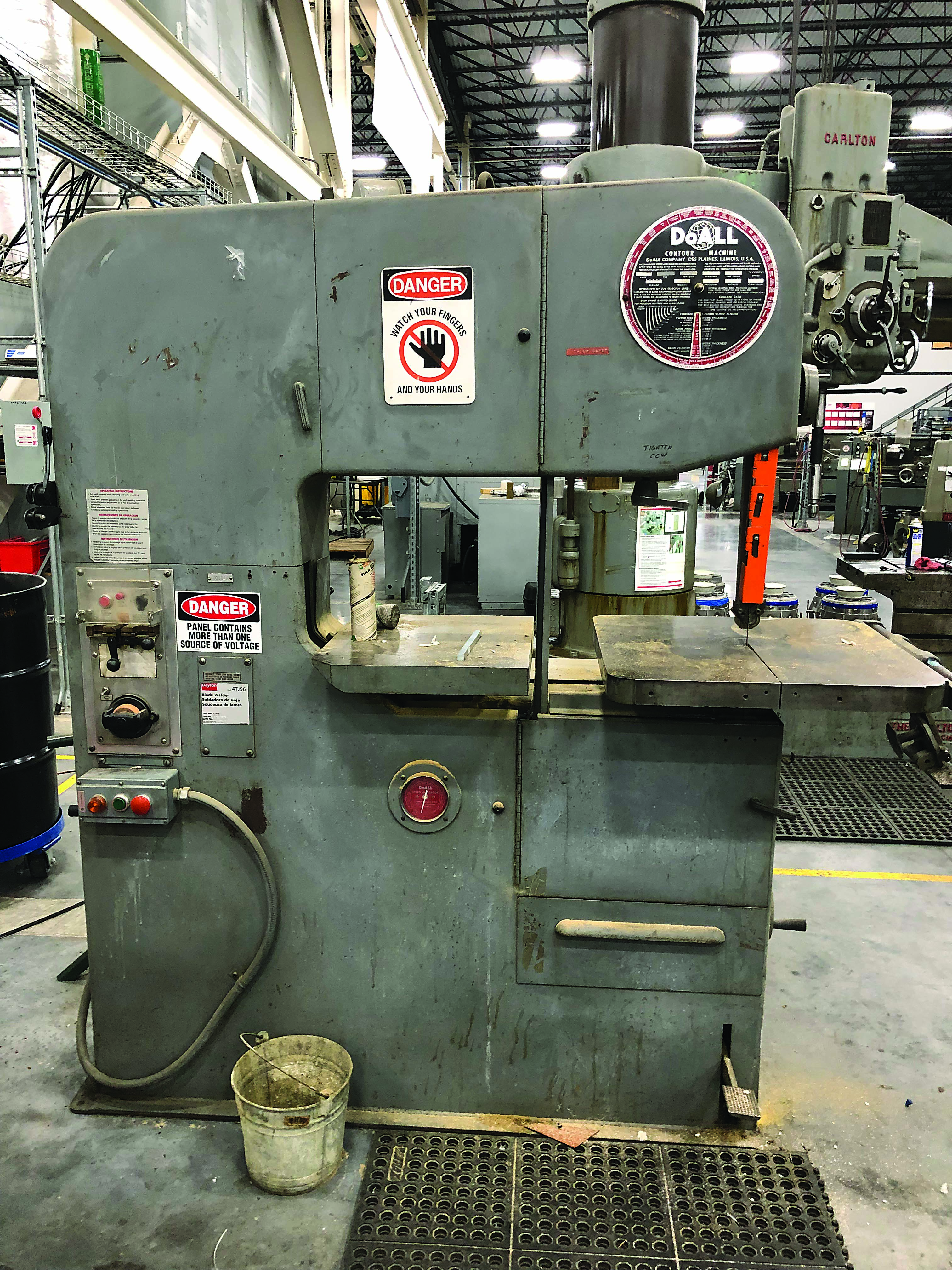

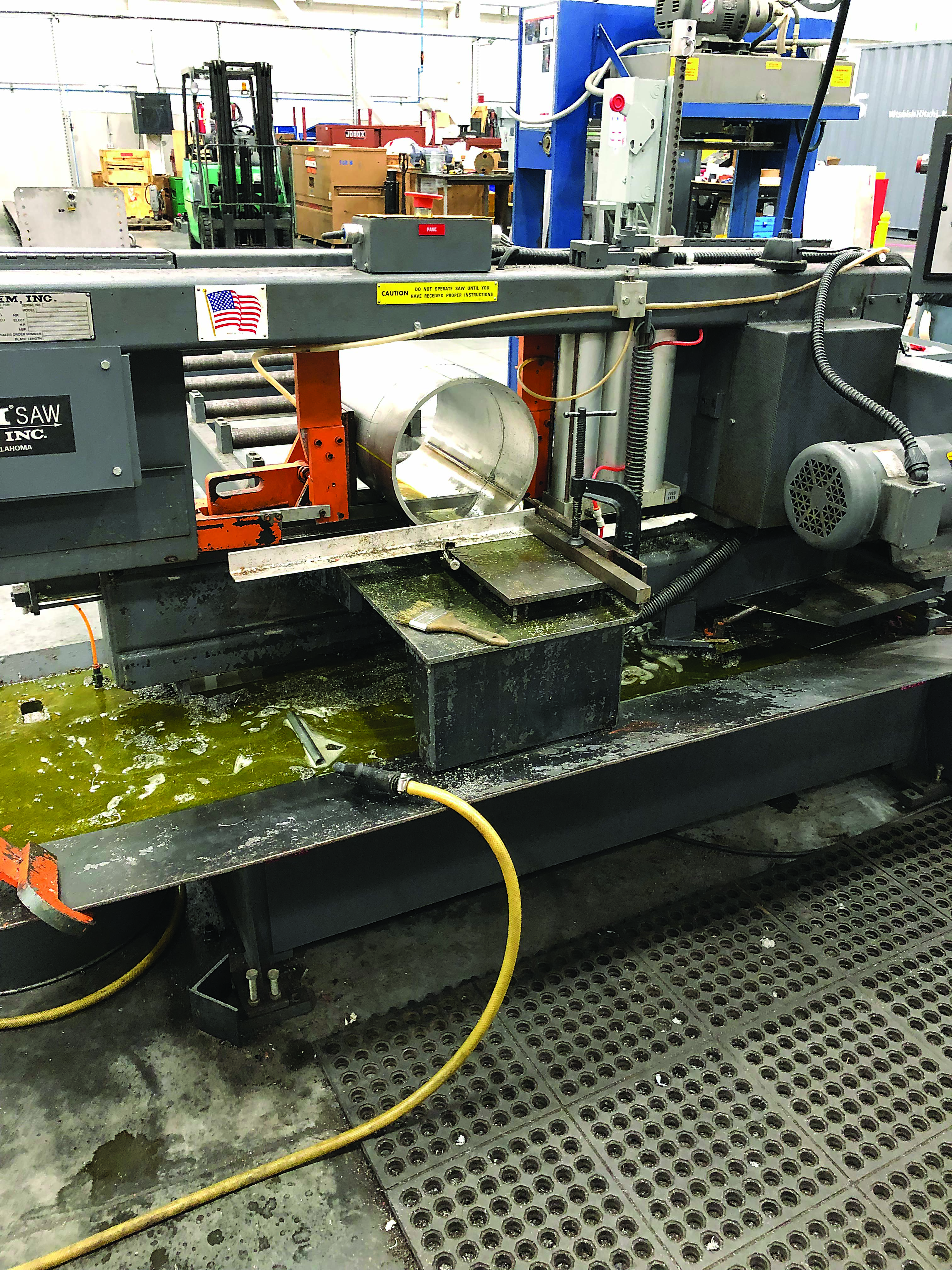

Sawing is the most common way to cut a workpiece from a larger portion of material, and the bandsaw is probably the most popular saw at machine shops. Bandsaws come in two varieties: vertical and horizontal. Vertical saws orient the blade perpendicular to the floor whereas horizontal saws have a blade parallel to the floor. Horizontal saws are best suited for bar stock, tubing and structural materials, like angle iron. Vertical saws are better suited for fine work, such as trimming or shaping features in a workpiece, before finishing on another machine tool. Vertical saws are sometimes fitted with CNC tables and used to cut bigger plates into smaller workpieces known as plate saws.

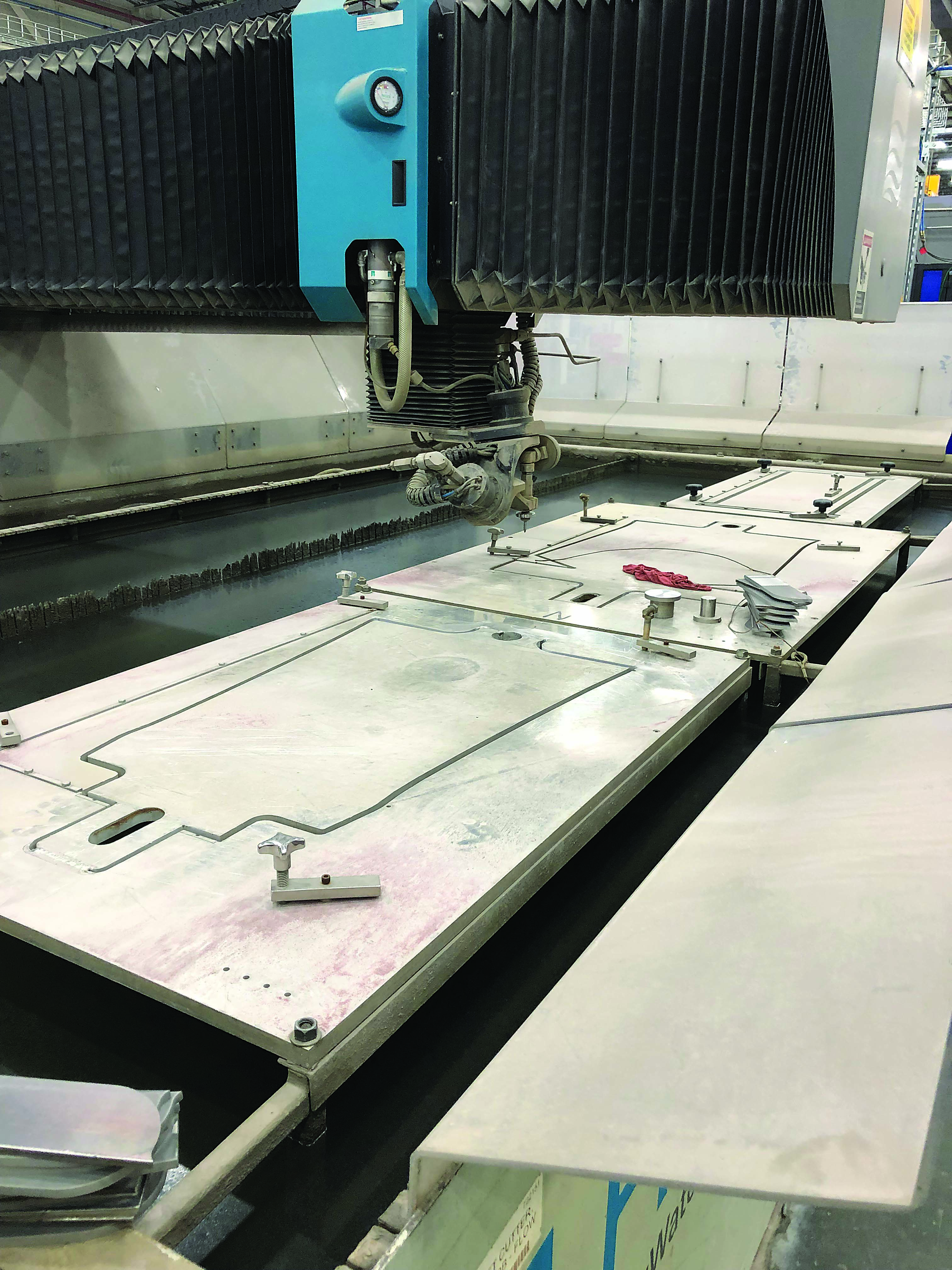

Abrasive waterjet cutting has few limitations, making it the most universal method for cutting flat stock. Image courtesy of C. Tate.

Vertical bandsaws (top) typically are operated manually and commonly are used to make quick cuts or perform roughing operations in a toolroom. Horizontal bandsaws (above) are best for sawing longer materials, like bar and structural shapes. Automatic and CNC bandsaws are suitable for high-volume environments.
Cutting thicker-plate materials and creating complex nonrectilinear shapes require such processes as abrasive waterjet, laser, plasma arc and oxy-fuel. These cutting processes typically are incorporated into CNC tables, many of which are as simple to use as a computer printer.
Molten Metal
Laser, plasma arc, oxy-fuel and similar methods are thermal cutting processes that provide sufficient energy to create a small, molten pool, which is expelled by compressed gases or gravity, along the toolpath. Laser cutting is the most accurate of the processes but the most expensive, and refractive materials, like aluminum, can reflect laser energy back into the machine and damage it. With added safety precautions, lasers offer the ability to safely cut nonmetallic materials, which is a bonus.
Plasma arc cutting is accurate but less so than laser cutting. Unlike with a laser, plasma arc cutting is not hindered by refractive materials. However, material must be conductive, so nonmetallics, such as plastic, are out of the question.
Oxy-fuel cutting is often the best thermal option for material over 1″. Oxy-fuel cutting systems are inexpensive when compared with other technologies and, like plasma and laser, are less challenged by thick materials. Efficiency does come with drawbacks. Flame-cut parts are less accurate than parts cut by waterjet, laser or plasma and may require significant cleaning before use. Oxy-fuel cutting thick material is also dirty as it creates large amounts of slag. Plus, a great deal of flammable, compressed gas must be kept on hand.
AWJ cutting has few limitations, making it the most universal method for cutting flat stock. It cuts anything that fits under the head and in the stream of water and garnet. Waterjet controls have seen substantial advances in the past decade, and issues with tapered kerf and poor surface finish have been eliminated, making waterjet cutting almost as accurate as laser cutting. Waterjet cutting is also environmentally friendly, producing no noxious gas, slag or hazardous waste to dispose of. Shops that cut a lot of complex shapes and wide varieties of materials may find waterjet cutting the best choice.
