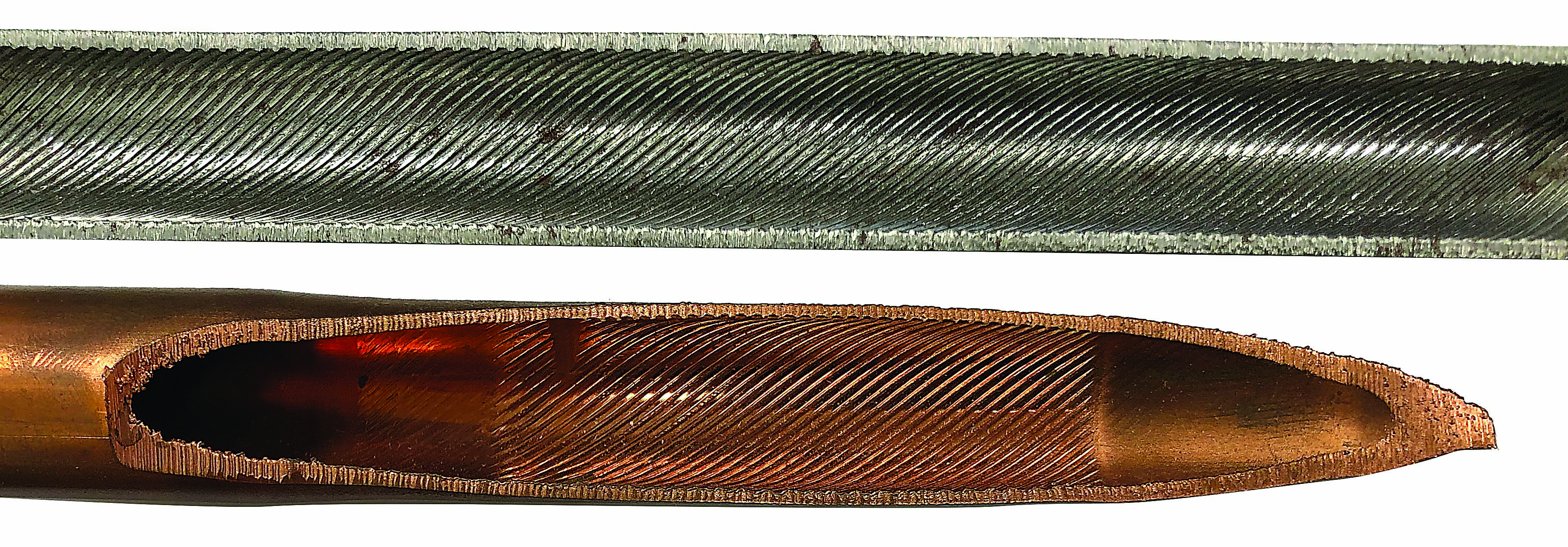

A fin tube cross section with internal profiling. Image courtesy of Kinefac

A fin tube also can have a finlike profile on the inside surface to increase the surface area and promote directional fluid flow or mixing. Turbulence induces mixing of each fluid, which can improve heat transfer for individual fluids. Turbulence can be controlled by the geometry and arrangement of the fins on the inside or outside of the tube. A helical fin path is most common on either or both surfaces.
Before talking about manufacturing finned tubing, let’s look at the characteristics of a typical fin tube product. Fin tubes come in all shapes, sizes and materials with varied fin heights and thicknesses. The tubes generally are made of welded tubing in stainless and low-carbon steels, copper, brass, aluminum and exotic alloys. One important characteristic to consider for manufacturing is length. Some fin tubes are manufactured in continuous lengths of 100′ or more, which then are bent into compact shapes to fit inside various heat exchangers. Other relevant traits are tube diameter and wall thickness, fin height, the number of fins per inch and tube material grade and construction.
In simple terms, a fin tube can be thought of as a hollow, threaded rod. However, the simplicity starts to diminish when there are 60 or more thin threads per inch with an additional threaded profile on the ID over a 100′ length. Two processes traditionally are employed to produce external threads on the outside of a workpiece: thread cutting and thread rolling. Both methods have strengths and weaknesses. Thread rolling is the process to beat, though, when it comes to manufacturing fin tubes at high rates of speed. There are also benefits with material savings, strength, surface quality and the ability to generate internal profiles without wasting material by generating chips.

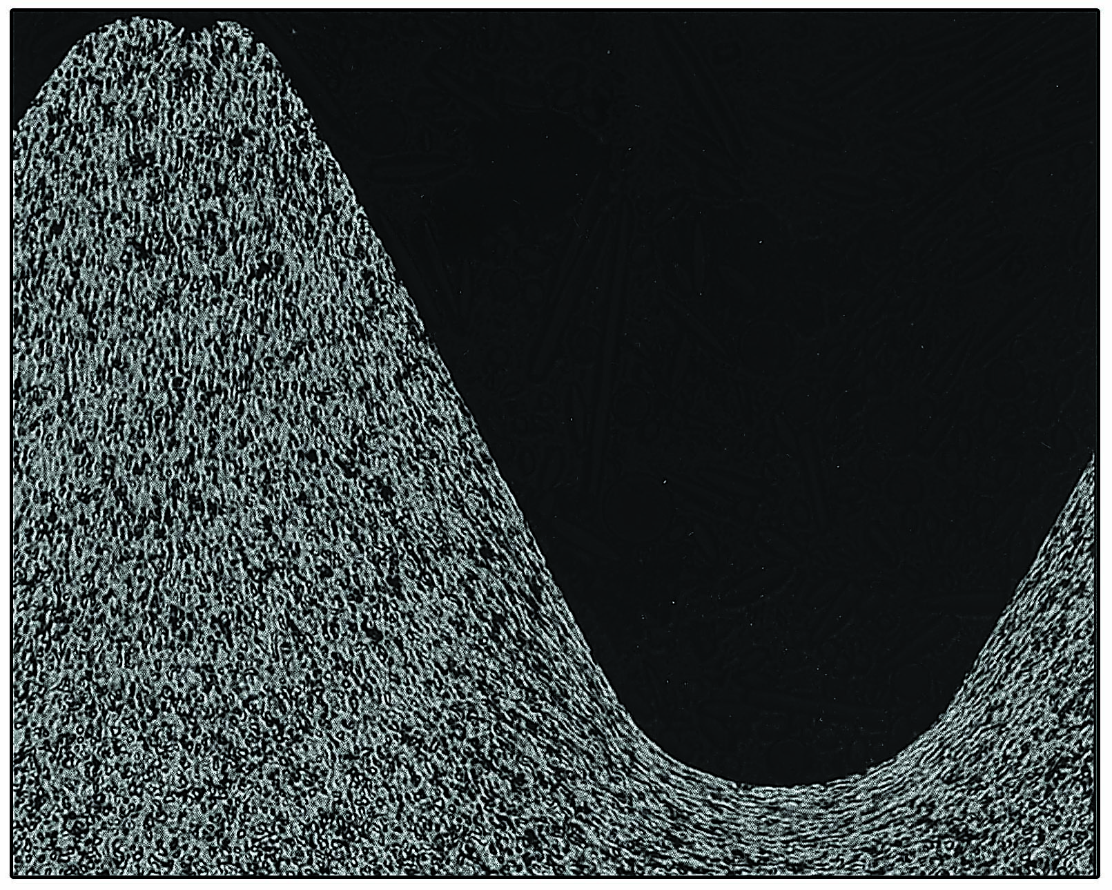

In either case, the blank material is forced to conform to the die geometry without removing or gaining material. Therefore, thread rolling is a constant-volume process. The starting pre-roll blank is smaller in diameter than the final thread major diameter—usually somewhere near the thread pitch diameter—because material from the blank is displaced radially outward by the dies to fill the form. Material also can and will flow in two other principal directions, axial and circumferential, depending on several factors, such as the degree of form fullness or the ratio of thread depth to root diameter.
A typical machine screw thread can be rolled into a bolt blank in a few seconds. The feeding of the bolt blank into and out of the rolling machine usually takes longer than the rolling process itself. Rolling generates an uninterrupted grain flow around the rolled root, which helps enhance strength to a rolled thread over a cut thread. Other characteristics, such as material workhardening and a highly burnished surface from the rolling action, also help increase the strength and quality of a rolled thread.

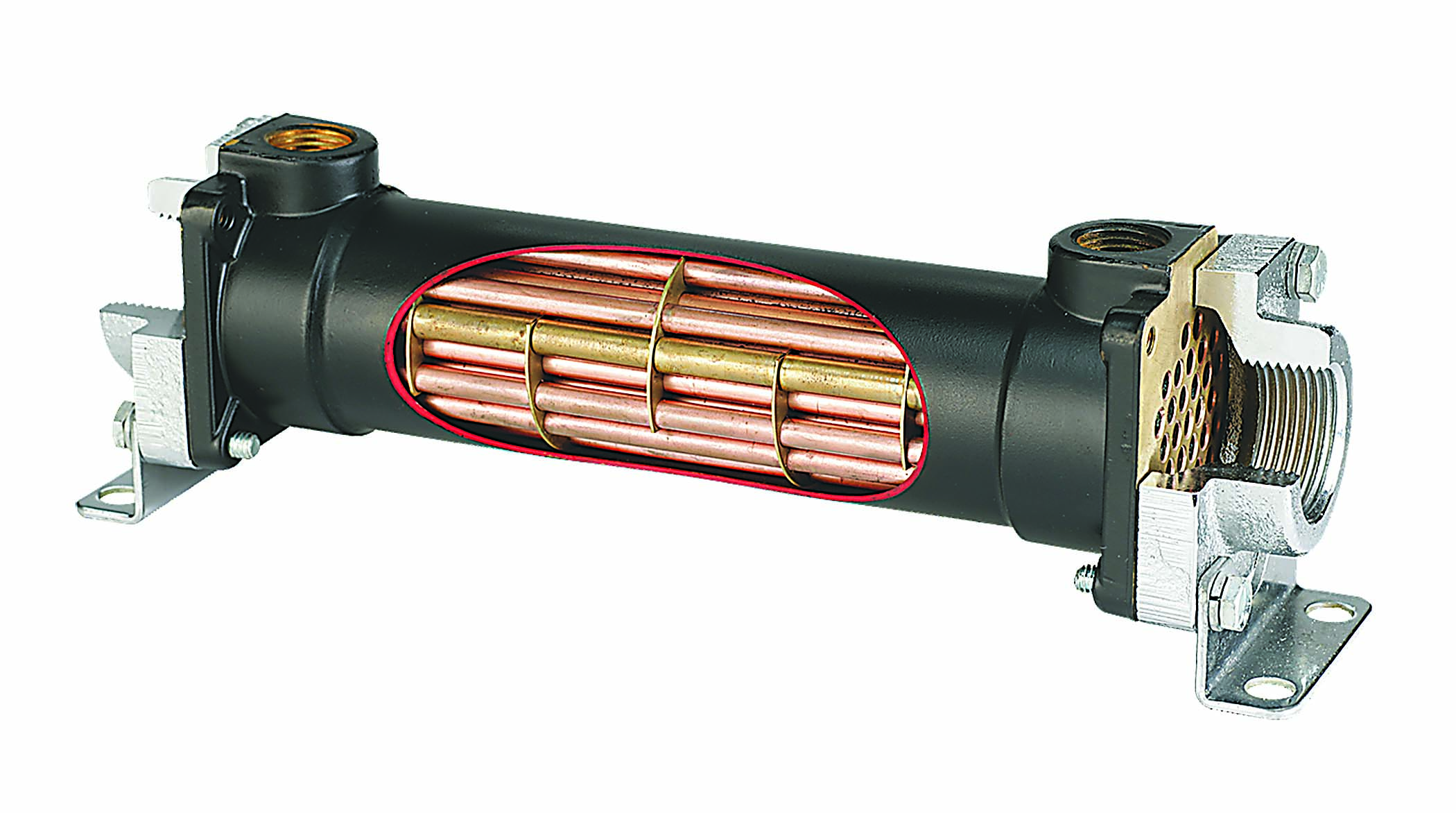

As previously noted, long lengths of fin tubes typically are bent into special shapes to fit inside a heat exchanger shell. It is desirable to have no fins present where bends occur when performing a bending operation. This avoids fin damage and takes advantage of the full tube cross section. Fin rolling machines can provide radial motion of the disc dies both into and out of the tube to allow spacing between finned sections as required. The tube advances axially through the dies during the period of die retraction to create a length of space before plunging the dies back into the tube to continue producing rolled fin.

A typical shell and tube heat exchanger. Image courtesy of Thermal Transfer Systems Inc.
