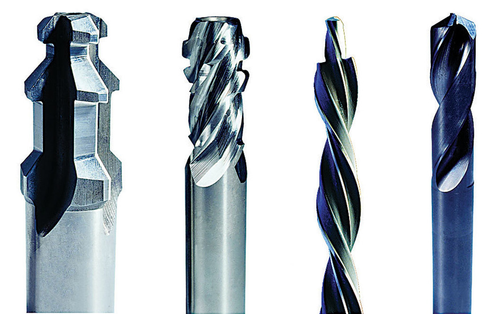

The tool types include carbide, carbide tipped, HSS including cobalt ones and PCD for cutting metal, wood, plastic and composites, said Joe Carone, company president. For metalcutting applications, GCT primarily resharpens endmills and drills, including ones from brands the company does not distribute. The quantity a customer provides for resharpening ranges from one to 300 or more.

With 16 employees at the company's 4,000-sq.-ft. facility, GCT's size works to its advantage, according to Schuster, especially when resharpening and modifying complex tools, such as drills with double margins and step tools. "We can pivot and move very quickly because we're small, like a sports car, and easily able to satisfy the customer."

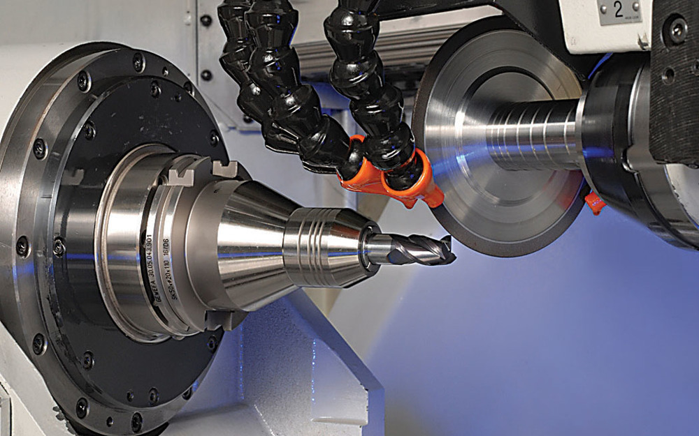

After the customer approves the quote, the tools are resharpened on one of GCT's four 7-axis CNC ANCA grinders. The machines are standard, but the grinding wheels are not, Schuster said. "Every single one of the wheels we use is specialized for our shop in one way or another, whether it's the size, the angles, the shape or the grits. None of them are off the shelf."
Oil is used to lubricate the grinding wheel/tool interface, Schuster noted, adding that the use of oil helps extend machine life compared to water-based coolant, which can cause a tool and cutter grinder to rust and experience other issues. The company also has manual grinding machines, which sometimes produce a better result for the customer or are sometimes used in combination with a CNC grinder.

In addition, GCT can modify a tool to better suit a customer's specific application, Schuster said. An example is when an end user is applying a general-purpose tool to cut 6061-T6 aluminum. "They are going to see better performance because now their tool is optimized for that material."
The company also modifies tools in other ways to target an application, such as extending its length, he added. "They can push it a little bit deeper and get the value out of sharpening versus buying a brand new tool."
Although indexable inserts are rarely if ever resharpened, Schuster said GCT can grind special forms on inserts, such as a chamfer or radius.
The number of times a tool can be resharpened depends on the application and customer preferences, Carone said. Typically, a tool can be resharpened at least three times, but GCT has reground some tools many times more.
