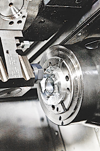

Planet_LIVETOOLCUT2.tif
Courtesy of Planet Products
An axial-driven tool and holder from Planet Products mills a keyway on a shaft.

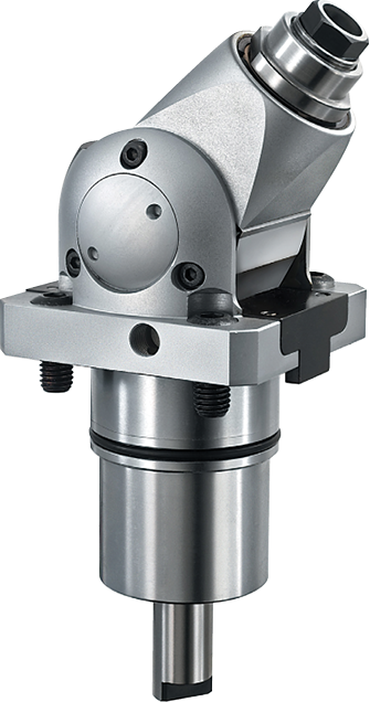

Koma_MCU-1%2c5%20nakamura.tif
Courtesy of Koma Precision
A BMT-style universal angle head from Koma Precision for a Nakamura-Tome mill/turn machine.
Although on a much smaller scale, milling on a lathe means bolting the heart of any machining center—the spindle—to a lathe turret. On plain Jane lathes, this turret is nothing but a hunk of iron that indexes and provides a place to mount stationary tool blocks. On live-tool machines, however, the turret and the housing to which it is mounted contain a powerful drive mechanism—typically a planetary gear train and a servo- motor—that engages with a drive tang on the driven toolholder. Attach one of these holders to a live-tool capable turret, load an endmill or other rotary tool and you have a miniature machining center.

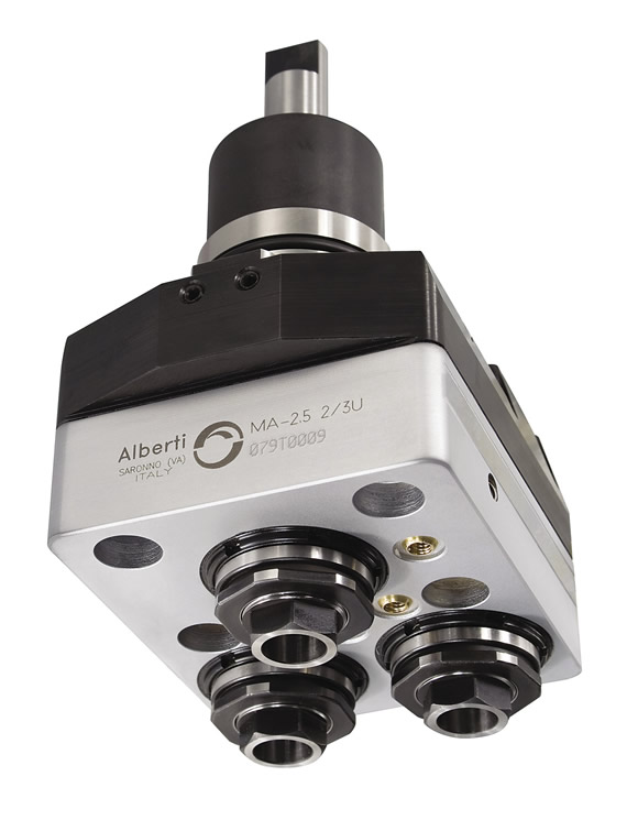

Koma_MA-2%2c5%203U.tif
This Alberti MA-2.5 3U ER-16A collet output tool, distributed in the U.S. by Koma Precision, is used for multitool applications. It can perform center drilling, drilling and tapping on a single turret station.
The bottom line is that machine tool builders have not yet agreed upon a standard for mounting driven toolholders as they have with, for example, CAT 40 milling holders. Check the Web site for most any driven toolholder manufacturer and you’ll find a catalog for nearly every builder under the sun. This lack of standardization is a costly headache for any shop owner with multiple makes and models of CNC mill/turn machines. It’s a Wild West where every .45 caliber pistol on the street uses a different type of bullet.

Complex milling requires a radial milling head, like this one from heimatec, and Y-axis capability.

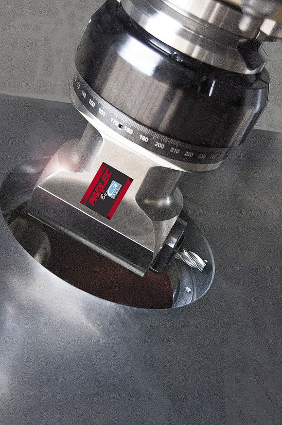

Parlec_DSC_1415%20COVER%20logo2NO%20RIGHE-2012%20copy.tif
Courtesy of Parlec
Milling the inside of a large counterbore might otherwise be impossible without an angle head, such as this one made by Gerardi in Italy and distributed in the U.S. by Parlec under part number F90-16-BT50.
“You buy a mill/turn lathe and the driven toolholders are an extension of that capability—you need them to do the work that machine was designed for,” he said. “In the case of an angle head, though, you’re not just adding a tool but actually increasing the capability of the machine.”
Typically used on 3-axis vertical machining centers, angle heads hold a cutting tool horizontally rather than vertically and use a 90° gear train to spin the tool. This allows shops to drill holes or machine features in the X-Z and Y-Z planes. By rotating the head to a fixed angle in the horizontal plane, angled surfaces and holes can be machined on the workpiece sides. And on larger workpieces, the head can mill inside a pocket, space permitting. Best of all, most angle heads are small enough to be used with an automatic toolchanger, so there’s no need to interrupt production with a manual tool change.
“Angle heads are a machining solution,” Hartman said. “For shops that have a 3-axis machine but need to do 4-axis work, investing in one of these toolholders makes a lot of sense. Installation is straightforward—a simple stop block is mounted on the spindle head to keep the tool from rotating. This means you can use the same angle head across multiple machines.”
Hartman explained that the Parlec by Gerardi Evolution angle heads are modular, so different taper shanks can be accommodated. This means easy repurposing when a new job comes in the door, an important consideration when spending $6,000 or more for a single toolholder.
