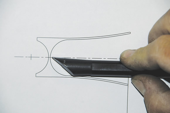

  • Use a full-scale drawing to check tool clearances with the actual tools you plan on applying. When in doubt, check it out. The bottom of a deep bore is not the place to find out the tool didn’t have enough clearance.

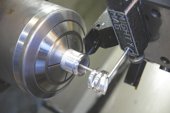

  • Delicate parts that shouldn’t go through the chip conveyor can be caught using a magnetic catcher snapped onto the parting station. Be sure to include an M01 or M00 full stop in the program to remove the parts before too many collect and cause a problem.

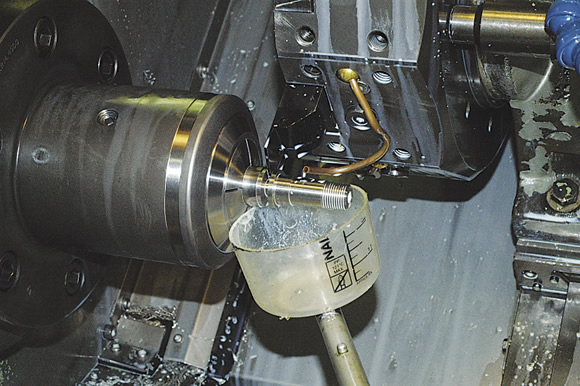

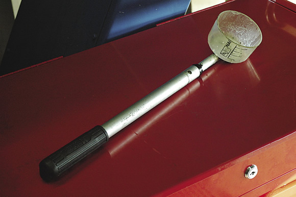

  • If you don’t have a parts catcher on your lathe, use constant cutting speed when parting right up to the point where the piece almost detaches, then switch to a slower constant speed for the final parting off. This prevents flinging the part against the turret or enclosure and damaging it.
  • If you really need to catch the part, use an M01 or M00 right before the part separates and use a catch cup on a stick—the one I made has a telescoping handle (see photo on page 23). Be sure to turn the coolant off in the program so you don’t take a bath when you fire it back up, but don’t leave too much to part off with the coolant turned off. Leave just enough to give you time to sneak your catch cup into position.
