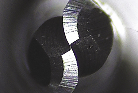

This 2-flute ballnose endmill from Advanced Tool is made with the proper web thickness and gash, which refers to the center of the endmill. A slight “S” curve to the gash, known as a helical gash, runs from the top to the bottom. A helical gash on a ball endmill is an advanced geometry design, enabling less of the cutting edge to contact the part at one time and reducing pressure to the cutting edge.

When developing a solution, Advanced Tool incorporates its trademarked Wear Analysis process, which includes microscopic inspection to examine how an endmill is wearing and finite element analysis to help determine which avenues to follow. Based on the analysis, the toolmaker will determine whether to target the substrate, geometry or coating first. “We try to only change one or two elements at a time and build upon that,” DePerno said. “Then we put that tool out in the field, do another Wear Analysis and ask ‘Are we getting further or closer to where we’re trying to be?’ “

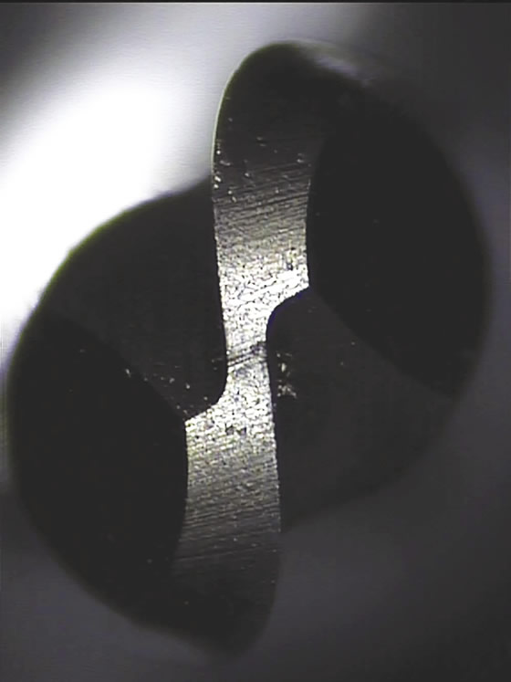

For example, when poor tool life occurs, Advanced Tool looks at geometry as a possible culprit, DePerno noted. The endmill may require an adjustment to the core thickness, clearance angles, rake angle or helix angle to improve performance. Poor tool manufacturing can also cause issues. A web that is too thick, for instance, creates a dead area on top of the tool that requires more pressure for it to cut, causing premature wear.

The web shown at the center of this “brand X” 2-flute ballnose endmill is paper thin. It is far too thin for the tool to perform properly, because the section is too weak and will ultimately break during use. This endmill also has a poor surface finish, indicated by the highly visible small lines running horizontally on the cutting edge.

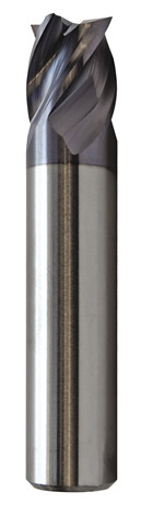

This 4-flute, high-performance endmill offers enhanced corner protection and enhanced geometries, according to M.A. Ford.
