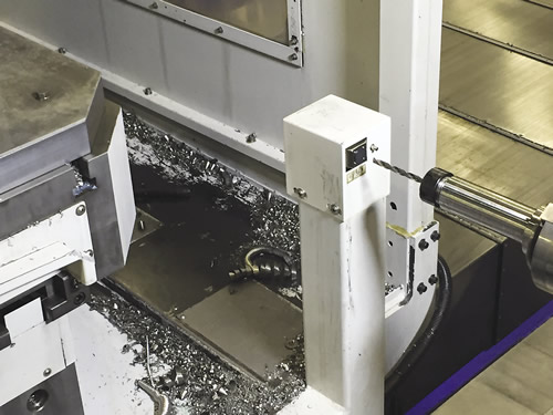

Having a tool setter integrated into a machine allows tools to be set before each use, and checking its length each time a tool is used mitigates tool wear and can detect tool breakage.

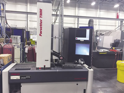

This Parlec tool setter at Mitsubishi Hitachi Power Systems Americas’ combustion shop measures tools up to 800mm in diameter and 1,000mm in length.
This Parlec tool setter at Mitsubishi Hitachi Power Systems Americas' combustion shop measures tools up to 800mm in diameter and 1,000mm in length.
