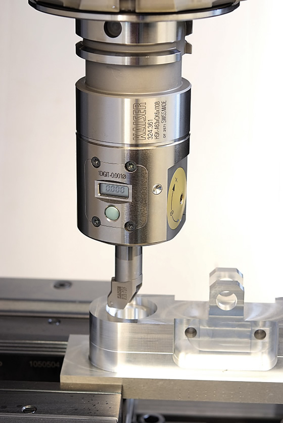

Kaiser’s new Series 112 EWD 2-54 precision-finish boring head has a built-in digital display that allows operators to make adjustments on the fly. The digital unit uses accessories from the Kaiser EWN 2-50XL Series, accommodates through-coolant and can be operated at a maximum spindle speed of 20,000 rpm.
Digital has become the common language in metalworking and machining. The primary advantage of digital is its precision. There’s nothing subjective about a numerical reading. And this advantage has made its way to the boring head, where it is has been established technology for 10 years but is still far from being universally used.
As such, digital boring heads bridge the technology gap between digital measuring technology and existing tooling systems by adding a digital readout (DRO) to clearly show incremental diameter changes. So when an operator measures a bore and finds it undersized by 0.0004 ” on the DRO of his measurement device, he simply has to zero the boring headreadout and adjust the diameter until the digital display reads “+0.0004 “.”

Digital boring heads are, quite simply, easier to work with than analog heads. For tight tolerances, the ability to display actual cutting edge movement means operators don’t have to constantly check for accuracy for fear of backlash. Cartridge screw adjustment as a function of turning a dial screw or ring until a specific mark lines up is very accurate and still viable. But if boring heads aren’t properly maintained, operators can experience backlash.
Kaiser’s Series 310 EWD boring head’s measurement system shows precise linear movement of the tool carrier, permitting diameter adjustments of 0.00005 ” (0.001mm).
Backlash is slop between the adjustment input and the tool carrier output. An operator rotating an adjustment ring or turning a dial on a worn or abused analog boring head may not notice any diameter change of the cutting edge on a tool presetter—even after moving several clicks or dial marks.
While the presetter is essential for initial setup, boring often requires a test-cut-and-adjustment procedure, which is most accurately completed while the tool is in the spindle. Heads with backlash make operators wary of adjusting tools in the machine spindle, which costs time and possibly accuracy if the boring bar does not sit in the presetter spindle exactly the same way as it does in the machine tool.
A digital system isn’t concerned with the input mechanism itself; rather, it measures the tool carrier travel directly, so an operator always has access to the true digital diameter readout. It doesn’t measure where the scale ring or dial says the cartridge should be—the real distance is on display.
