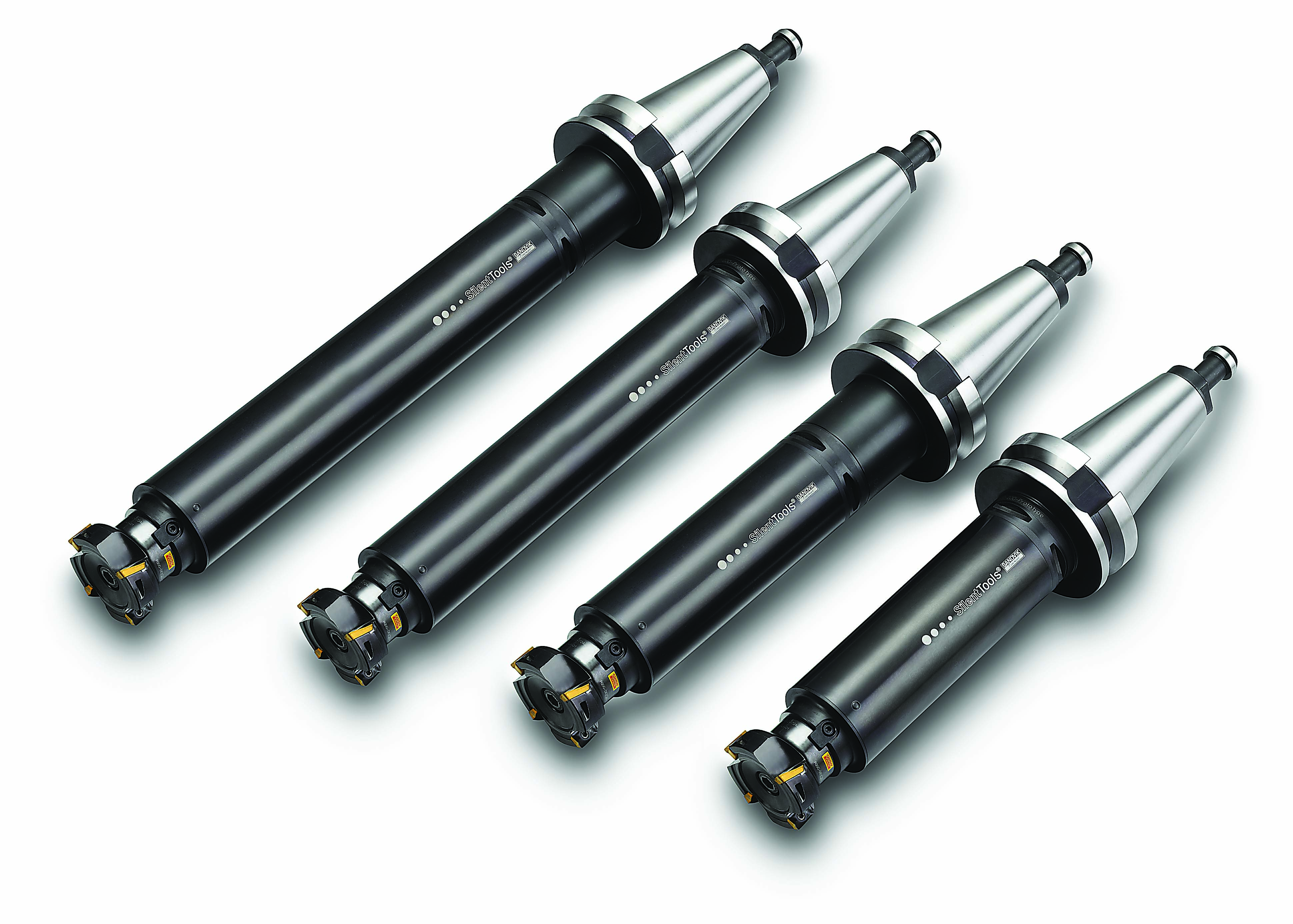

The Coromant Capto is available in various length extensions. Photo credit: Sandvik Coromant
Sandvik Coromant’s Coromant Capto is available in various length extensions to optimize applications and with dampened extensions to minimize vibration. Image courtesy of Sandvik Coromant
All the recent investment in multiple-axis machines, with their increased accessibility to workpieces, has made many people believe that the need for extended-reach toolholders is greatly reduced if not eliminated.
“With the 5-axis, I can tilt things around to get into those places using a standard toolholder, but you’re always working off the center of the table,” Burley said. “So everywhere around it, there are going to be certain tilts that make it difficult to reach, like the B-axis all the way at 90° to the spindle, and some features down by the table itself.”
For situations like those, he thinks that extended-length toolholders always will be needed.

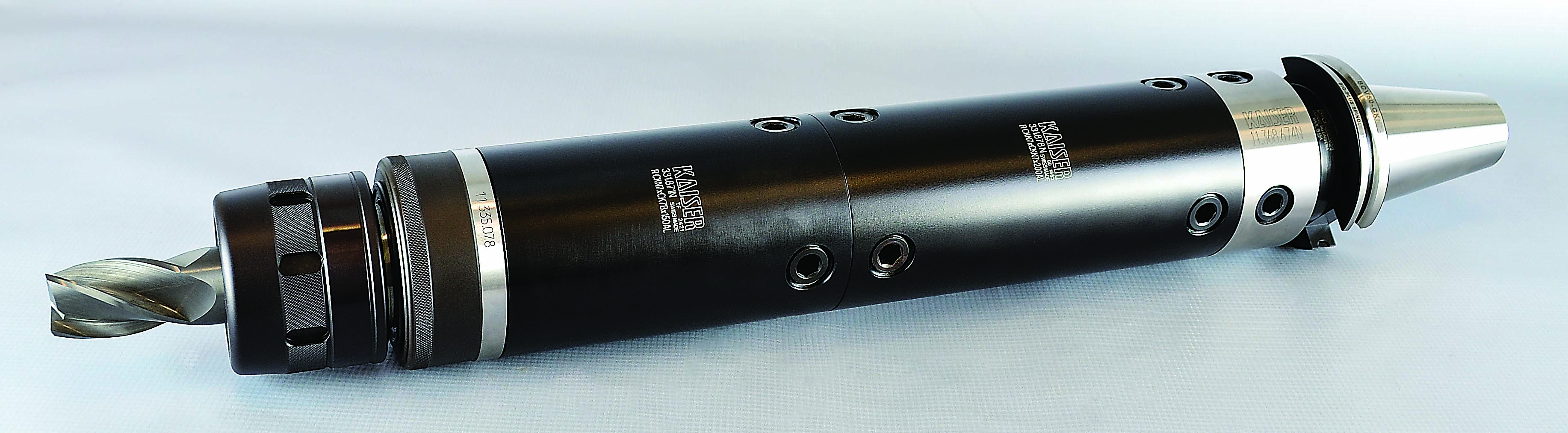

This modular toolholder system for larger, heavier tools includes a lightweight aluminum insert for extended-length toolholders. Photo credit: BIG KAISER Precision Tooling
This modular toolholder system for larger, heavier tools includes a lightweight aluminum insert for extended-length toolholders. Image courtesy of BIG KAISER Precision Tooling
He considers extended reach to be any toolholder longer than five to seven times the diameter.
“It’s important that we keep those two things related,” he said. “So if we’re talking about 14" of reach and the tool diameter is only ½", we have a ratio of 28 times the diameter. But a 2"-dia. tool at 14" length is only a 7-1 ratio, which is not particularly extended length.”

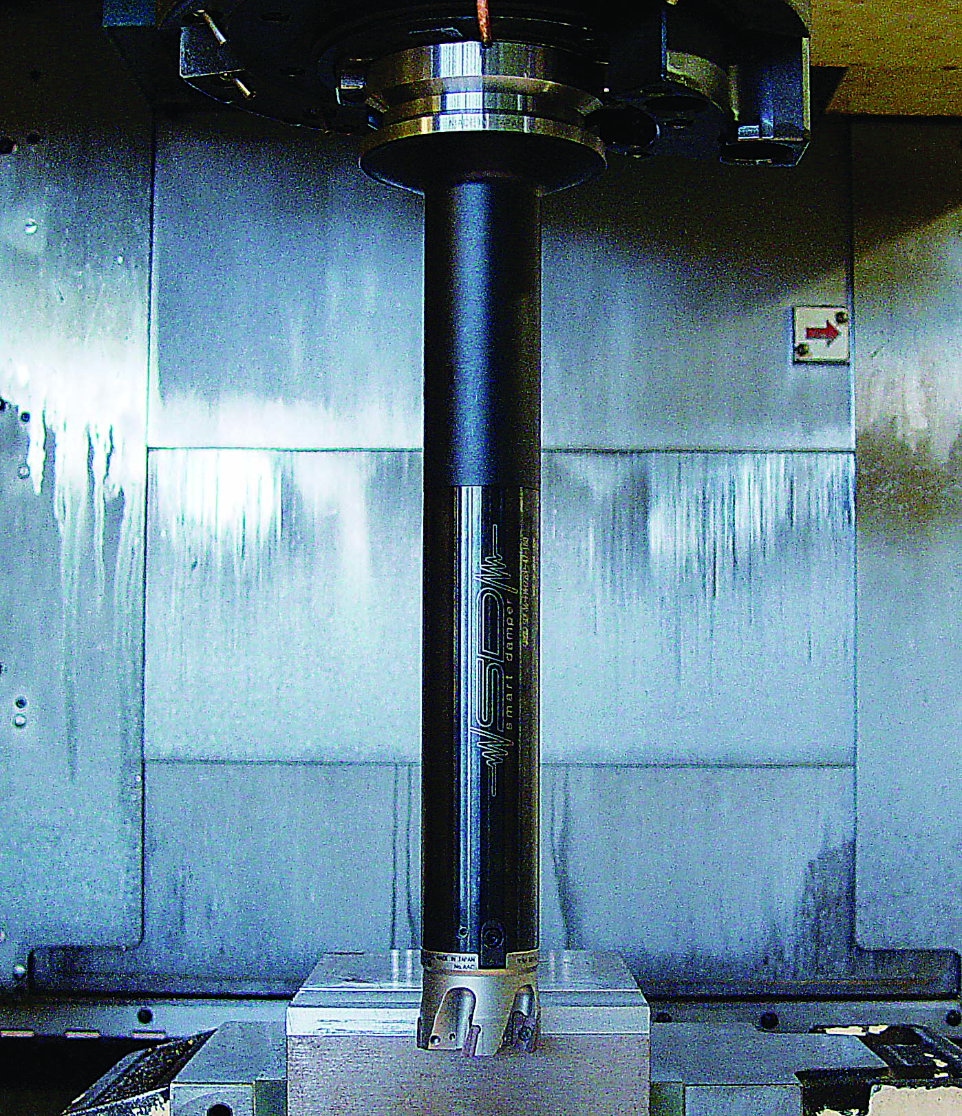

An integrated damping system for extended-reach facemilling eliminates vibration for higher productivity, better surface finishes and higher removal rates. Photo credit: BIG KAISER Precision Tooling
An integrated damping system for extended-reach facemilling eliminates vibration for higher productivity, better surface finishes and higher removal rates. Image courtesy of BIG KAISER Precision Tooling

Several companies provide holders with vibration-damping technologies.
“The further the overhang of the tool assembly, the more vibration will be introduced,” Backus said. “If they’re taking a light cut with a milling cutter or they’re drilling, they may get by with a pretty long assembly. But if they’re doing a heavier cut with the milling cutter, they need something like our Silent Tools milling adapter to dampen the vibration.”
Anti-vibration technologies typically are based on a damping mass, which is often a heavy metal, a fluid or both inside a holder to offset vibrations.
“In many cases,” Backus said, “with our vibration-damping toolholders for turning, boring or milling, it can be a great productivity booster without needing to make reductions to the cutting data.”
