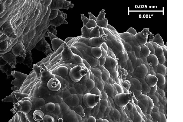

This scanning electron micrograph shows typical damage that can result from laser machining carbon fiber-reinforced plastic.

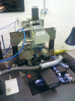

Courtesy of General Engineering Research Institute
Experimental setup of the JK200FL fiber laser at Liverpool John Moores University.
An additional type of thermal damage—epoxy recession—needs to be minimized when laser machining composites. That occurs because the fiber reinforcement is harder than the epoxy matrix, which tends to burn back farther than the fibers when laser machined. Fibers then protrude as a result.

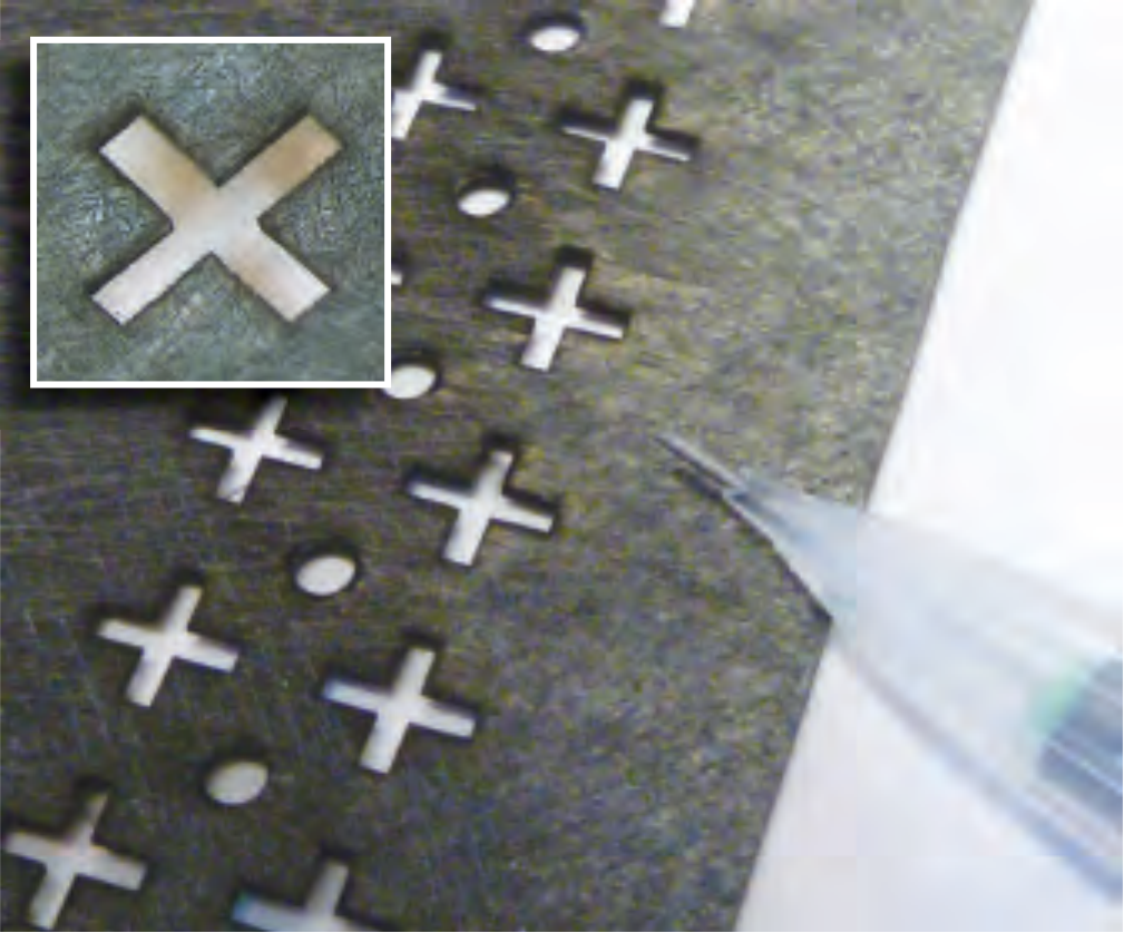

Laser Micromachining Ltd. laser machines a variety of composites, including glass fiber-reinforced composites, such as this one with 5mm-wide crosses and 2mm-dia. holes.

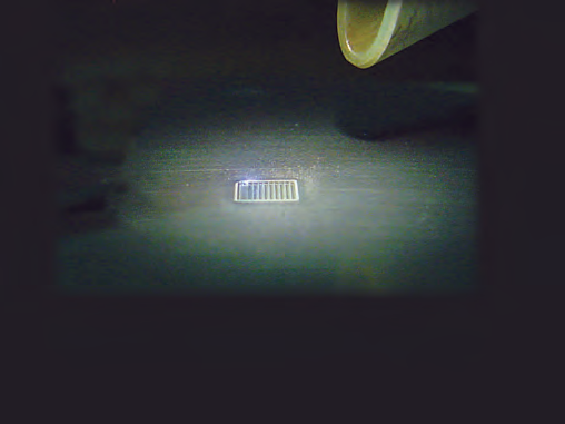

PhotoMachining Inc. is one laser job shop that’s familiar with the challenges of machining FR-4. The Pelham, N.H., manufacturer micro via drills a lot of the material, noted CEO Ronald Schaeffer. “About 90 percent of the composite out there is FR-4 because printed circuit boards are everywhere,” he said, adding that PhotoMachining also cuts CFRP for the aerospace industry.
Because the woven fibers are harder than the host matrix, FR-4 must be cut at an energy level that’s significantly higher than what is needed to ablate the matrix, Schaeffer explained. He added that processing the material is further complicated because of its “special weave,” which results in some workpiece locations having multiple intersecting fibers, single fibers or no fibers.
“In all cases, you have to set the energy density and dwell time of the laser such that you can get through these fiber bundles, which is the most difficult situation,” Schaeffer said. “That means you’re slowing the process down compared to if you were just machining a homogenous matrix, and you may see more heat-affected zone around the areas that don’t have these bundles.”
Micro Matters
PhotoMachining has an array of laser machines and uses a Lumera UV laser with a 12-picosecond pulse and 20w to 100w Q-switched fiber lasers with pulses of 100 nanoseconds and shorter for micromachining composites.
Schaeffer defines micromachining as cutting workpiece materials up to 1mm thick and producing feature sizes 1mm and smaller—usually significantly smaller. Most of the shop’s work is from 10µm to 200µm in feature size and workpiece thickness.
Even so, PhotoMachining often laser machines composites in multiple passes to allow the heat to dissipate between passes, Schaeffer noted. Cutting a feature, such as a hole, in a single pass is quicker but the quality isn’t as high, he added.
To enhance cut cleanliness, PhotoMachining typically laser machines with the smallest possible kerf. “If we squeeze that energy per pulse down into a very small spot, we’ll have a higher peak power intensity, which is the key to clean processing,” Schaeffer said.
If the spot-size diameter doubles, for example, and more energy isn’t put into the beam, the spot’s energy density decreases by a factor of four and not two based on the area of the beam, he added. The spot size on target is typically from 15µm to 50µm for a UV laser and 100µm to 300µm for an infrared laser, such as a fiber one.
As its name implies, Laser Micromachining Ltd., Denbighshire, U.K., also cuts very small parts and features using lasers. “We concentrate on small feature sizes from a few microns to a few hundred microns in materials below 1mm thick,” said Dr. Nadeem Rizvi, managing director. “The thickness is driven by the fact that we have relatively modest powers in the tens of watts for our laser systems because we’re targeting high- precision work. We try to minimize the damage, so therefore we are in the regime of laser ablation.”
Cgctool
EVEN MORE REASONS ...
WHY WE DON’T OUTSOURCE. IS #17 PATENT NUMBERS WEAPONS OF MASS PRODUCTION.
EVEN MORE REASONS ... WHY WE DON’T OUTSOURCE. IS #17 PATENT NUMBERS WEAPONS OF MASS PRODUCTION. Contact Cgctool at 866-888-9600 or visit cgctool.com.
Print page 19
Visit Cgctool View this placement in the issue record
Rizvi noted that the laser job shop primarily machines workpieces made of a single material, but most of the composites it works with are multiple layers of different materials, such as polymers, metals, glass and semiconductor materials, used for sensors and biomedical devices. Because material properties can vary significantly from layer to layer, the shop uses different lasers to machine different layers, with the typical kerf width being from 20µm to 30µm.
Laser Micromachining uses a variety of pulsed lasers, ranging from ultraviolet to infrared and including femtosecond, picosecond and nanosecond ones. Depending on the workpiece material, the company balances various parameters including laser pulse duration, wavelength, energy density and repetition rates. “All the parameters that you’d want to play with,” Rizvi said. “We optimize them for each job.”

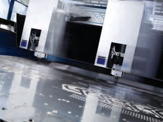

The TruLaser 7040 fiber laser machine from Trumpf includes a carbon-fiber crossbeam that the machine’s two laser cutting heads attach to, permitting accelerations up to 25 m/sec.2 and a maximum simultaneous axis speed of 304 m/min.
Transferring composite technology from outer space to Earth
Fiber-reinforced composite materials are not only being cut with laser machine tools. Machine design engineers are also making laser machine components out of them.
That’s the case at Trumpf GmbH & Co. KG, Ditzingen, Germany, which has incorporated a carbon-fiber composite crossbeam into its TruLaser 7040 fiber laser machine. The solid-state machine, which is also available with a CO2 laser, is for high-volume production, particularly for parts made of thin sheet metal.
The composite moving unit replaced one constructed of welded steel plates, according to Andreas Hultsch, director of engineering, 2-D laser machines at Trumpf’s Neukirch, Germany, site. “The stiffness of the moving unit has been doubled,” he said.
The machine’s two laser cutting heads are attached to the composite crossbar for a combined weight of 620 kg. The lightweight yet rigid construction permits accelerations up to 25 m/sec.2 and maximum simultaneous axis speed of 304 m/min., according to the company. “The goal is always to have the fastest possible processing to achieve short lead times,” Hultsch said. He added that the design also enables the moving unit to quickly change directions.
Trumpf’s use of the composite material was a result of the European Space Agency’s Technology Transfer Program connecting the machine tool builder with Schütze GmbH & Co. KG, Braunschweig, Germany, which designed carbon-fiber rods for ESA’s Rosetta spacecraft for probing comets. The rods are reportedly six times lighter than steel but up to 50 percent stiffer. While the aerospace industry focuses on using composites to reduce weight, machine engineers desire the material more for its high stiffness and ability to avoid exciting a machine’s chatter-inducing natural frequencies, according to Hultsch.
He noted that the crossbeam’s internal structure is made of glued “sandwich” panels with an aluminum honeycomb and carbon-fiber layers, and the material properties can be altered to satisfy load requirements by varying the fiber type, content and orientation.
Because of the benefits carbon-fiber composites provide in the TruLaser 7040 fiber laser machine, Hultsch noted that the usage of other carbon-fiber components is being studied. “The importance of carbon fibers used in engineering, especially for the machine tool industry, will increase in the future.”
