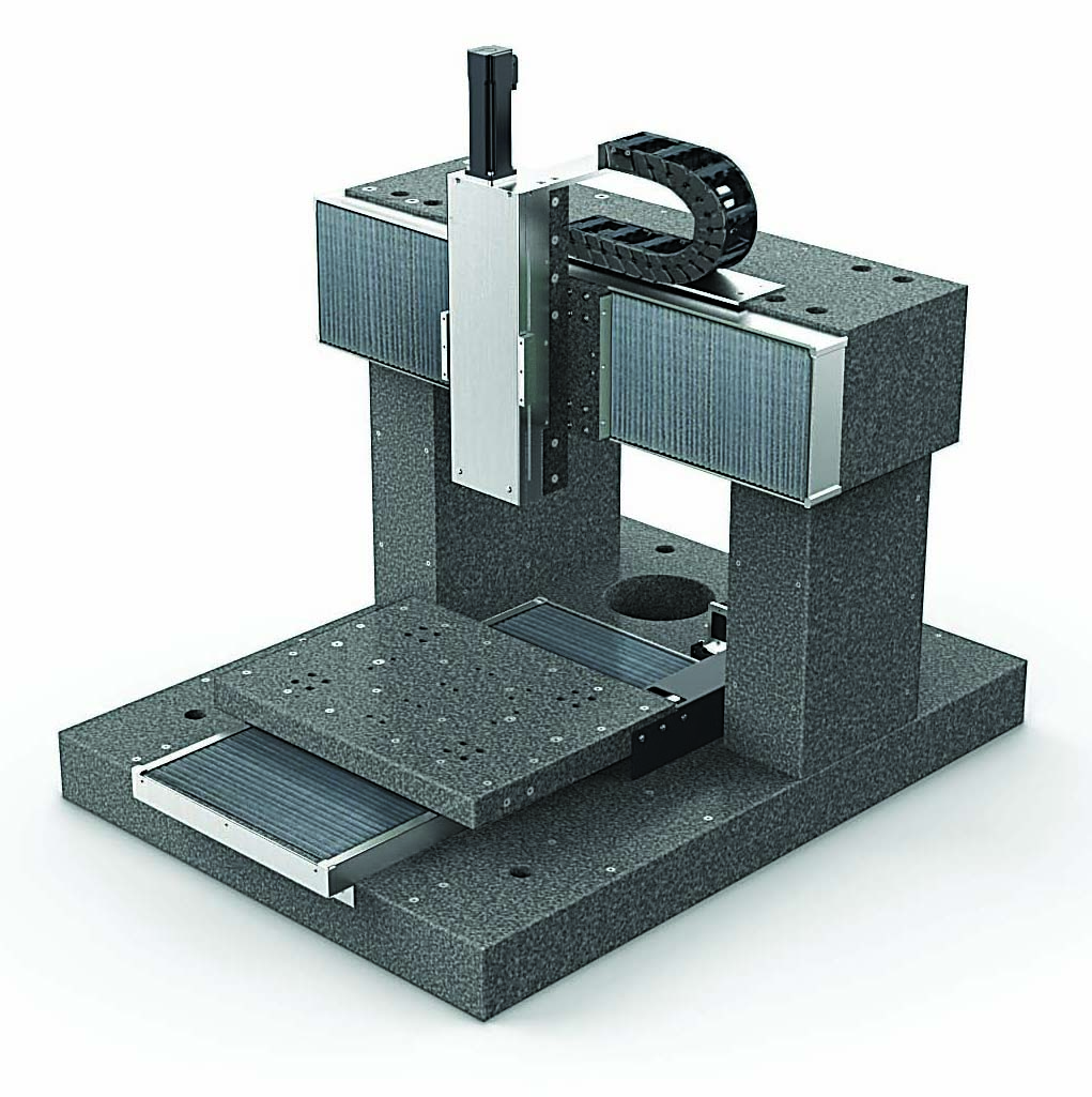

Perks of fiber lasers
The use of a granite-based motion module ensures dimensional accuracy and repeatability with the ExactCut system. Image courtesy of Coherent
PhotoMachining uses a Lumera UV laser with a 12-picosecond pulse and 20-W to 100-W Q-switched fiber lasers with pulses of 100 nanoseconds and shorter for micromachining composites. Even so, PhotoMachining often laser-machines composites in multiple passes to allow heat to dissipate between them, Schaeffer said. He said cutting a feature, such as a hole, in a single pass is quicker, but the quality isn’t as high.

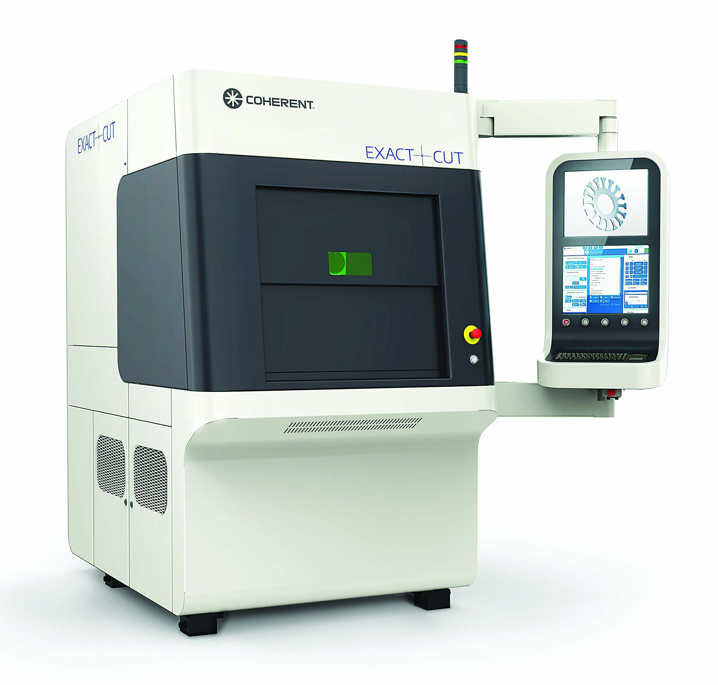

Ready for Industry 4.0 and the industrial internet of things, the ExactCut is a fully self-contained laser cutting system for medical devices. Image courtesy Coherent
“For example, (quasi-continuous wave) 1µ (0.00004″) lasers are versatile and can cut both metals and many nonmetals,” he said. “There is a specialized laser type for virtually any cutting requirement while the same waterjet can easily switch from paper to metal to rubber. Also, CO2 gas lasers operating at 10 µ wavelength give versatility similar to waterjet, capable of cutting a wide range of metals and nonmetals.”
Laser cutting is faster and more energy efficient than plasma cutting for thin or medium-thickness sheet metal, most commonly steel or aluminum. Laser cutting generally has not been possible for thicker stock, but today’s higher-wattage machines — 7-kW and up — are approaching the capabilities of plasma cutting.
Importantly, fiber laser technology effectively eliminates bend mirrors and the need for beam adjustment and alignment, which improves consistency.
