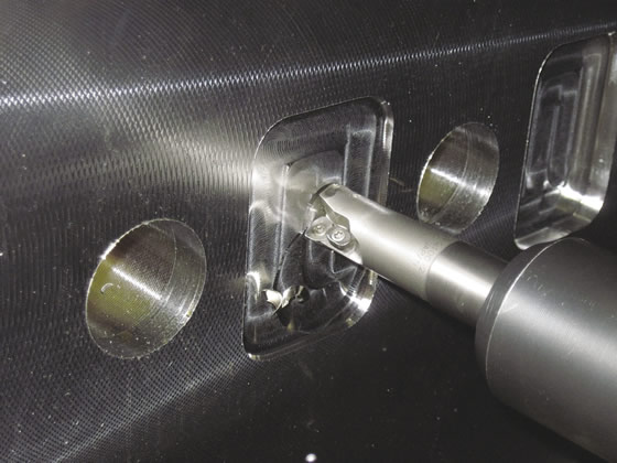

Craftsman Tool & Mold uses this 1 ” high-feed mill for achieving high metal-removal rates when machining mold bases.
These are primarily endmills from Preferred Tooling Supply and other sources, such as Crystallume, Leading Edge and GAR.
Nord continued: “If we can get three times the life out of our endmills, that’s a big advantage for us. We can run up to 20 tools in one electrode milling machine and not have to worry about the accuracy of our cuts being compromised. It may take a number of different tools to run these setups due to the different details on the parts. If we plan for a 60- to 70-hour run over a weekend, tool life becomes critical because we have such a varied array of electrodes to cut [for use in our EDMs].”
Craftsman specializes in large, tight-tolerance, custom mold bases for moldmakers. Its primary concern is quickly removing large volumes of material. Roth purchases cutting tools for the company and is impressed with the advances over the past 4 to 5 years, particularly with high-feed mills and button cutters.
Button cutters are optimal for mold pocketing and die/mold roughing in applications such as Craftsman’s that require aggressive machining. Roth added that while button cutters are not new, recent improvements, such as advanced coatings, allow the tools to cut more effectively and hold tighter tolerances at higher speeds. These coatings also help extend tool life when cutting hardened steel and milling electrodes, which has enabled more lights-out machining.
“We’re comfortable with lights-out machining because insert wear is predictable. Knowing we can get 8 hours of run time out of the inserts as we walk out the door at night is really helpful,” Roth added.

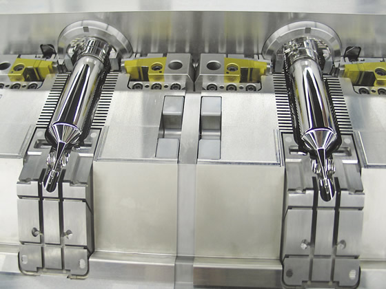

Courtesy of Tech Mold
This mold, made by Tech Mold, is used to produce a housing that is part of a medical device that inflates stents.

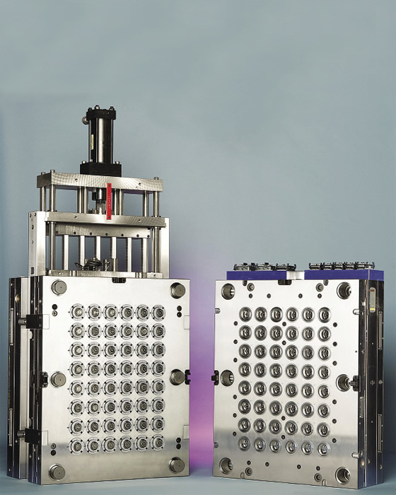

Tech Mold made this multicavity mold, which is used to produce threaded, tamper-evident pharmaceutical container closures.

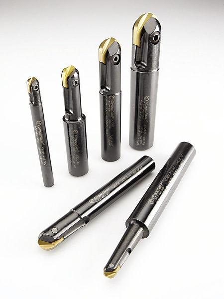

Cutting tools have improved largely because of new coatings developed to reduce wear and increase tool life, according to the moldmakers interviewed. Submicrograin carbide grades also contribute to cutting longevity and greater accuracy, offer higher productivity and reduce secondary operations. For example, many cutting tools impart a fine surface finish that can eliminate the need to burn electrodes for core/cavity EDMing in the mold, even for fine details.
Industrial Molds’ Nord noted he applies 0.025 “- to 0.125 “-dia. endmills with a light diamond coating because they’re not as brittle as other tools. Also, tool life can be improved with a well-balanced toolholder, particularly in high-speed machining operations.

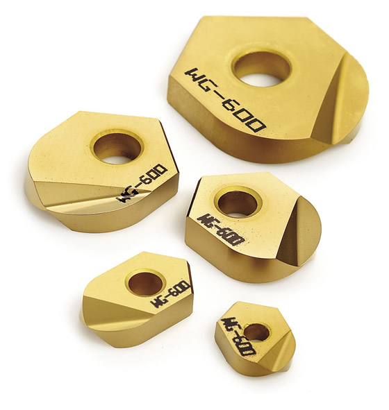

Courtesy of Greenleaf
Ballnose endmills and ceramic inserts, such as these from Greenleaf Corp., Saegertown, Pa., are used to machine the hardened steel used in plastic-injection molds. Below: WG-600 coated whiskered ceramic inserts.
