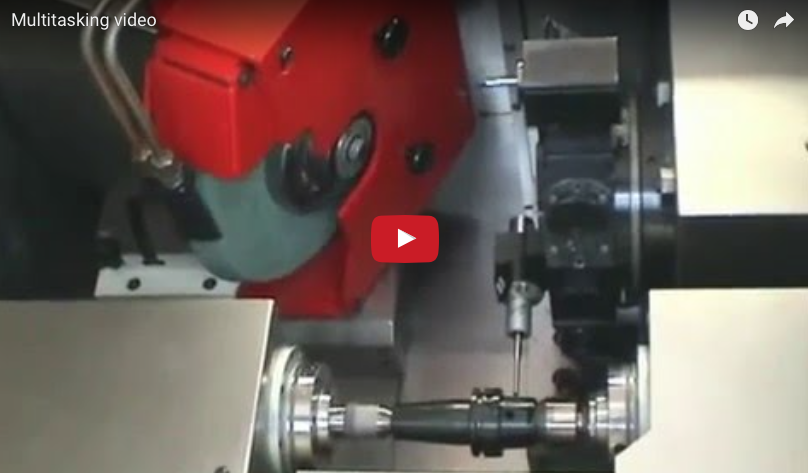

View a video courtesy of United Grinding Technologies. A Studer brand S242 machine, which combines hard milling and grinding, is shown hard milling a toolholder without coolant, then grinding the holder’s taper with coolant to achieve the required surface finish.
