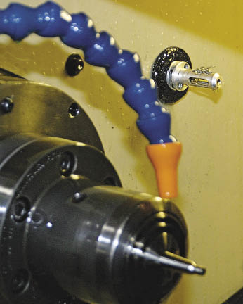

Within the closed environment of a machine tool, a single injection nozzle is typically all that’s needed to suppress almost any fire. In this photo, the red anodizing is eroded from the sensor guard after 3 years of exposure to coolant, but this has no effect on the system’s performance.
Halon is effective when dispersed at a sufficient distribution rate and when the distribution nozzles are properly located. The gasoline fire’s flame front, as noted previously, is moving at a bit more than 10 ft./sec. A Halon volume of 3 to 4 percent in air is all that’s required to put out the fire; the Halon doesn’t have to “bury” the fire to reduce the oxygen concentration, like carbon-dioxide systems do. Nor does it need to cool the entire flame and surroundings like water agents. Once the Halon reaction stops flame propagation, the Halon is free to react over and over again to suppress the remainder of the fire—hence the low concentration needed.

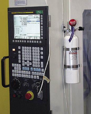

A system’s bottle can be easily modified for mounting in any position, such as this Safecraft AT5AHH push-knob system. Removing the flagged safety pin arms the system. A safety pin attached to the blue flag prevents discharge if a user accidentally pushes the knob. The user must remove the pin to arm the device and then push the knob. There is no danger to personnel from thrust or from inhaling the chemical agent. The system is always thermally armed: When the sensor detects a temperature of 175° F, it will discharge.
