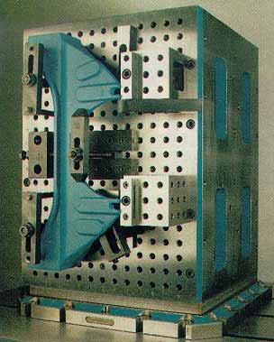

The foundation of any modular system consists of the base plates, columns, and angles, with their grids of slots or holes in their faces. This grid determines the location of the system’s components, which attach to the base. The grid pattern is machined to close tolerances to ensure the repeatability of the setups. This base plate attaches to the machine table, pallet, column, or angle.
Modular fixturing systems also include precision and nonprecision positioners, locators, and manual and hydraulic clamps (Figure 1). System manufacturers try to provide a wide array of components so that users can fixture nearly all workpieces with off-the-shelf parts. On occasion, it may be necessary to modify a modular system component or create a custom component to fit a workpiece. But users will receive a much faster payback on their modular-system investment if they can fixture all their workpieces with standard reusable components.
Although components within a system are standardized, there is no industry-wide standardization of modular-fixturing elements. With few exceptions, parts manufactured for one system cannot be used with another system. Despite these differences, the basic concept behind these systems is the same. System components are attached to the base plate with connectors designed to fit into the base plate’s T-slots or dowel-pin holes. The base plates of a T-slot system are crisscrossed with a series of evenly spaced slots. Components have T-nuts and studs that fit into these slots. Once a component has been slid into the correct position, the user tightens the nut to hold it in place.
With a T-slot system, the user enjoys a great degree of flexibility and adjustability, because components can be located anywhere along any of the slots in the grid. However, a T-slot system may not be the best choice for users whose part-run schedule requires them to rebuild fixtures that have been dismantled. Because the slots do not provide repeatable locations for system components or offer easily identified reference points, the original positions of the components must be precisely measured and extensively documented through prints, diagrams, photographs, and bills of materials. To accurately recreate the fixture as it was documented, the user must gage the position of each component once again as he installs it.
The Flexibility of Modular Fixturing
Figure 1:A typical modular fixturing system includes a wide array of components to meet the fixturing requirements of nearly any application.
For fixtures that must be dismantled and rebuilt repeatedly, a dowel-pin system is preferable. Instead of slots, the base plates in a dowel-pin system are machined with rows of alternating dowel-pin and tapped holes. The dowel holes are used to locate components on the base plate. The components are fastened to the plates with fasteners screwed into the tapped holes (Figure 2).
The dowel-pin system is nearly as flexible as the T-slot system. And for users who must rebuild dismantled fixtures, the system offers a more accurate and easily repeatable way to locate components. The regularly spaced grid of holes provides the user with fixed reference points. A component installed in the same hole it was in before will always be in the same location. To document the position of a component, the user simply identifies the hole or holes into which it was installed. An alphanumeric labeling system engraved on the base plates makes this documentation even simpler. Each hole is identified with a letter/number combination that designates which horizontal row and vertical column it is in. The documentation typically includes the part number or a description of each component used and the alphanumeric location of any dowel pins or fasteners used to install it. This information might be supplemented with photographs or videos to show how components fit together or how the workpiece fits into the fixture.

Figure 2: A grid of precisely spaced holes is used to locate and attach the components of a dowel-pin modular fixturing system. The alphanumeric labels for the holes can be seen etched into the left edge and bottom of the column’s face.
