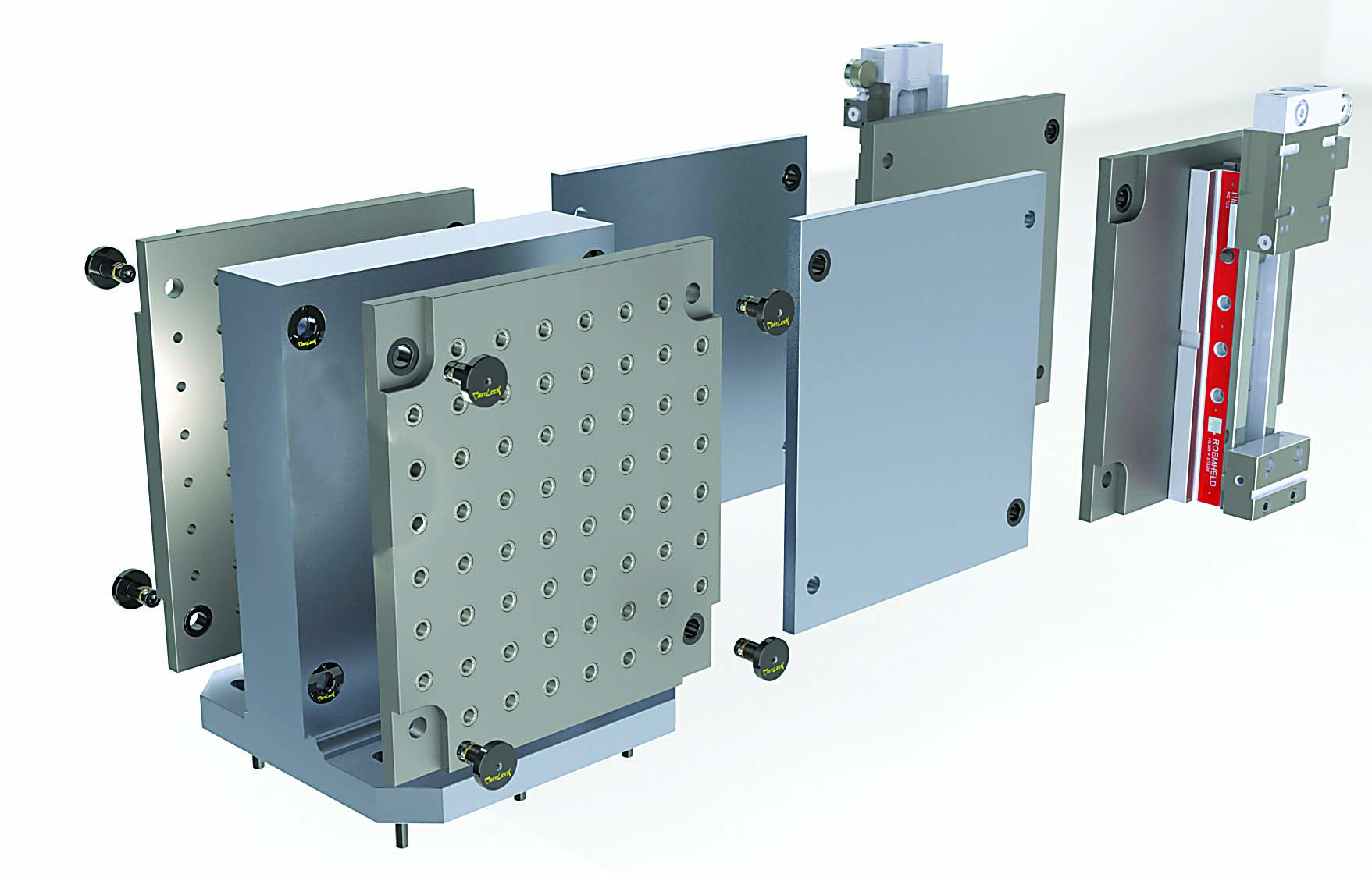

Those components include subplates and tombstones with a standardized grid pattern for holding an interchangeable assembly of fixtures, vises and accessories, such as blank tooling plates, angle plates, parallels and workpiece-setup components (for example, locators, utility blocks and clamps). Adapter plates that can be used to convert third-party vises, rotary tables, chucks or other devices into modular accessories are also often needed.

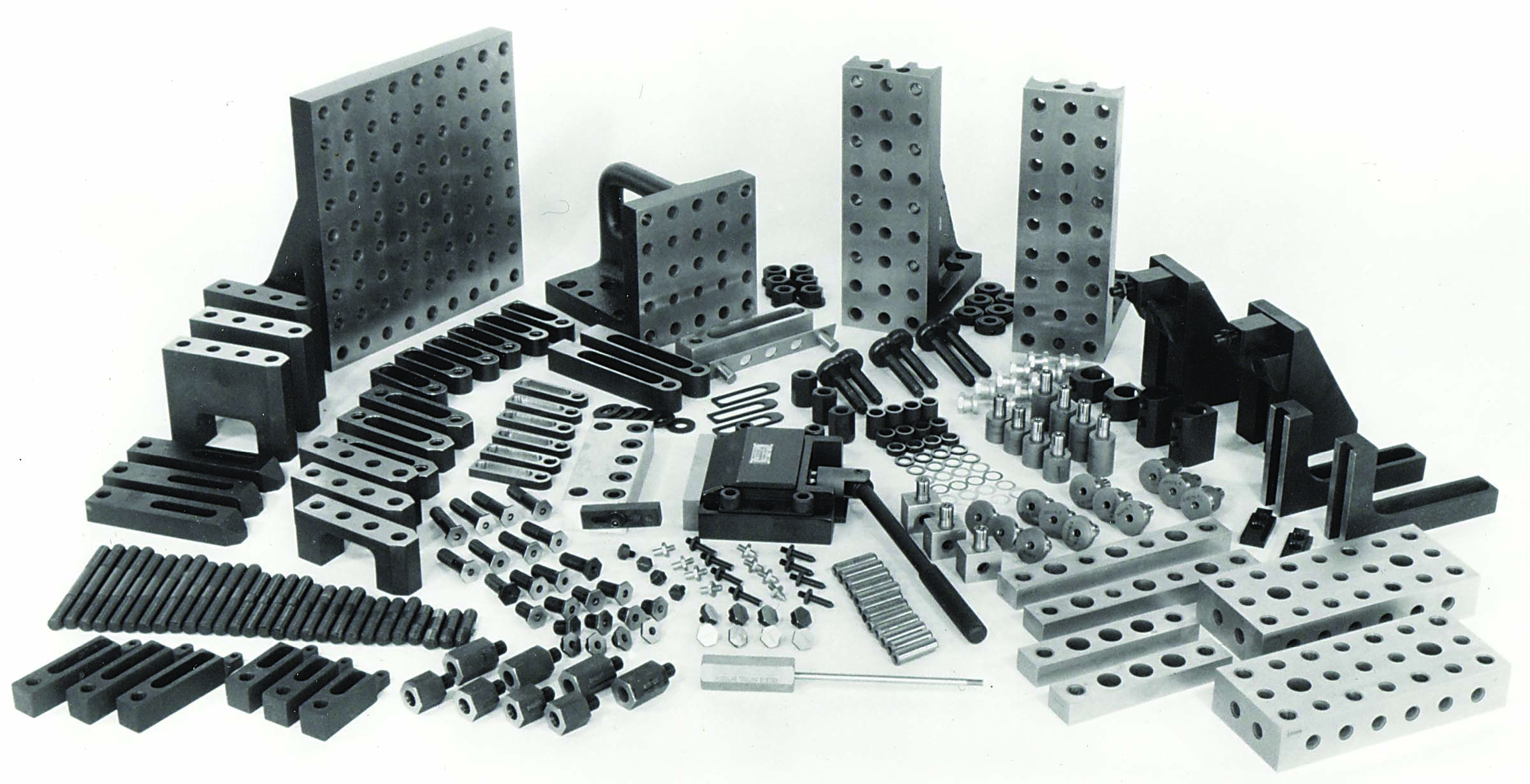

Example of a Stevens Engineering modular-fixturing kit. Image courtesy of Stevens Engineering.
But it’s not that simple, according to Gordon Coope, president of Stevens Engineering Inc., Phoenix, which has specialized in modular fixturing for more than 35 years. Problems arise when the best fixturing option for a new job won’t work with the modular components from earlier jobs—an occurrence more likely when more than one modular fixturing company is involved.
“Workholding has evolved into a multiplicity of seemingly incompatible products,” he said. “Companies that purchased a product can find themselves stuck.”

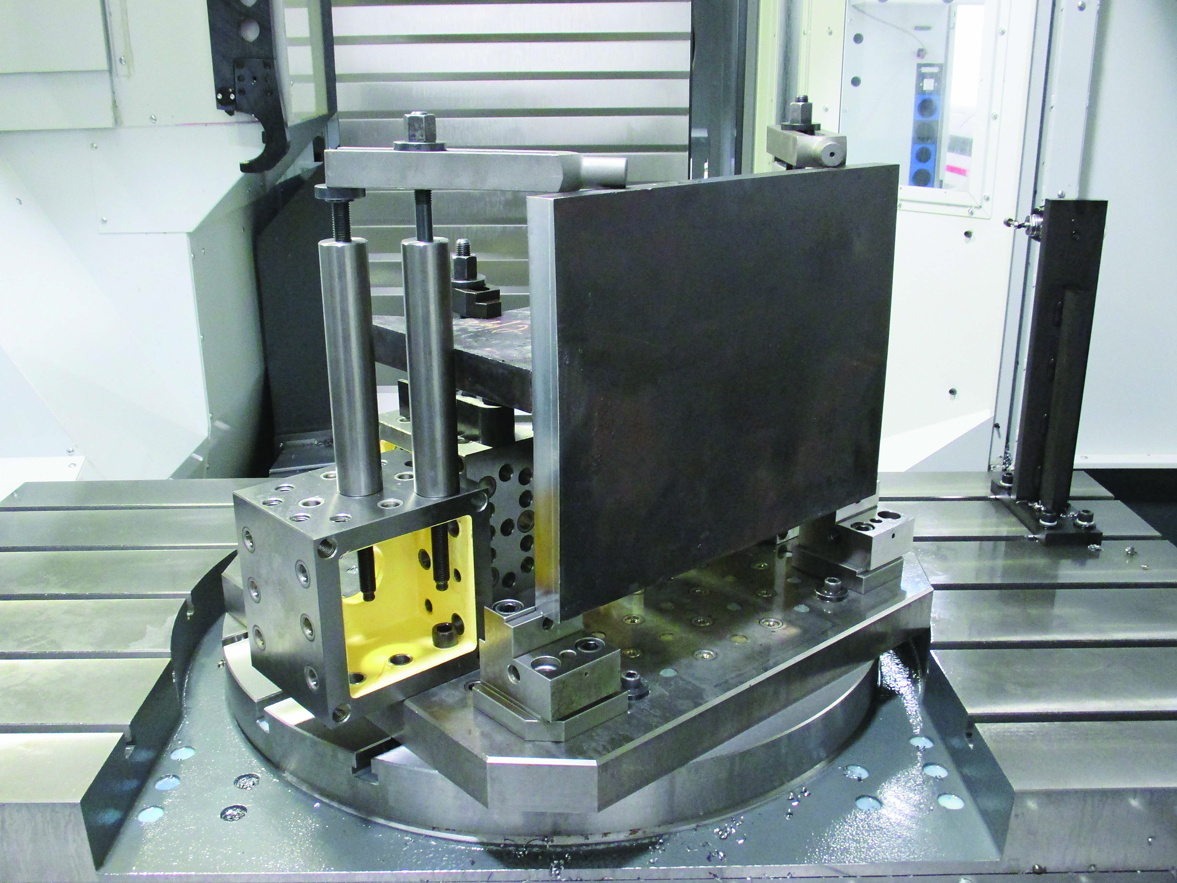

Brian Dodsworth, director of sales at Bluco Corp., Aurora, Ill., emphasized that a job shop that acquires its modular-fixturing components in a job-by-job, piecemeal fashion is headed for unnecessary complications. The best solution, when possible, is for the shop to think of modular workholding not as a collection of components but as a complete system—and that a good time to acquire one is when a machining center is purchased.
Bluco modular-fixturing setup on a horizontal machining center. Image courtesy of Bluco.
This leads back to the challenge of finding a cost justification that is more like a capital investment than the cost of a single job—a challenge made greater after just making a large capital investment in a machining center.
But if it can be done, it helps avoid more costly issues down the road. In short, Dods-worth said, if a shop starts with a genuinely comprehensive system, it won’t have compatibility issues.
“When you design your machining center from the ground up so that you have removable plates, you can swap a Bluco tooling plate off and put in a plate with, say, a Kurt vise when that makes sense. You’re not locked in,” he said.

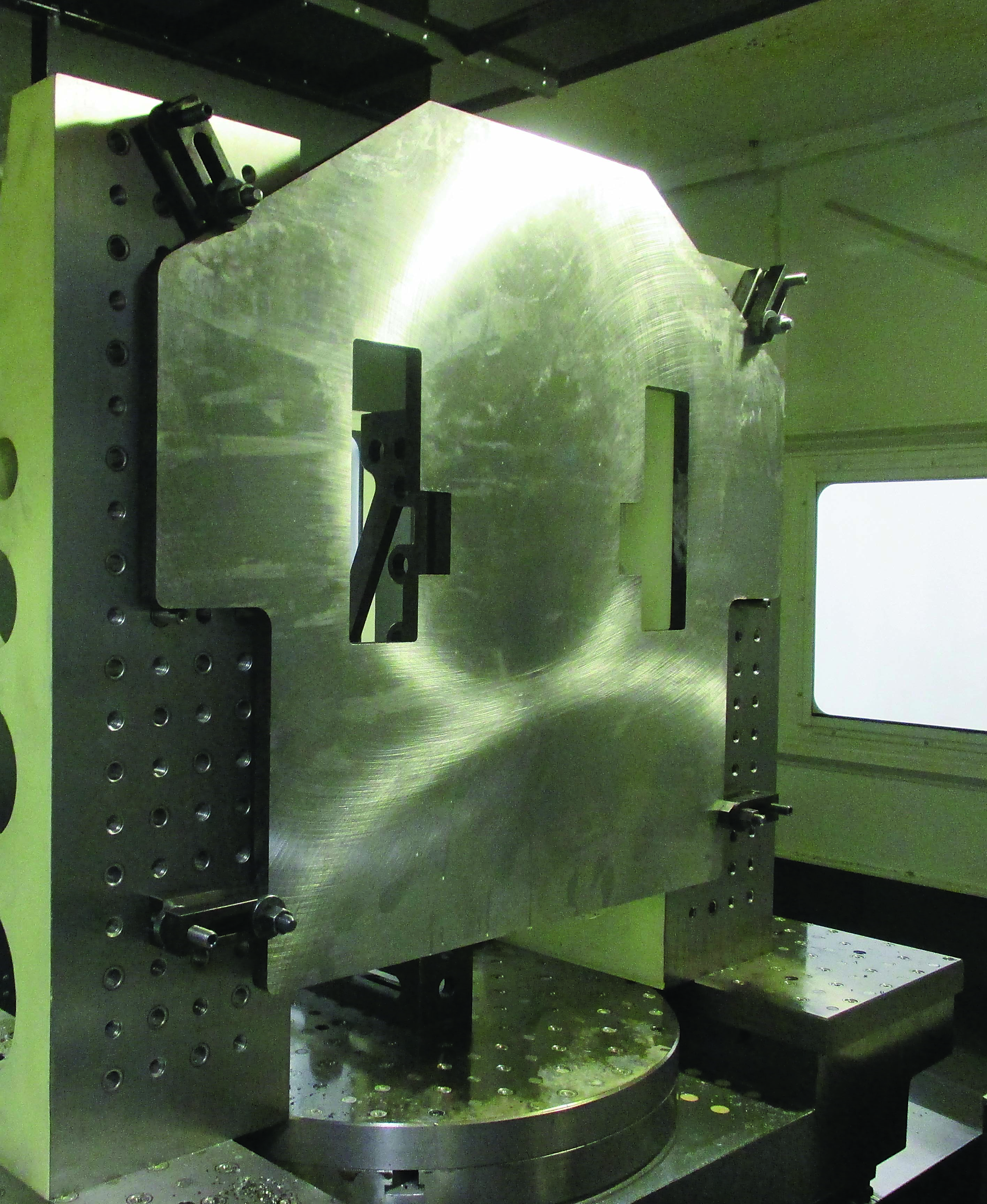

There’s another mind-set found at some customers that Dodsworth is trying to change. “The common method of workholding setup is that the machine stops, you open the doors, you tear down your fixture and set up your next fixture—all done in the machine, with the doors open and the machine idle,” he said. That might be OK for long production runs, but for low-volume, high-mix shops, it’s a throughput killer.
When the doors are open because the machinist is setting up fixtures, the spindle is idle, hurting productivity. “When those doors are open, you’re not making chips, [and therefore] you’re not making money,” Dodsworth said.
Better to set up offline. “With our system, the fixturing is all on a tooling plate, so all you have to do when you open doors is swap out tooling plates,” he said. “Your next fixture has already been set up on a tooling plate out- side the machine, offline, while the spindle was still spinning on the previous job.” So when the door opens, the machinist disconnects the tooling plate from the machine, pulls it out, loads the next one, closes the door and hits the button, and the machine is running again. “You’re really keeping to a bare minimum the amount of time those doors are open and [the machine is] not producing.”
