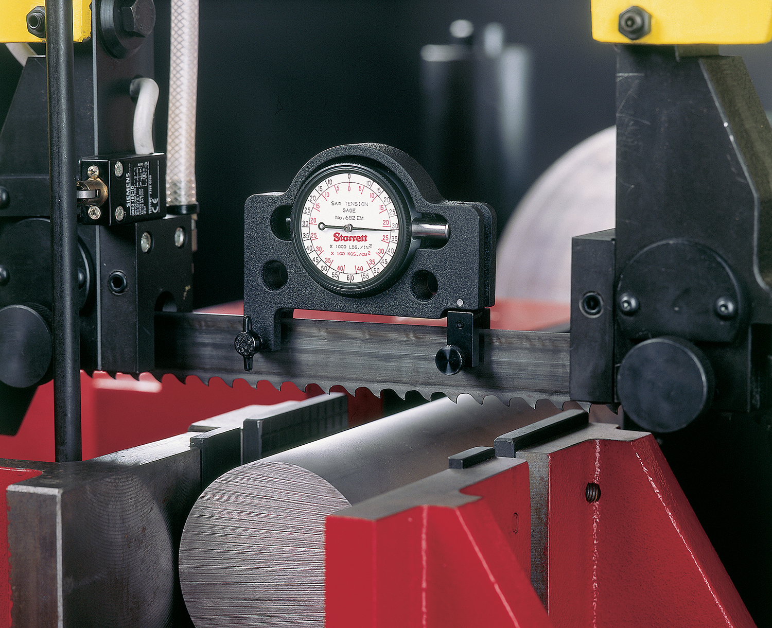

  • Tension blades correctly. Having a blade too tight or too loose will cause damage and can be dangerous. Purchase a blade tensioning gauge and check the tension occasionally. Yes, blade manufacturers will give you the proper specifications.

Starrett Saw Tension GageStarrett Saw Tension Gage. Image courtesy of Starrett”>

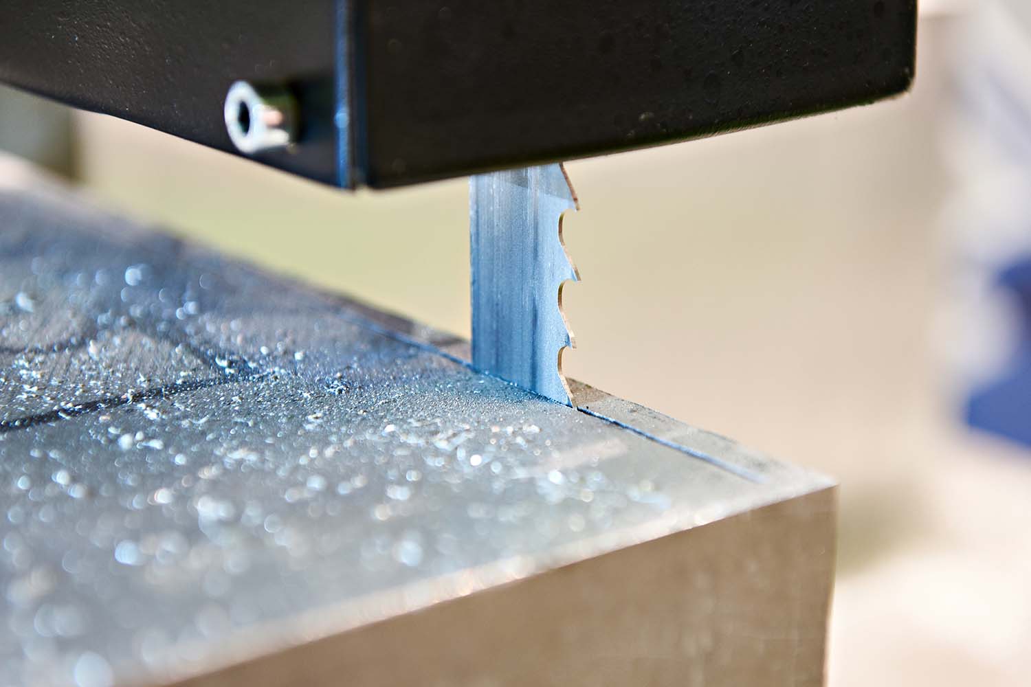

Cutting fluid considerations
Cutting fluid, a.k.a. coolants and lubricants, is important in band sawing operations because it cools the blade, lubricates the teeth and washes chips away. Without it, a blade would likely overheat, wearing out the teeth faster with chips filling the blade gullets, which leads to blade stress, tooth breakage and inferior cuts.
A rich cutting fluid solution does a better job coating and lubricating the blade throughout the entire cut. Coolant should wash over the blade as it enters and exits the cut, recirculating throughout the cutting process. Water will evaporate from the mixed solution, so replace it as needed. Also, keep an eye out for chips that fly into the machine and block coolant flow, as well as system leaks — all which can cause problems.

Establish the right tension
Tension should be set to the machine manufacturer’s recommendations, and a blade tension gauge should always be used to check it. Most production machines require between 28,000 psi and 32,000 psi of blade tension. Low blade tension allows the blade to “walk,” bowing the blade as it travels between the guide arms, which may cause cracking in the back of the blade. Without adequate and proper blade tension, the beam strength will be insufficient to hold the blade straight, resulting in crooked cuts.
