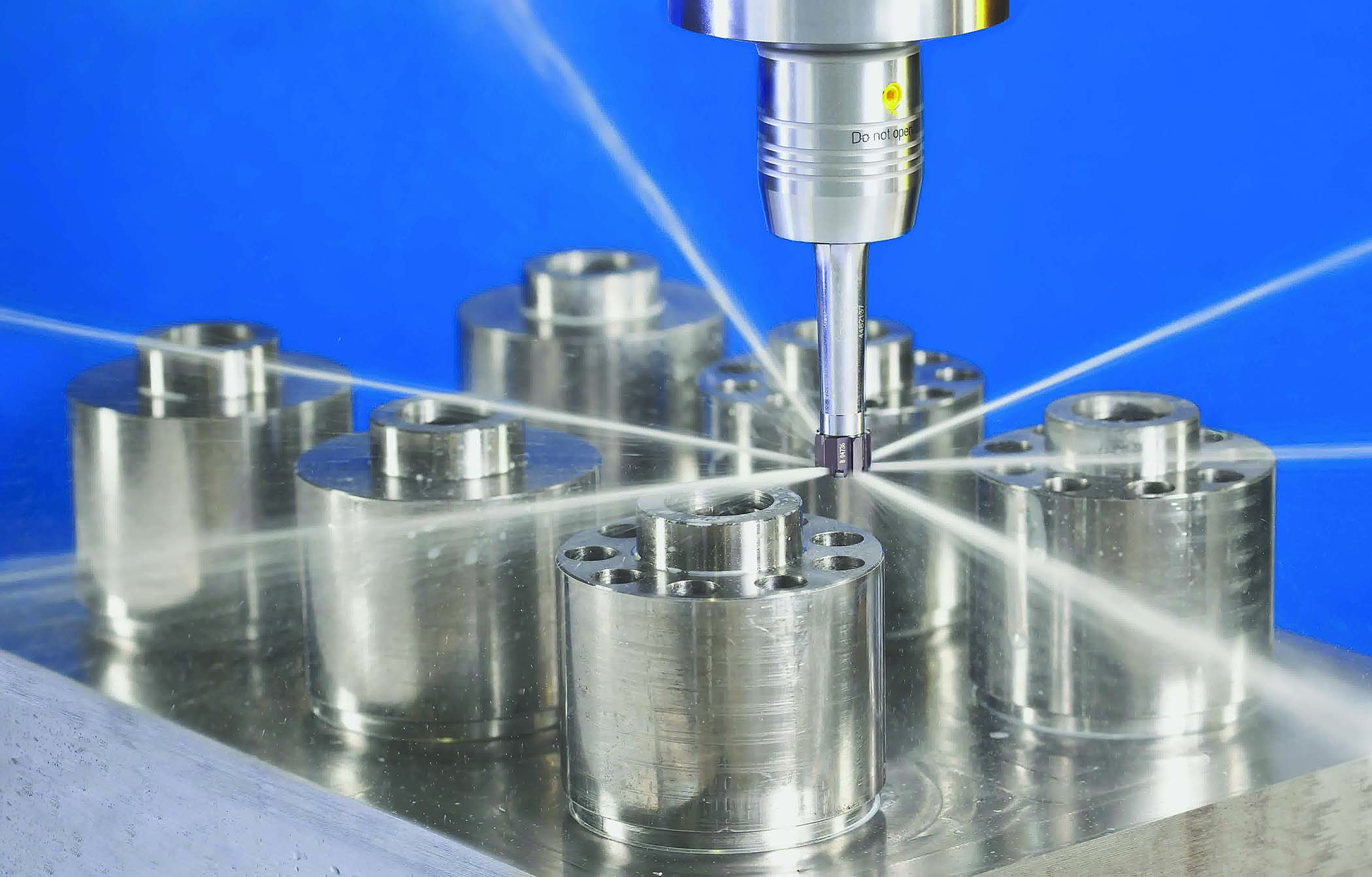

Another adjustable offering from Iscar is its Bayo T-Ream high-speed reaming system. He explained that Bayo T-Ream features three adjustment screws that can be tightened in turn to move the reamer enough to eliminate runout.
“It’s a simple solution and very cost-effective as opposed to buying a specific adjustable holder like Finefit,” Cline said.
Users of the Bayo T-Ream system can eliminate runout using adjustment rings that fit onto the body of the reamer.
Users of the Bayo T-Ream system can eliminate runout using adjustment rings that fit onto the body of the reamer. Image courtesy of Iscar

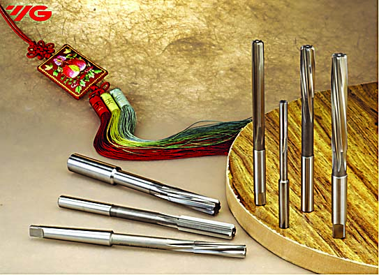

Reamers offer much higher penetration rates than single-point boring bars.
Reamers offer much higher penetration rates than single-point boring bars. Image courtesy of YG-1 Tool (USA)

Cline also pointed out that “coolant-through” options like Bayo T-Ream extend tool life by delivering coolant right to the cutting edges. In addition, he said, these options allow reaming at much higher feed rates and are better when it comes to evacuating chips. The latter, he said, translates into better surface finishes because chips aren’t staying around to rub against part surfaces.

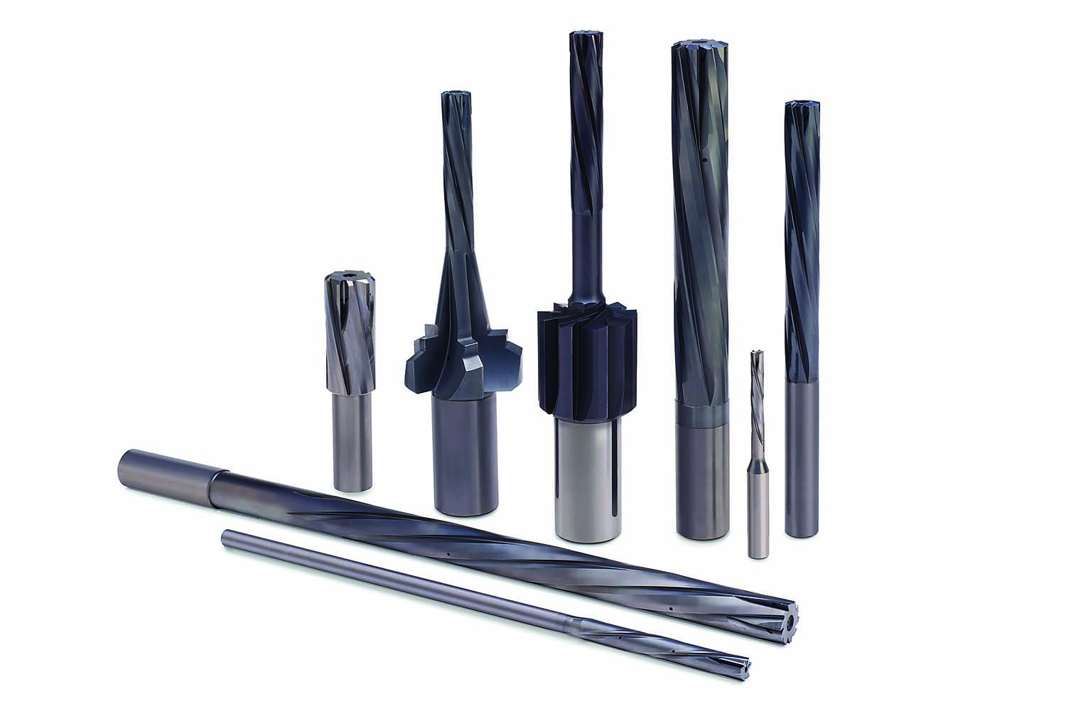

SRT reamers have both straight and helical flutes.
SRT reamers have both straight and helical flutes. Image courtesy of Star
Of course, there’s a limit to how many cutting teeth can be added to a reamer of a certain diameter.
“If it’s a 1″ diameter, we can get all kinds of cutting blades in there,” Dunneback said. “But if it’s 0.25″, you’re probably only going to get four blades in there.”
One way of getting better surface finish from a reamer of any diameter is to opt for helical flutes. He said they provide more cutting surface area than straight flutes, which produces more burnishing action. As an added benefit, helical flutes help with chip evacuation, he noted.
