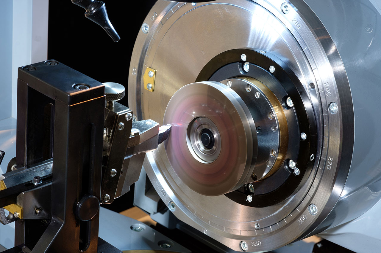

A cutting tool is ground on a Coborn RG9A grinding machine. Image courtesy of Coborn Engineering
