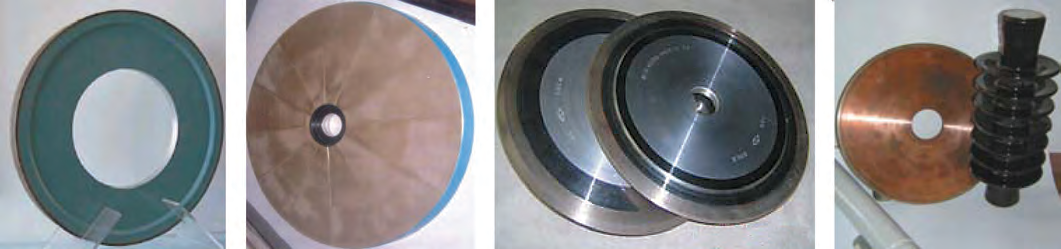

Figure 1: The V.N. Bakul Institute for Superhard Materials of the National Academy of Sciences of Ukraine developed a technology for fabricating large diamond wheels with (from left to right) 1A1, 6A2-SS, 1EE1 and 1A1R shapes. The 6A2-SS diamond grinding wheels, which each weigh 30 kg (66 lbs.), were developed for the first time.

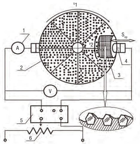

Figure 2: Truing via EDM of the 6A2-SS diamond-abrasive wheel. 1) Appartus to control electric current and voltage. 2) Diamond-abrasive wheel with the 6A2-SS shape. 3) Truing tool. 4) Current collector. 5) Rectifier. 6) Autotransformer. Snp) Reciprocal movement of the truing tool. V1) Rotational speed of the grinding wheel. V2) Rotational speed of the truing tool.

The V.N. Bakul Institute for Superhard Materials of the National Academy of Sciences of Ukraine has developed a technology for fabricating large diamond wheels with the new 6A2-SS shape and existing 1A1R, 1EE1 and 1A1 shapes from 250mm to 600mm (10 ” to 24 “) in diameter (Figure 1). The cutting area of the diamond layer for these tools is up to 5,000 cm2 (775 cu. in.).

It was determined that deviation of the cutting surface of a diamond wheel after being EDMed did not exceed 20μm to 50μm (790 to 1,970 μin.), while the required protrusion of diamond grains from the tool binder is achievable. Flexible steel rods measuring 0.12mm (0.005 “) in diameter were used as truing tool electrodes. The truing process creates fine-dispersed relief, containing reinforced miniature posts for the diamond grains in a wheel.

The process of truing via EDM with flexible metallic electrodes provides high productivity when truing a wheel with the required geometry for the working surface. The truing process takes 3 to 10 minutes, depending on wheel dimensions. The average height of the grains’ protrusion above the tool binder is 10μm to 15μm (390 to 590 μin.).
