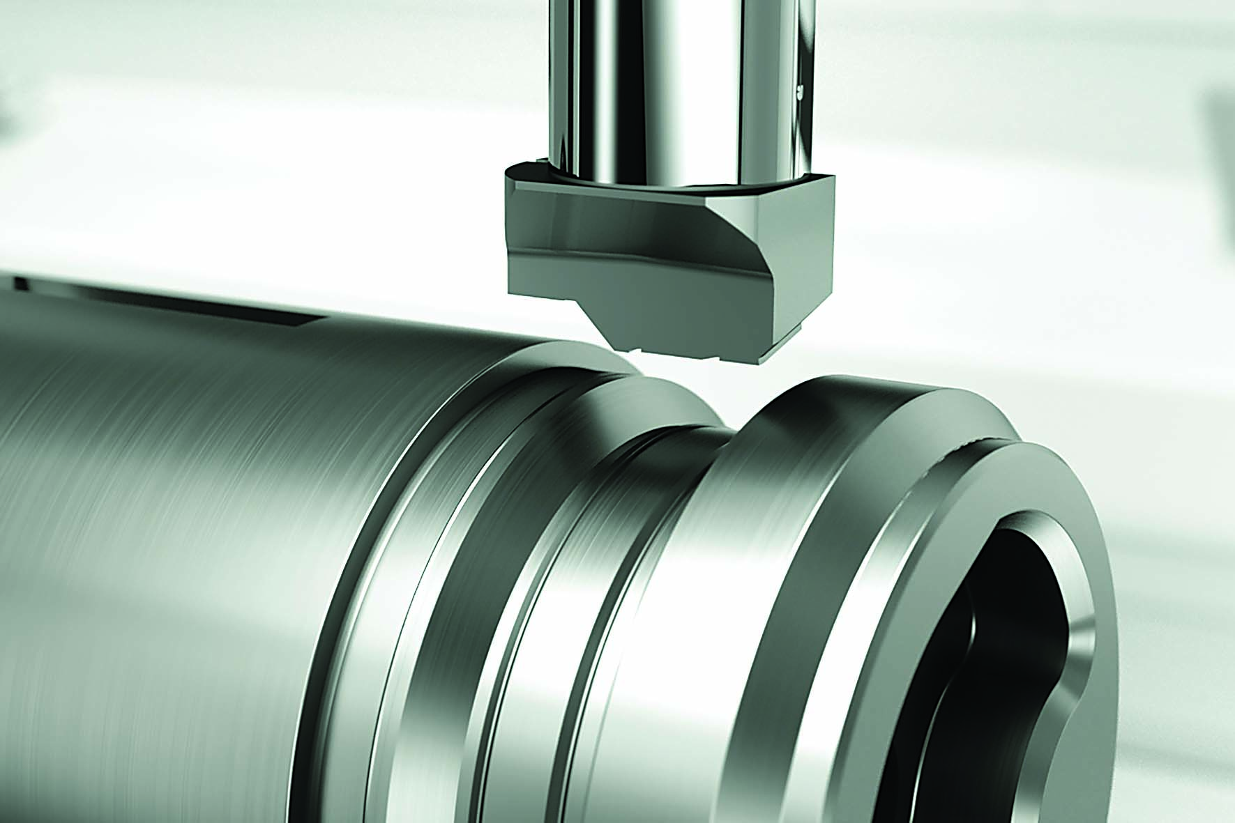

Grooving hardened steel parts with PCBN cutting tools.
Courtesy of Sumitomo Electric Carbide
Over the past decade, finish grooving hardened steel parts using polycrystalline cubic boron nitride inserts has increasingly replaced grinding. "Typically, grinding is a more stable process that provides more accurate tolerances than grooving," said Tyler Economan, proposal engineering manager for INDEX Corp., Noblesville, Ind. "However, people are trying to do more complete machining on workpieces if the turning machine is capable of completing the necessary processes."
Various work materials that are through-hardened include HSS, die steels, bearing steels and alloy steels. Only ferrous metals are casehardened and that process is typically reserved for low-carbon steel. Casehardening produces a hard, wear-resistant exterior over a tough core. Parts made from hardened steels include arbors, axles, link components, driving pinions, camshafts, gears, bushings, transmission shafts and bearings.
"Hard," however, is a moving target. Some consider materials from 40 to 55 HRC to be hard, while, for others, hard is 58 to 60 HRC and harder, which is where PCBN comes in.
For induction-hardened, or casehardened, parts, the outer, hardened surface, can be as much as 1.5mm thick, and up to 58 to 60 HRC, while the undersurface is typically much softer. In situations like this, it is important to ensure the majority of the cut happens below the hardened, outer surface.
