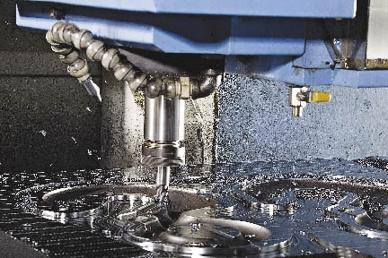

Raising the spindle speed and lowering the DOC actually reduced the chip load despite doubling the feed rate and the volumetric removal rate when SPX applied Ingersoll Power Feed Plus tools.

The first step in die repair is to skin off about ⅜ ” of a die set’s mating surfaces to create enough stock for resinking the cavities—essentially flat facemilling. The previous standard practice was to run a 2¼ “-dia., 4-flute, positive-rake facemill at a 500-rpm spindle speed, a 50-ipm feed rate and a 0.030 ” DOC. Even at this low feed rate, hammering problems often arose, necessitating a lower feed to protect the machine—especially its ceramic spindle bearings.
“Protecting the machine is our No. 1 priority because we don’t have much backup,” said Cory Pleshcourt, SPX die maker.
The retooling began when Pleshcourt asked Ondrej Lubinski, an Ingersoll field engineer, for tooling ideas that would prevent damage to the light-duty machine in this heavy-duty task.
Because the spindle is capable of much higher speeds, Lubinski suggested a smaller 3-flute Power Feed Plus mill from Ingersoll Cutting Tools with submicron- carbide inserts and feeding it faster but shallower. The cutter is positive radially but negative axially. The shop tested the new cutter at various settings, finally settling on twice the previous feed and one third less depth: 1,000 rpm, 100 ipm and a 0.020 ” DOC. Although the machine removed metal about 10 percent faster, the spindle load meter read 15 percent lower and all signs of hammering disappeared. Insert life doubled.
It may seem counterintuitive to switch to a cutter with fewer flutes to deter hammering, because the total work is spread less widely. But in combination with increasing rpm and feed and reducing the DOC, the chip load per tooth decreased, as did the cutting forces transmitted back into the spindle and machine frame.
The negative axial rake makes double-sided inserts possible, providing more edges in an operation where tools wear quickly.
“With lower-power machines running hard parts, reducing the flute count in the cutter reduces friction, conserving scarce horsepower for actual chipmaking,” explained Lubinski.

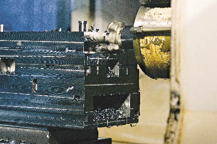

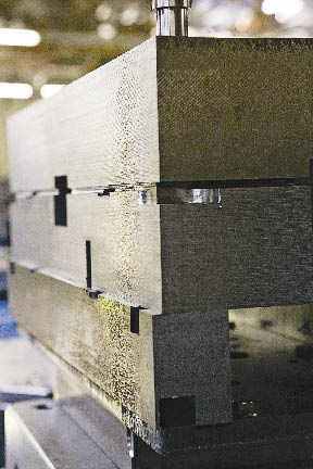

A key part of Precision Mold Base Corp.’s flagship product is a metal sandwich with mild steel or gummy stainless steel as the bread and 4140 steel hardened to 33 to 35 HRC as the filling. PMBC, Tempe, Ariz., has to rough mill the workpiece edge, exposing the cutter to two vastly different metals in the same pass. Worse yet, gaps in the toolpath caused by previous operations leave the tool alternately cutting air and then slamming into the hardest metal. Finally, alignment variations in the sandwich assemblies swing the DOC unpredictably between 0.060 ” and 0.250 “.

“It’s the most punishing job in our place,” said foreman Romney D’Antuono. “We have a shelf littered with wrecked or burnt button cutters to show for it. We call it our ‘morgue.’ “
Previously, PMBC’s process was to rough mill the edges with a five-insert, zero-rake button cutter. The parameters were 25 ipm at 550 rpm and a 0.060 ” DOC, as well as a 3.700 ” radial engagement. It was slow going, with inserts often rupturing mid-cut. With the switch to a positive-rake Ingersoll Form-Master Plus cutter, the operation runs 2½ times faster, with insert edge life extending to at least two shifts—reliably—vs. sometimes failing in the first cut. With the greater edge security, PMBC now runs the operation “lights out.” The new settings are 55 ipm, 440 rpm and a 0.190 ” DOC.
The gain stems largely from the high-positive rake angle, which creates a free-cutting, cleaving action that reduces cutting forces on the tool, workpiece and machine.
The cutter also has two additional inserts, to more widely distribute the cutting loads. The inserts have smooth top faces, with no chipbreakers.
“You can hear the difference,” said D’Antuono. “The old operation caused a lot of pounding and scraping. Now it purrs like a kitten.”
Originally, D’Antuono balked at the Form-Master Plus price tag, about 30 percent higher than the old button cutter, with inserts costing 10 percent more. He figured that to achieve payback, the new cutter would have to run at least 30 percent faster, with inserts lasting 30 percent longer. “Given the gruesome cutting conditions, it simply didn’t seem possible.”
It took a live test to convince him. He and Ingersoll field engineer George O’Gar selected a mold base measuring 18 “×12 “×12 ” with bad alignment between the layers, and set it up on a 35-hp Mazak Ultra 650 horizontal machining center with a 50-taper spindle. They started conservatively at 40 ipm, but even so they were removing metal twice as fast as before. They settled on a 55-ipm feed with a 0.190 ” DOC.
Today that “abusive” operation runs two-and-a-half times faster, inserts last four to five times longer, and catastrophic insert failure has been eliminated. “Now the inserts wear gradually, over a couple of shifts, to a predictable end point,” D’Antuono said. Edge life is so reliable that he can run the operation “lights out” without slowing down more than 10 percent.

Above: Despite “hyper interrupted cuts” and varying alignments and physical properties of the respective metals, the Ingersoll Form Master facemill cuts smoothly through a bimetal workpiece at Precision Mold Base. Throughput is up two-and-a-half times vs. the previous zero-rake button cutter, and cutting edges last four to five times as long.

Left: An irregular edge and two different metals of varying hardness and machinability made the facemilling operation challenging for Precision Mold Base. The outside layers are 836 mild steel or 410 stainless steel and the center is 4120 tool steel, hardened to 32 to 35 HRC.
