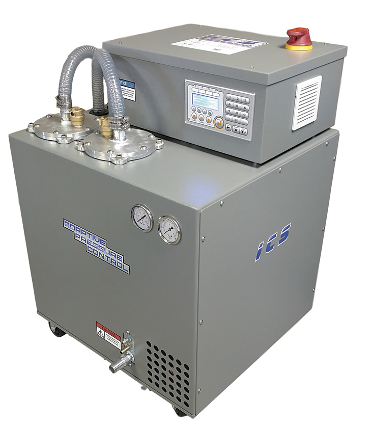

Modern Machining Technology Inc. found that holemaking with standard cobalt drills and flood coolant could achieve the required tolerances when machining two holes in 1018 steel hubs, but the job shop wasn’t able to complete the needed 4,000 holes each month with that arrangement. Each 4″-dia. (101.6mm) hub has a 3⁄8″-dia. (9.525mm) hole on one side and a 3⁄32″-dia. (2.381mm) hole on the other side, and both are about 2¼” (57.15mm) deep.
Scott Countryman, owner of the Wheat Ridge, Colo., shop, explained that each hole took about 40 seconds to produce with a feed rate of 25 ipm (635 mm/min.) and 0.007″ (0.178mm) pecks on a DMG Mori DuraVertical 5100 vertical machining center.

The VariFlow high-pressure coolant system delivers 10 gpm of coolant at up to 1,000 psi.

After Countryman contacted Schley last spring, ICS installed its VariFlow high-pressure coolant system, which delivers 10 gpm of coolant at up to 1,000 psi (69 bar), provides 10µm filtration via a bag filter and has a built-in feeder pump. The latter means an auxiliary pump or strainer is not needed. In addition, the system’s adaptive flow control has a digital human/machine interface, which allows the user to input a set pressure; the VariFlow then dynamically adjusts the speed of the pump so output is at the desired pressure. Essentially, coolant flow is controlled regardless of the orifice size of the tool being applied.
The compact system measures 24″ wide × 31″ deep × 38″ high (609mm × 787mm × 956mm).
With the high-pressure system in place, Modern Machining Technology needed to switch to through-coolant tools and selected carbide Dream Drills from YG-1 Tool Co., Vernon Hills, Ill. While applying the same water-based coolant, the shop achieves a tool life of about 500 holes with the 3⁄8″ drill and about 600 holes with the 3⁄32″ drill, Countryman said. Tool life is determined by monitoring the load meter on the machine tool.
“When we see the load creep up,” he said, “we know the drill is getting a little dull and change it at that point.”
With the high-pressure coolant system, the shop runs the drills at a spindle speed of 10,000 rpm and a feed of about 116 ipm (2,946.4mm/min.) without pecking, producing a hole in about 1 second, Countryman said. On average, the shop operates about 12 hours a day, 6 days a week, he noted, and needs high-pressure coolant to deliver the required quantity of parts. “It just would not have happened the old way.”
