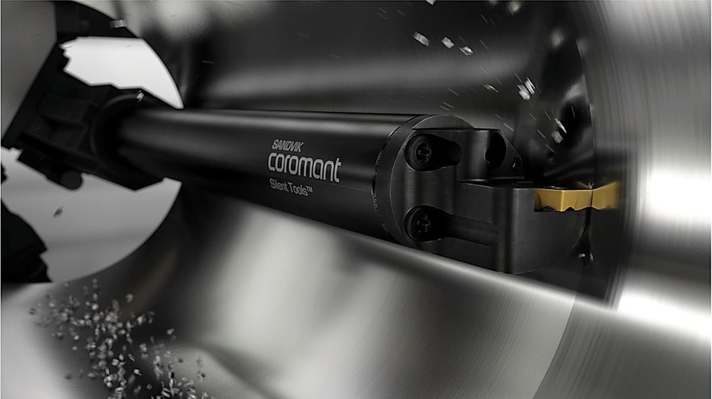

1. Minimize bad vibrations with dampened toolholders.
When it comes to tackling the excessive vibrations from long-overhang machining, anti-vibration tool adaptors can be a game changer for improving productivity. These specialized toolholders are designed with an integrated dampening device inside the tool body to minimize vibrations and increase cutting parameters.
With a dampened solution, shops can achieve a more secure and stable process to reliably meet close tolerances and attain a better surface finish. The stability also allows for much higher metal removal rates. In some cases, shops can reach cutting speeds two to three times faster than a traditional setup for long-overhang applications, dramatically improving cycle times and throughput.
Additionally, by reducing vibration-induced wear, dampened toolholders can extend tool life, lowering costs of tooling and reducing downtime related to tool changes. Although dampened toolholders may come with a higher upfront cost, their ability to improve cycle times, reduce scrap and ultimately lower costs per component make them a worthwhile investment for shops aiming to stay competitive.

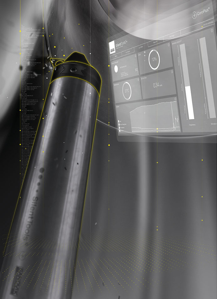

2. Get connected with sensor-enabled solutions.
For shops on the path to digitalization, sensor-enabled solutions can offer a powerful way to take long-overhang machining to the next level. Designed to support more efficient, precise and automated operations, these Industry 4.0 tools bring connectivity and intelligence to dampened turning adapters.
For deep boring applications where the operator cannot see what’s happening inside the component, sensor-integrated turning adaptors are available that can provide real-time data to tell the operator when the tool is in the cut. This connectivity enables automated monitoring of load, vibration, deflection and temperature, allowing operators to catch issues with the machining process early, before it leads to costly mistakes. Meanwhile, features like a center height indicator help streamline setups by helping operators achieve precise tool alignments. With accurate, data- driven decision making, shops can optimize processes, reduce waste and power greater automation in long-overhang applications.
To improve the accuracy and efficiency of turning adaptors that don’t have integrated sensors, shops can also use attachable digital devices for streamlining setups and monitoring the health of dampened tool adaptors. Equipped with a simple magnetic attachment, the device lets operators quickly verify setup accuracy, monitor temperature and test the health of the tool.
Digital solutions like these can help unlock smarter, more reliable machining to support greater productivity for tech-driven shops.
