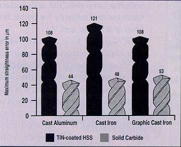

Alignment accuracy (straightness) is the amount the hole wall, as a cylinder, deviates from strict alignment with the nominal axis. Compared to HSS drill/reamers, solid-carbide drills can improve alignment accuracy by as much as 90% with variances as small as 16.6µm (Figure 1).

Figure 1:As this comparison chart shows, holes produced by solid-carbide drills are considerably straighter than those produced by TiN-coated HSS drills.

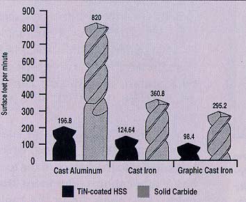

Figure 2:In tests, users were able to drill holes with solid-carbide drills at surface speeds that were faster than the speeds they could use with TiN-coated HSS drills.

A third reason solid-carbide drills offer better surface quality is that they can be run at faster cutting rates (Figure 2). Increasing the cutting speed reduces built-up edge on the tool, which can scratch and abrade the surface of the workpiece. By reducing cutting time, the higher cutting speed generates less heat on the workpiece surface. There is also less wear on the lands and outer corners of the tool, which directly influences the surface quality. At faster cutting rates, the tool “bites” the material better, cuts cleaner, and produces a better surface finish.

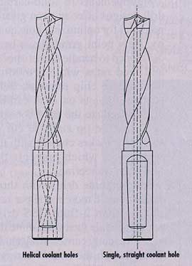

When excessive heat and chips interfere with drilling, solid-carbide tools with through-coolant capabilities may be used to heat buildup at the cutting interface and facilitate chip evacuation. A new drill design has internal coolant ducts following the helix angle of the flutes instead of going down the center of the web (Figure 3). Helical coolat ducts increase coolant volume through the tool, provide greater web strength and rigidity, and allow for more regrinds. Theoretically, solid-carbide drills with helical coolant holes can be resharpened down the entire length of the flute, and the coolant holes will not change position.
Hole in One
Figure 3:Helical coolant holes allow the drill on the left to be sharpened repeatedly. A drill like the tool on the right, with a single coolant hole running the length of its web and splitting only the end, can be resharpened only until the central coolant hole becomes exposed.
