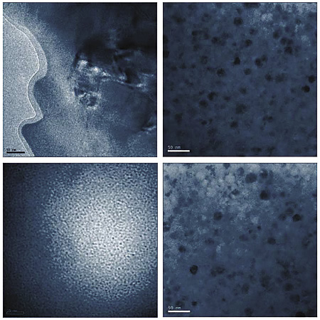

Transmission electron microscopy images show different levels of crystallinity embedded in the amorphous matrix of the SAM2X5-630 steel alloy. Image courtesy Jacobs School of Engineering, UC San Diego.

Researchers are increasingly looking to amorphous steel as a source of new materials that are affordable to manufacture and incredibly hard, yet resilient. SAM2X5-630 has the highest recorded elastic limit for any steel alloy, according to the researchers. The alloy can withstand pressure and stress of up to 12.5 gigapascals, or about 125,000 atmospheres, without suffering permanent deformation.

The process created small crystalline regions only a few nanometers across, with hints of structure, which researchers believe are key to the material’s ability to withstand stress. This shows that the properties of these types of metallic glasses can be fine-tuned to overcome shortcomings such as brittleness, which have prevented them from becoming commercially applicable on a large scale, Eliasson said.
