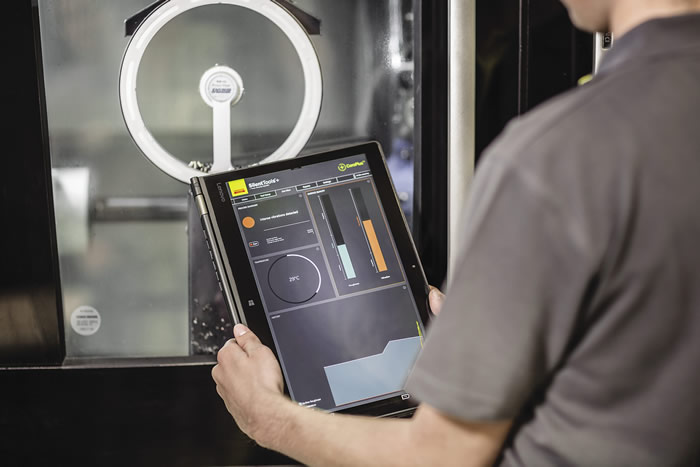

Toolmaker Sandvik Coromant Co.’s CoroPlus platform is slightly different from many in that its offers not only digital thread-ready devices, but also a version of the thread itself.
CoroPlus is the umbrella name of a new platform of connected tools and software made to improve productivity and control costs through a combination of connected machining and access to manufacturing data and expert knowledge. CoroPlus connects with existing software environments through open application programming interfaces (APIs), offering two-way connectivity and accurate data quality.
The CoroPlus connectivity platform helps manufacturers prepare for Industry 4.0. Image courtesy Sandvik Coromant.

The platform lets users optimize manufacturing through better insight into what’s happening on shop floors and in machining environments on either a micro or macro level. For a CAM programmer, connection with accurate tool and application data means that recommendations can be adapted to specific tasks. Operators benefit from the ability to remotely monitor machining processes. And specific sensor-equipped cutting tools can be controlled to ensure that breakages are avoided and performance details are secured, with data intelligence collected live throughout the machining process.
The programs that currently make up the software side of the platform are:
- CoroBore+, which lets users remotely adjust the cutting diameter on boring tools for quick and easy setups.
- Promos 3+ data collector, which monitors tools and processes—micro and macro—in real time.
- Silent Tools+ dashboard, which works with sensors for in-cut tool monitoring, making preemptive actions and process improvements easier.
- CoroPlus ToolGuide, which uses an open API to give users tool-assembly speeds and feeds from within their CAM software.
- Adveon tool library, which allows users to select tools from any supplier’s ISO 13399-standard tool catalog, create an assembly and export the information to their CAM program.
