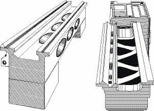

The left lathe bed casting bolts to the headstock, and the right one has an integral base for the headstock.

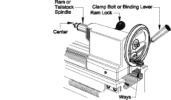

Front view of the tailstock sitting on the ways.

• The lathe bed provides a rigid foundation for the entire machine and holds the headstock, tailstock and carriage in alignment. Lathe beds are usually made of fine-grain cast iron. The machined and ground surfaces of the bed on the carriage and tailstock slide are called ways. High-quality lathes often have induction- or flame-hardened ways to minimize wear. Cast into the beds are reinforcing ribs to increase rigidity against cutting forces. These forces tend to throw the headstock, carriage and tailstock out of alignment. To provide better carriage and tailstock alignment, one or more inverted Vs are typically part of the ways’ design.

• The tailstock is usually a casting that slides along the ways. A locking mechanism called the clamp bolt or binding lever secures it to the ways and prevents it from moving. The tailstock holds a lathe center in its ram for turning or facing. The ram, which is also called the tailstock spindle, is driven in and out of the tailstock casting by a screw thread and handwheel, and locked into position. In addition, the tailstock holds a tool in a chuck or directly in its internal Morse taper. The screw mechanism of the ram forces the tool into the rotating work. Although the tailstock barrel is usually concentric with the headstock, most tailstocks can be moved out of this alignment to cut tapers.
