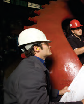

Courtesy of All images: Wilcox AssociatesMassive amounts of data can be captured quickly on the shop floor using portable measuring arms equipped with scanning probes.
Massive amounts of data can be captured quickly on the shop floor using portable measuring arms equipped with scanning probes. Here, a Romer Infinite 2.0 portable arm measures heavy earthmoving equipment with a Scan Shark V4ix laser scanner capable of capturing 485,400 data points per second.
