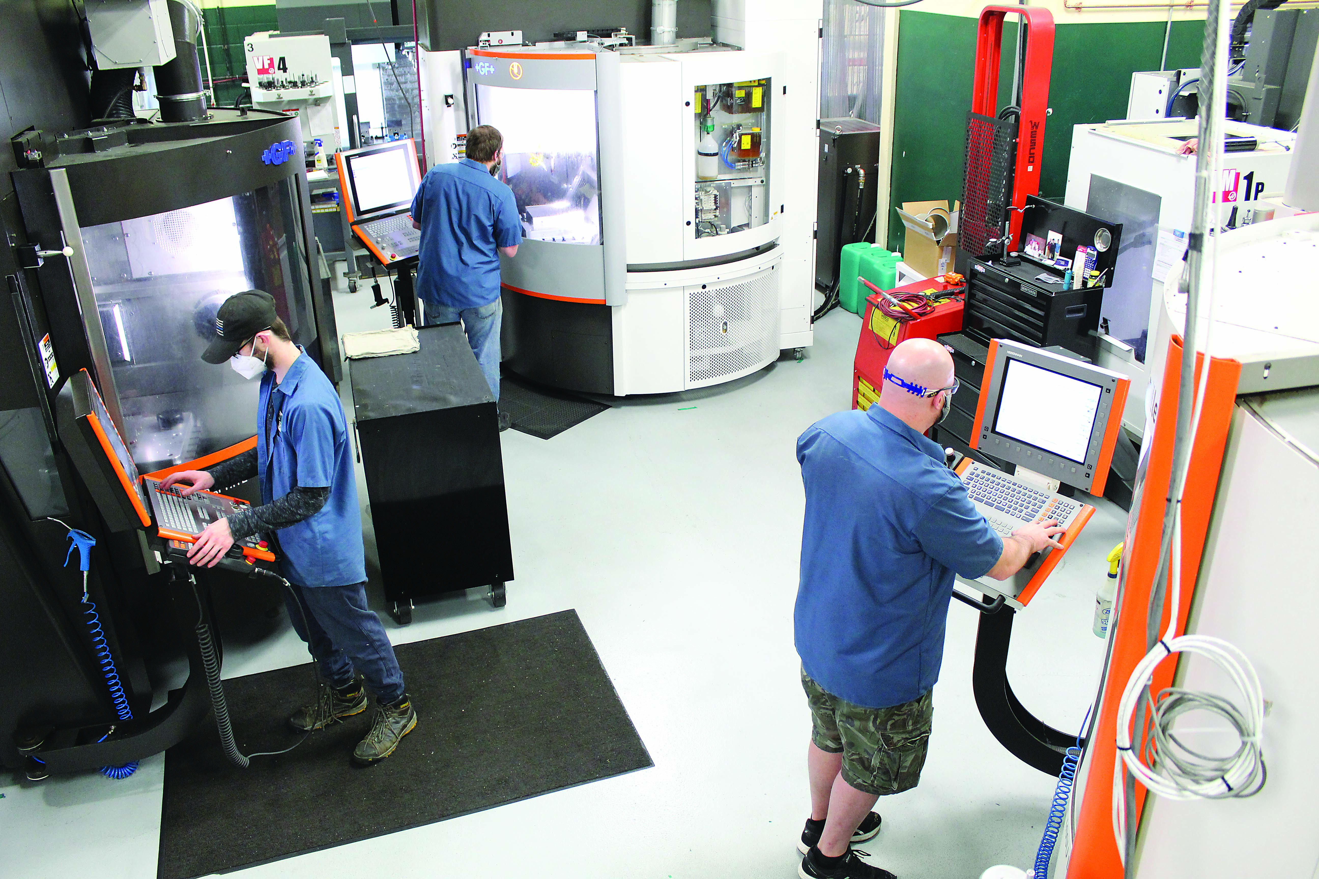

The area that saw the largest enhancement was the hard milling department, which previously included a single Mikron HSM 500 machining center from GF Machining Solutions LLC in Lincolnshire, Illinois. To increase its milling capacity by more than 400% when machining workpieces as hard as 62 HRC, Westminster Tool added a three-axis Mikron Mill S 500, a three-axis Mikron HSM 500 Graphite and a five-axis Mikron HSM 400U LP with automated palletization. The three- and five-axis machines have a maximum spindle speed of 42,000 rpm.

The hard milling department at Westminster Tool is shown. Image courtesy of Westminster Tool

With new machinery comes a larger equipment footprint, so the company reconfigured the shop floor over the winter holidays.
“We spent weeks planning and re-imaging what operations would look like here with the new equipment,” said Vice President Hillary Thomas. “Shutting down the shop for a few days allowed us to move equipment and fully optimize the shop’s workflow.”
The movement placed all hard milling equipment in one centralized cell and set the electrode milling machines closer to the new five-axis machine to reduce transportation of parts between the electrical discharge machining and hard milling departments and to improve communication channels between the two teams.
