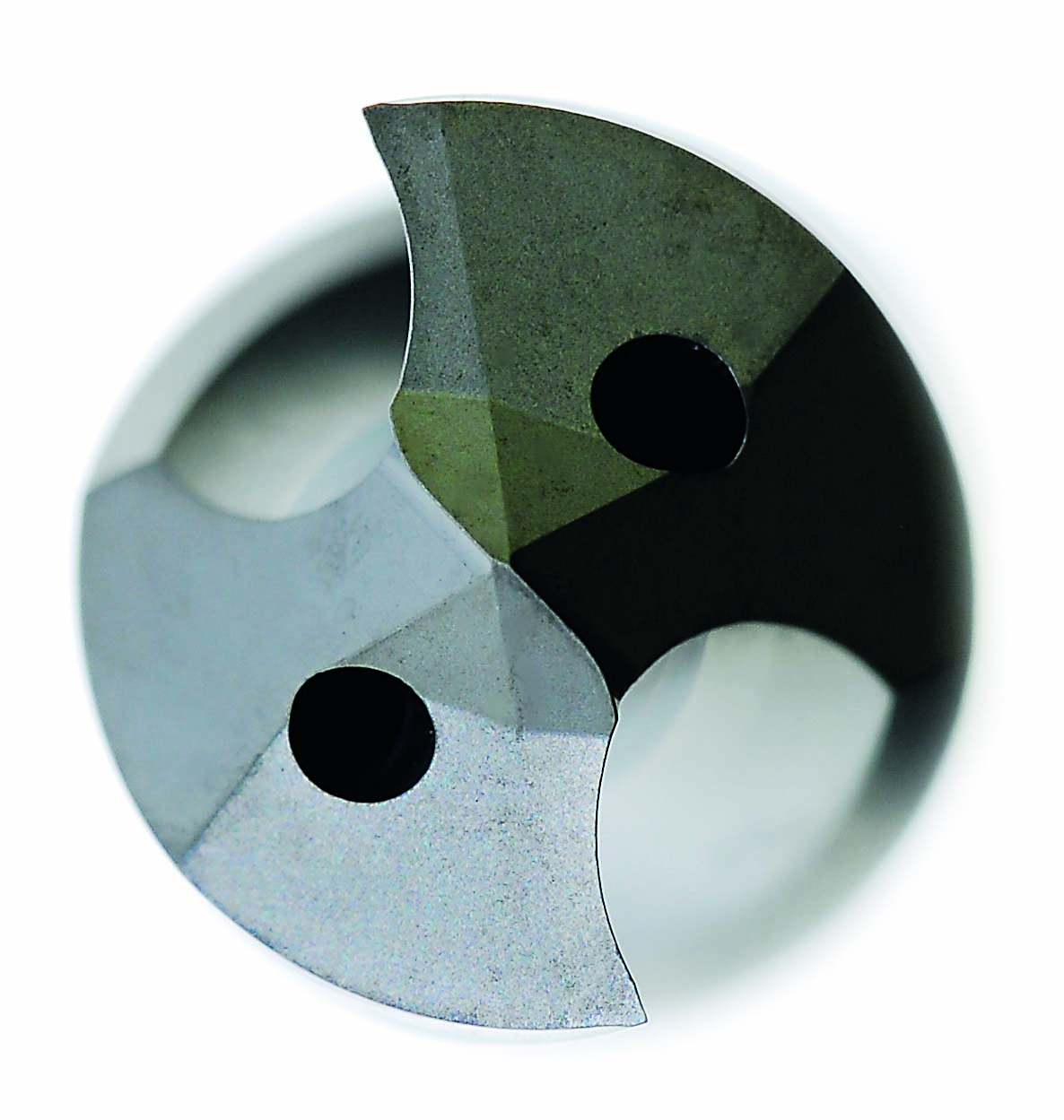

“Four-facet drill points center a little better than all the other drill points we have seen,” said Manfred Lenz, product manager for holemaking and tooling systems at Seco Tools LLC in Troy, Michigan.

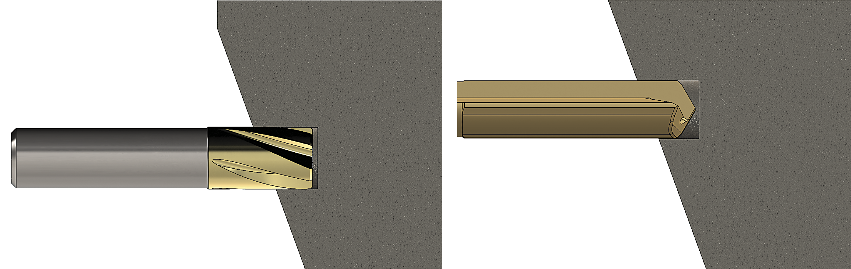

However, Hull said a spot drill works only in situations in which the hole to be drilled is right down the center of a round part. For off-center holes in round parts, he said one option is to use an endmill to produce a round, flat starting point for a subsequent drill. The flat starting surface helps keep the forces on the drill vertical rather than lateral.
Beginning a drilling process with an endmill can serve another useful purpose. Scale that builds up on a cast-iron surface during the casting process is harder than the inner material and difficult to penetrate, McCarel said. An endmill, though, can break through that scale and also create a flat area suitable for drilling on a curved or an inclined surface.

Featuring four facets, the new Feedmax MS drill point is suitable for aerospace applications in which centering is important. Image courtesy of Seco Tools

In these cases, however, the drill needs to be short because side deflection will increase as drill length increases. To drill deeper holes on irregular surfaces, Hull said shops can start the process by drilling a pilot hole with a flat-bottom drill, which will leave a round, flat surface for a standard drill to finish the job.
He reports that flat-bottom drills are becoming a more popular choice for paving the way for deeper drilling on irregular surfaces. As for why, he points out that endmills used for this type of work are offered only in certain fractional sizes, such as 3.175 mm (0.125") and 6.35 mm (0.25").
Endmills “don’t give you the exact diameter you need for in-between drilling sizes,” Hull said. As a result, “you often have to do a circular interpolation to get the correct diameter to properly pilot a drill. So a lot of people are moving to flat-bottom drills that can give them the specific diameter they need for a hole.”

An endmill can be used to spot an irregular surface and prepare it for a subsequent drilling operation (left). Once the endmill has created a pilot hole, the drill has a flat surface to enter (right). Image courtesy of Star SU

A variation of the flat-bottom drill designed to be helpful on irregular surfaces is Seco Tools’ Feedmax SD245A. Lenz describes this solid-carbide tool as “partially a flat-bottom drill” because the drill point is flat except for a very small 140-degree tip in the center. The SD245A also features four land margins — cylindrical shapes ground near the cutting edge for guiding purposes — as opposed to just two on standard drills. Two land margins aren’t enough to guide a drill on an irregular surface, “so it’s going to walk, and it’s going to break,” he said.
He reports that users have found the SD245A design to be particularly beneficial when exiting holes with irregular surfaces.
“People are usually breaking drills coming out of an irregular exit,” Lenz said. “But we put this drill in there, and it solves the problem.”
