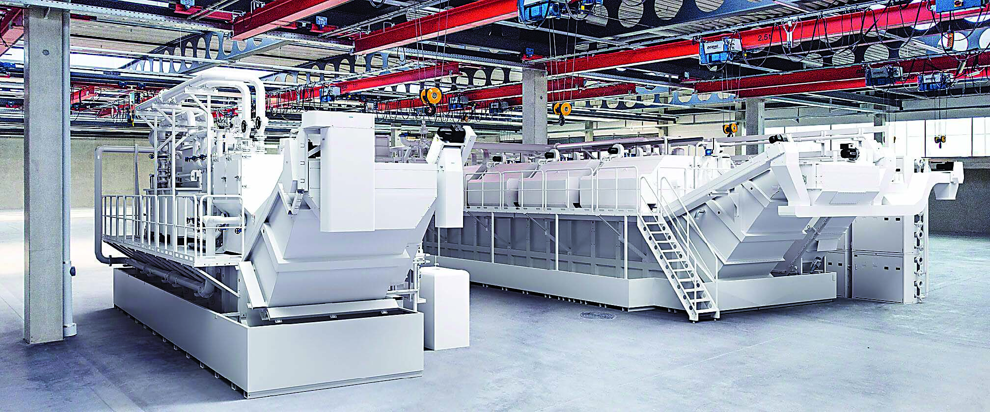

Not only is metalworking fluid a significant expense for part manufacturers and a rising one as the petroleum and other products needed to make it increase in cost, but the environmental protection regulations for scrap and fluid disposal continue to become stricter and pricier when violated, said Justin Viner, regional sales manager for Knoll America Inc. The Madison Heights, Michigan-based company, which is building a new headquarters in Dallas, North Carolina, also offers a wide range of equipment for central chip handling systems, including conveyors, pumps, coolant filtration, shredders, centrifuges and briquetters.
A system solution is required when chips and coolant are transported automatically to a central point and treated there.
A system solution is required when chips and coolant are transported automatically to a central point and treated there. Image courtesy of Knoll America
“The cleaner the chips are, the better it is to get rid of them,” he said, either by recycling or disposing of them.
Viner said an automated central chip handling system enables chip processing to be performed outside a production area, enhancing worker safety.
Using conveyors and sensors, he said the system is automated until the stage at which chips are dumped into containers.
“You can have robots even at that point to reduce personnel costs and remove the chips into containers,” Viner said.

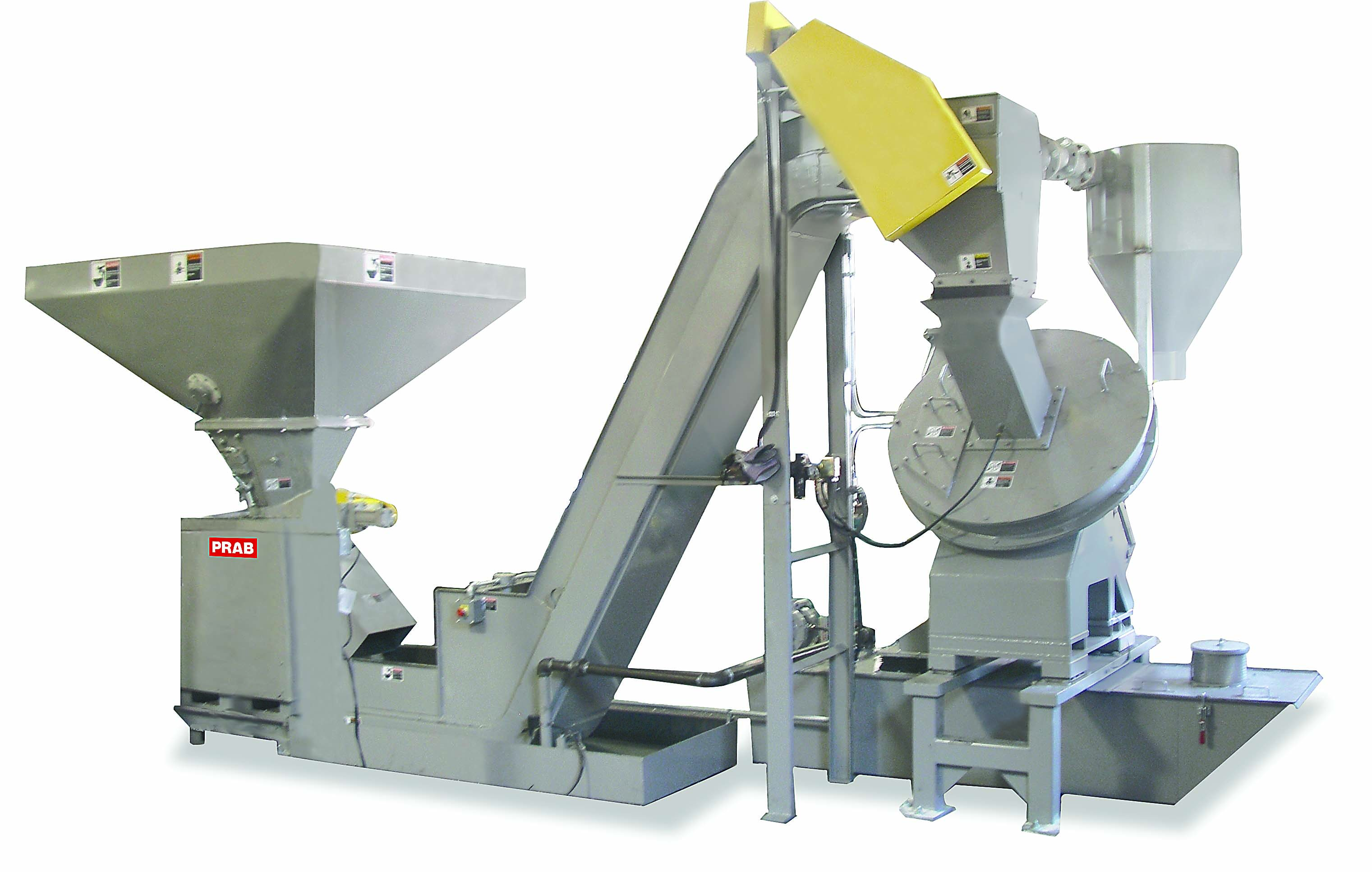

This chip handling system uses a crusher to reduce large bundles and stringy turnings before separating fluid from the chips with a wringer/centrifuge.
This chip handling system uses a crusher to reduce large bundles and stringy turnings before separating fluid from the chips with a wringer/centrifuge. Image courtesy of Prab
He said briquetted pucks are slightly cleaner than loose chips, are easier to transport and enable more efficient re-melts. As a result, recyclers frequently pay more for pucks than dry chips. He offered the example of a customer, Martin-Baker America Inc., which received 17 cents more per pound for briquettes than loose chips.

“Prior to being processed into dry chips or compact pucks,” Gould said, “vertical-axis crushers and shredders are available to make bulky wads of turnings more manageable. A shredder reduces light to moderate wads of metal turnings into flowable chips.”
A vertical-axis crusher, however, reduces turnings and bulky wads into shovel-grade chips. Prab reports that a shredder reduces turnings volume up to four times at the source, and a crusher reduces scrap volume up to a 6-1 ratio.
“A shredder is an option for the company’s E-Series fully automated chip system, which is one of Prab’s more popular offerings,” Gould said. “We recommend it if you have nominal chip throughput.”
He said the system can process a variety of workpiece materials at a rate of 113 kg (250 lbs.) per hour for aluminum chips, 272 kg (600 lbs.) per hour for brass, 340 kg (750 lbs.) per hour for steel and 363 kg (800 lbs.) per hour for cast iron.
“The E-Series system is compact enough to be moved with a forklift,” Gould said. “They’re used for smaller plug-and-play applications.”

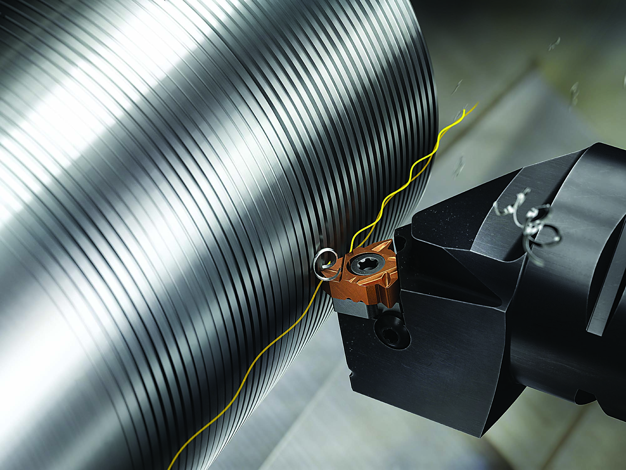

“Even in the final pass when you are creating that full chip form,” Winter said, “you still are managing the chip.”
The resulting chips are 50.8 mm (2″) to 101.6 mm (4″) long.
“That chip is manageable enough that it should get through the chip hopper,” Winter said.
Because OptiThreading creates high cutting forces on a tool as it moves in and out of a cut, he recommends using only CoroThread 266 indexable-insert thread turning tools. The tool body features the iLock interface, a locking mechanism that provides insert security by preventing it from moving in the pocket.
“The CoroThread 266 has a rail within the shim that goes right into the back of the insert and supports it and keeps it from moving,” Winter said. “You get a better-quality thread.”
He said the cutting movement during the OptiThreading process extends tool life because wear is spread over a larger area of an insert instead of one spot when conventional thread turning. Also, having pocket security enables an insert to handle a heavier load and reduce the number of passes, depending on the thread size, finish specification and the number of passes required.
The process is suitable for external and internal threading. Winter said internal threading can be the more problematic of the two because chips tend to ball up more when they’re inside a part. To overcome that issue, he recommends a pull threading operation when using OptiThreading to flow chips out of the part instead of staying inside.
He said tool grades are available for threading a variety of workpiece materials, including steel, stainless steel, iron, brass and heat-resistant superalloys. Sandvik Coromant even successfully tested the process on drawn over mandrel steel tubing. DOM is a metalforming process that starts with an electrically welded formed tube, which is cold-drawn through a die and over the sides of a mandrel.
“I don’t know anyone who can get chip control when threading that material,” Winter said.
