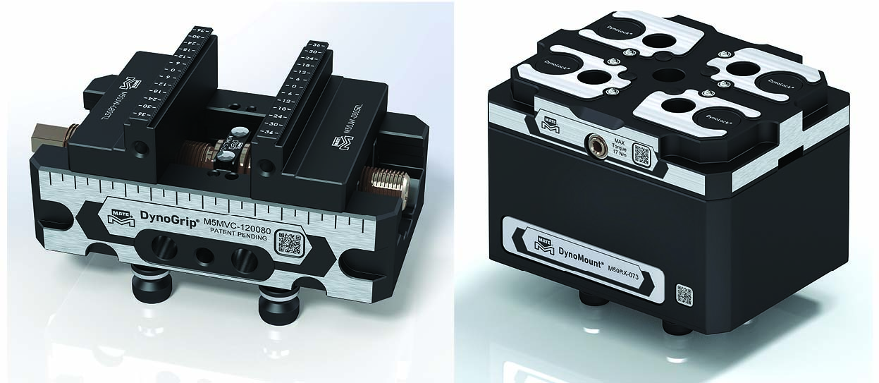

DynoGrip self-centering vises (left) and DynoLock quick-change bases (right) provide zero-point quality engagement with a four-post pull stud pattern. Image courtesy of Mate Precision Technologies
One characteristic of Mate Precision Technologies' new DynoLock bases is the poka-yoke alignment feature. An element of lean manufacturing, the poka-yoke feature is a way to reduce opportunities for mistakes with a mechanism that enables an operator to identify the orientation of the base of a vise so setups are repeatable by design, said Frank Baeumler, vice president of workholding.
"If you create a system that causes you to repeat the same way all the time," he said, "errors are reduced, which is the intent of (the) poka-yoke feature."

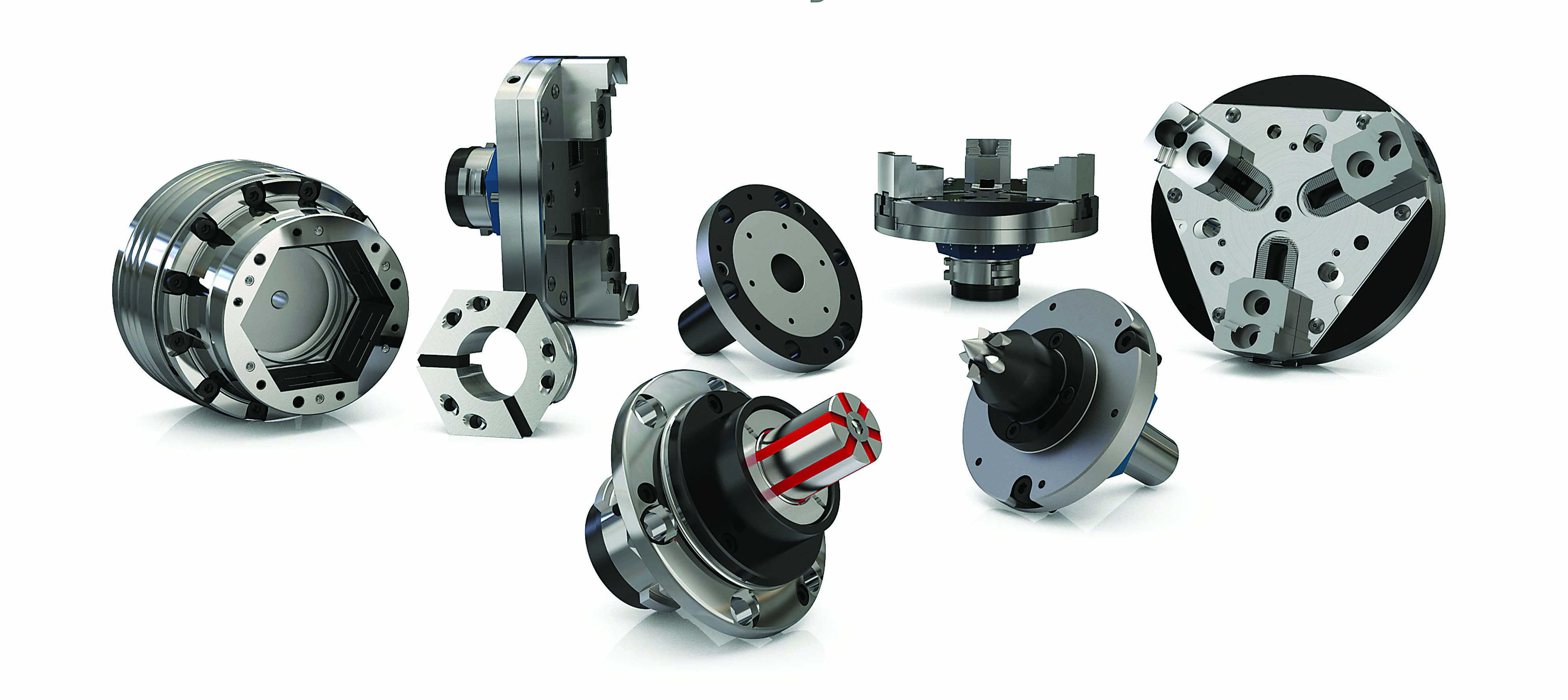

Clamping Head Swaps
Eliminating the need to indicate when going from one clamping head size to another is an important benefit when performing quick changeovers, said Timothy J. Wachs, president of Hainbuch America Corp. in Germantown, Wisconsin.
"They repeat within 5 to 10 microns (0.0002" to 0.0004")," he said about clamping heads using the company's quick-change system. "You don't need to re-indicate or anything. You change the size, and away you go."
Although some people refer to a clamping head as a collet, Wachs said a clamping head has three sections separated by vulcanized rubber, whereas a workholding collet is one solid piece with slits. Hainbuch America offers a fixture changer, which is a hand-held installation gun, to change a head in seconds from one diameter to another.
"We invented the clamping head," he said.
To change a clamping head, Wachs said the company's installation gun is needed.
Pulling the trigger releases the clamping head from the chuck and enables an end user to change to a new diameter "in a matter of seconds," he said.
In addition, Hainbuch America offers quick-change adaptations for its chucks. So instead of clamping on a part's OD, an ID mandrel allows a user to change bushings to different sizes to hold a part's ID, Wachs said.
To hold large parts in a chuck up to 304.8 mm (12"), the company developed the centroteX quick-change chuck system. He said the system permits changing a chuck in 10 to 15 minutes compared with the hours that might be needed to change a chuck conventionally.
"We put a flange plate that goes onto the spindle and then quick-connects to all the other plates," Wachs said, "and you can put anybody's chuck on that flange plate."

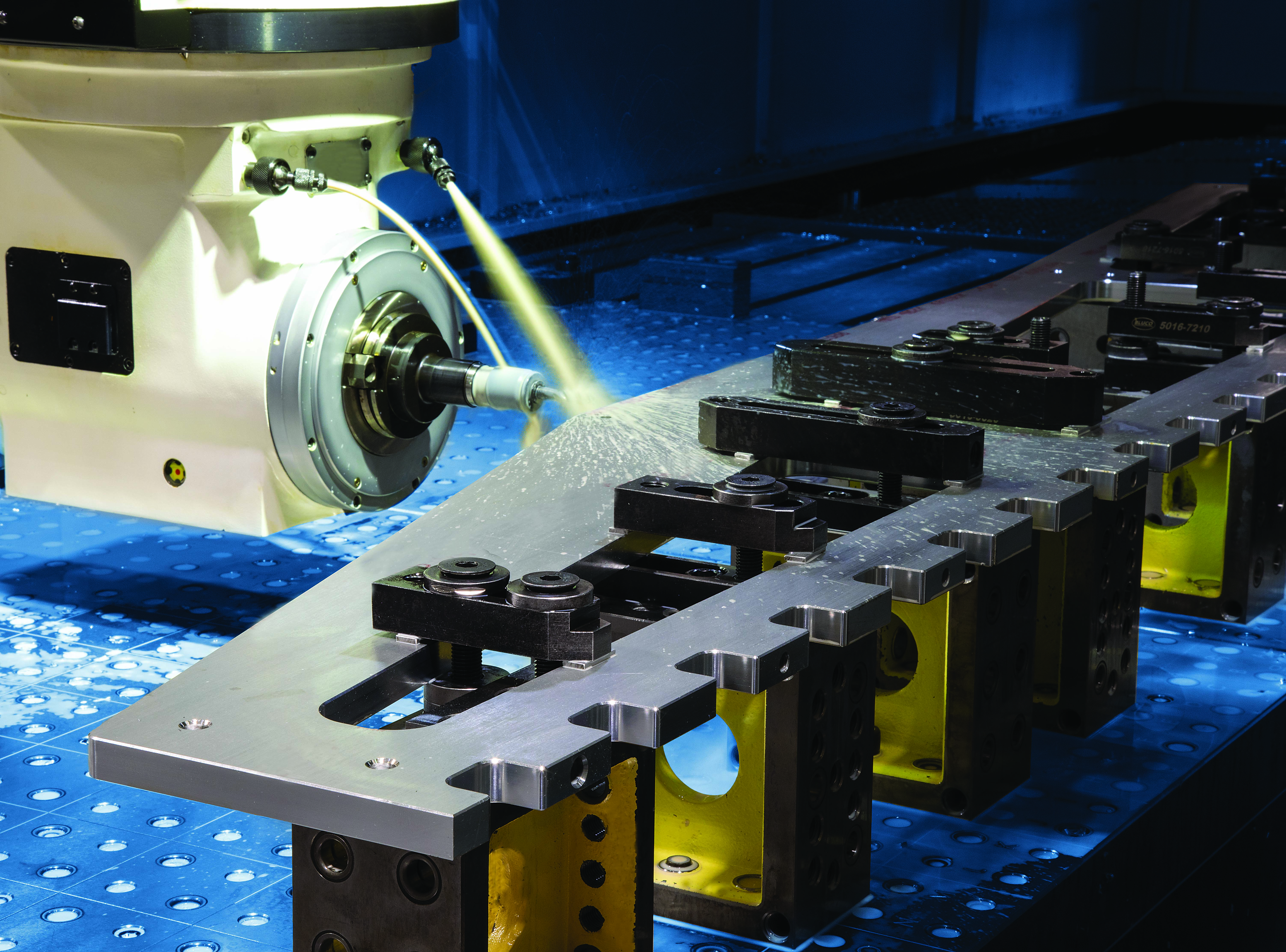

Bluco Corp. is another manufacturer of modular, quick-change workholding. With more than 30 years in the modular fixturing industry, the Naperville, Illinois-based company has evolved a novel approach to fixturing that invites customers to consider more than components and base plates, said Director of Sales Brian Dodsworth.
"Modular fixturing as a category is not new," he said. "It functions like it always has and offers the same set of benefits that it always has. But the way Bluco approaches the design of a solution is very new to most manufacturers. We don't start with an order form — we start with the challenge our customer is trying to solve."
The process begins when a customer shares CAD files of its part or parts via Bluco's website.
"That CAD file, along with the customer's input around what goals they're trying to achieve, is where the fixture design begins," Dodsworth said.

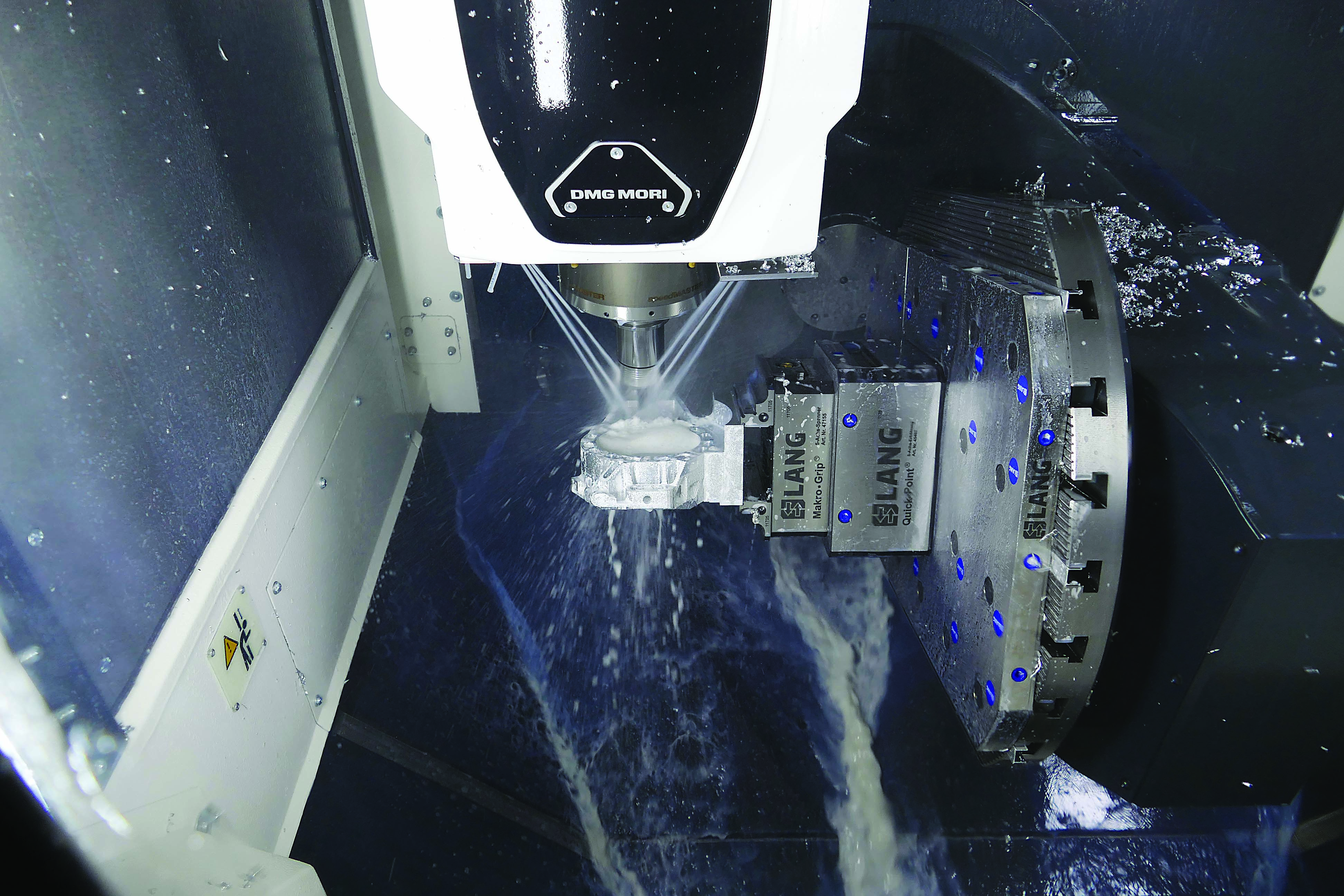

Five-axis machining is shown with a standard 96 mm setup in which a part is held in a vise on top of a riser mounted to a plate. Image courtesy of Lang Technovation
Bluco then is able to customize a workholding system, drawing from more than 350 modular components available in two sizes.
This approach is supported by Bluco's in-house staff of application engineers, on-site manufacturing facilities and Validation Center, which allows customers to try before they buy, Dodsworth said. For manufacturers that specialize in low-volume, high-mix work, including job shops, research and development facilities and even OEM operations producing short runs of a family of parts, the process allows them to tap into expertise that may not be available in-house. The result is increased efficiency and final part quality that otherwise would be difficult to achieve.
"In the end," he said, "this approach delivers a solution that solves an immediate problem and also provides building blocks that can solve future problems."
Of course, modular fixturing continues to offer the timesaving and space-saving benefits it always has when compared with other options: dedicated fixtures or manual setup of an in-house-produced fixture. Although using a dedicated workholder that's already built provides fast changeover, use is limited to one part, and storage can be a problem, Dodsworth said. Homemade fixtures can be both time-consuming to build and difficult to store.
"Modular," he said, "on the other hand, checks all the boxes for efficiency, repeatability, ease of storage and ROI."
According to Bluco, a modular system provides an ROI in eight to 10 fixtures.
"That's a good rule of thumb," Dodsworth said. "We've seen ROI in the first couple of months if they're doing a lot of work and coming from a manual setup. That alone makes modular a slam dunk."

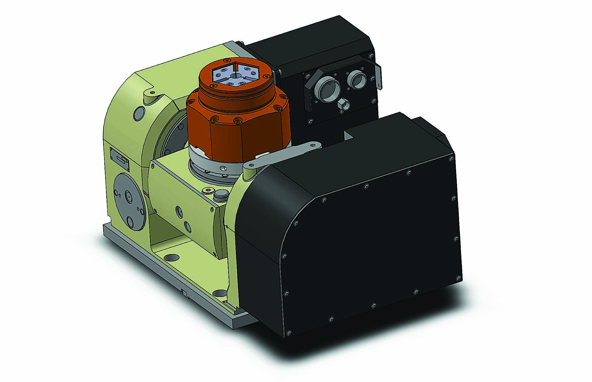

Koma Precision says the TWA-160 tilting rotary table offers high speed and accuracy. Image courtesy of Koma Precision
The East Windsor, Connecticut-based company offers Tsudakoma four-axis rotary tables for VMCs, fifth-axis tables for horizontal machining centers and fourth/fifth-axis tables for VMCs.
"We make a wide variety of table sizes to fit a wide variety of machine tools," Esposito said, "everything from a tiny BT 20 drill/tap machine up to (a) large boring mill."
