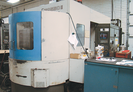

QualTech’s Toyoda FA550 II is a 5-axis horizontal milling center with a 60-tool automatic tool changer. It can be equipped with a two-pallet system to enhance efficiency.
Efficiently machining such large parts is important because time is money, but it’s more critical to establish a reliable process with predictable tool life. That’s because stopping the machine, for instance, to change a tool before it completes milling a surface introduces the opportunity for error, Dechant said. “We might back the speed down to get longevity out of a tool because the tool may be in there for 4 hours working on a surface. Anytime the operator intervenes in the automatic cycle, it creates the potential for something to go wrong.”

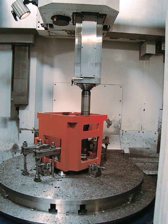

A motor end bracket is milled in an Honor Seiki VL-125 CM 4-axis turning lathe with C-axis milling capability at QualTech Industries.
