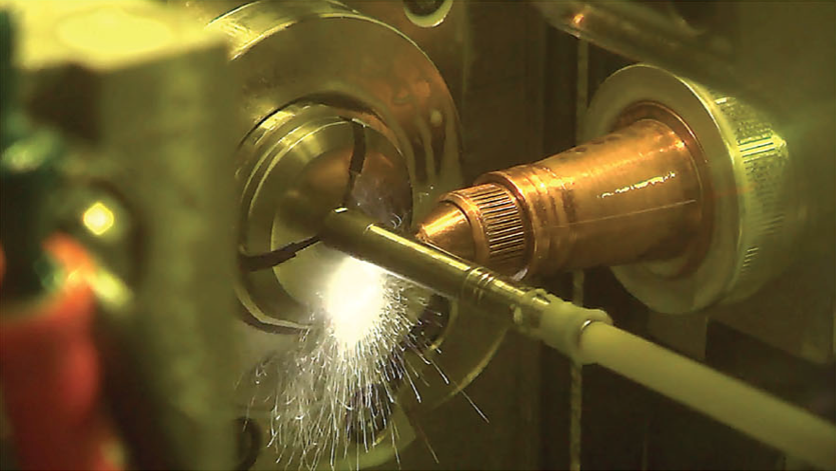

“We saw a large variety of tubular parts that were first laser-cut and then sent for secondary machining operations to add grooves, chamfers, knurls, etc.,” he said. “By combining a laser head with a Swiss-style lathe, these operations, and others, can be completed on a single machine, reducing both part cost and lead time.”

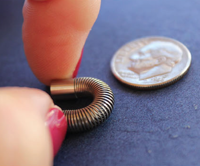

Unlike traditional machining processes, Noake said, laser light exerts no tool pressure. There’s no part deflection or distortion. Also, a laser beam can be highly focused, allowing it to cut slots and holes down to 0.0006″ (0.015mm), features almost impossible to produce with conventional cutting tools.
Even in those cases where a tool is available, lasers cut significantly faster through thin walls, with no worry about damaging a tiny, often expensive, drill or endmill. This capability makes them ideal for stents, pins and other medical components, which often measure less than 2mm (0.0787″) in diameter.

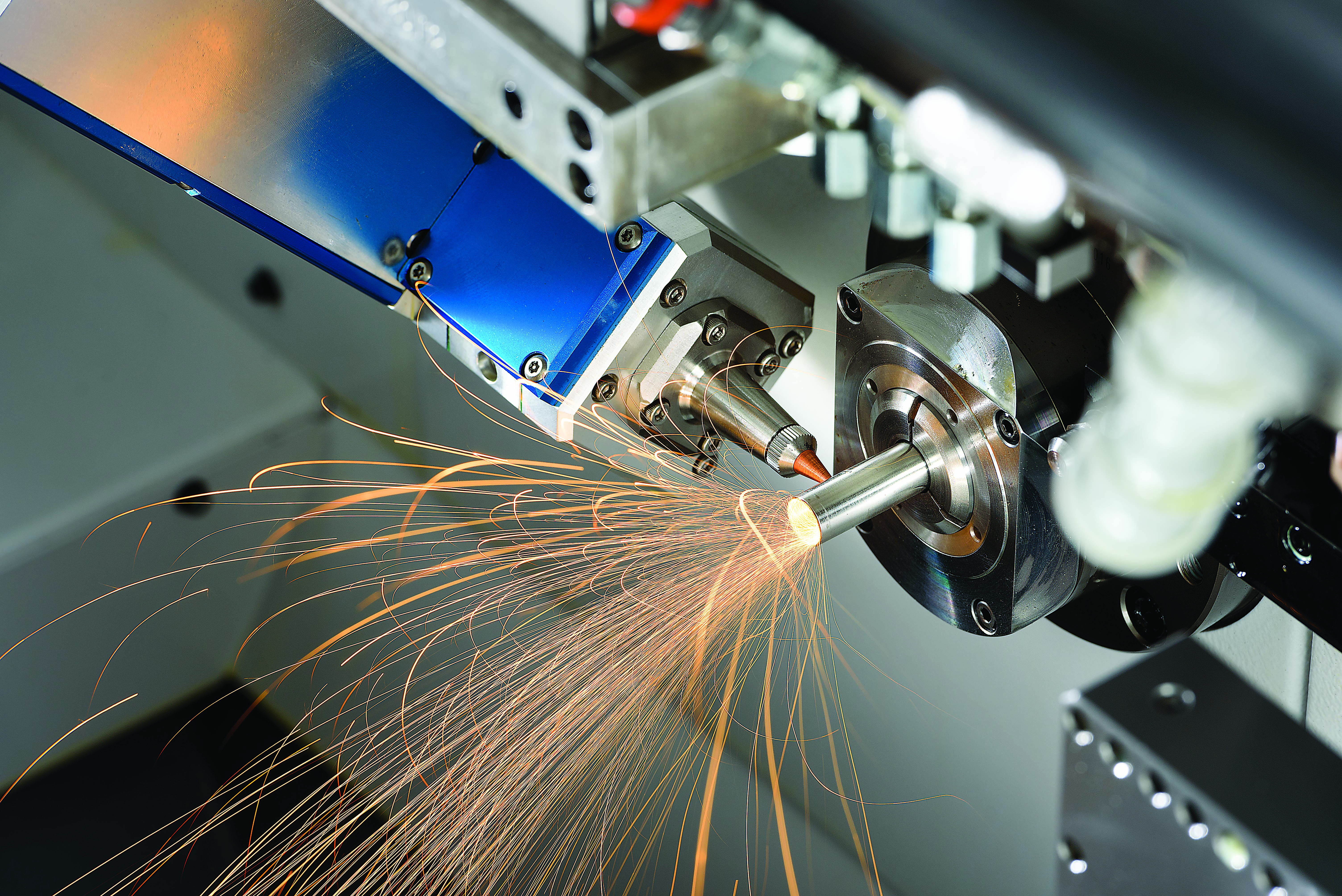

A laser-equipped Swiss-style machine can reduce cycle times and extend tool life on subsequent finishing tools. Image courtesy of Tsugami.
That’s not to say lasers are limited to Lilliputian parts and part features. Tsugami and other machine builders offer laser-equipped Swiss machines with up to 32mm (1.26″) bar capacity and laser power of 400w or higher for cutting walls thicker than the 3mm (0.118″) recommended for lower-powered devices.

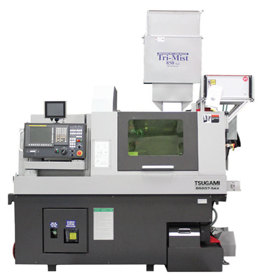

Tsugami’s SS207-5AX is a 20mm, 7-axis, Swiss-type CNC machine with two laser heads, one for cutting and one for welding. Image courtesy of Tsugami.
