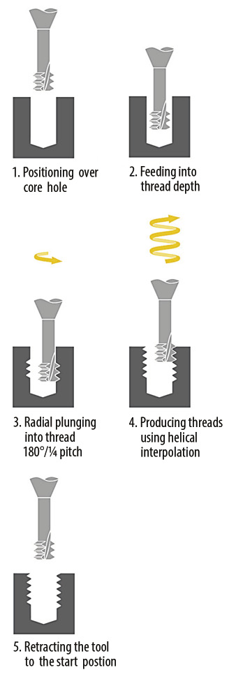

Along with enhanced process reliability, one of the key advantages of thread milling is that it is the only threading technology that allows a combination of two or even three operations to be performed with one tool. Therefore, users can save tool magazine positions and time when, for example, applying a thread mill with a countersink or a thread milling drill with a countersink. And because most threads must be chamfered to prevent burr formation and simplify part assembly, an additional countersinking tool would be necessary without a combination tool.
WAL-207A.tif
The operating method for thread milling.

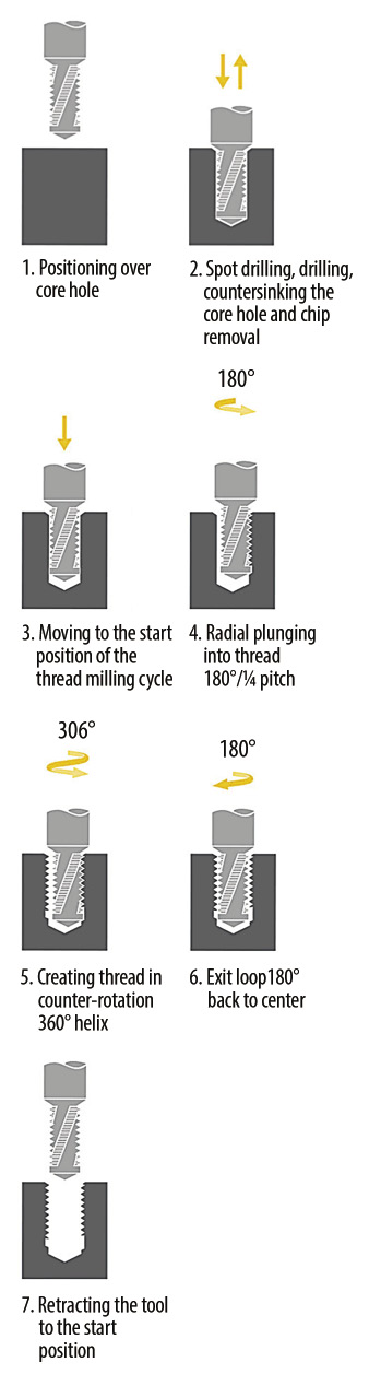

WAL-207B.tif
The operating method for a thread milling drill with a countersink.
Combining drilling, countersinking and thread milling in one work step puts a high demand on the cutting tool. Therefore, a combination cutter is not suitable for all work materials. Thread milling drills with a countersink are suitable for gray iron, ductile cast iron and aluminum alloys. As complex, costly components are sometimes made of these materials, the combination tool pays even greater dividends.
With a combination thread mill, the user can reduce process time by as much as 50 percent compared to using three individual tools through fewer tool changes, fewer tools to produce the finished thread and increased machine uptime. In addition, a technological advantage exists: Because they are produced with one tool, core holes and threads are arranged with exact concentricity to one another.

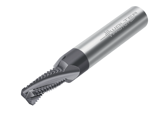

WAL-207D.tif
An array of standard thread mills are available, such as this one from Walter.
