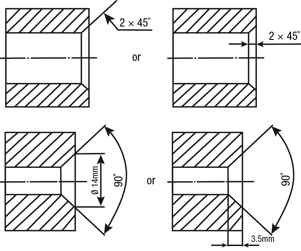

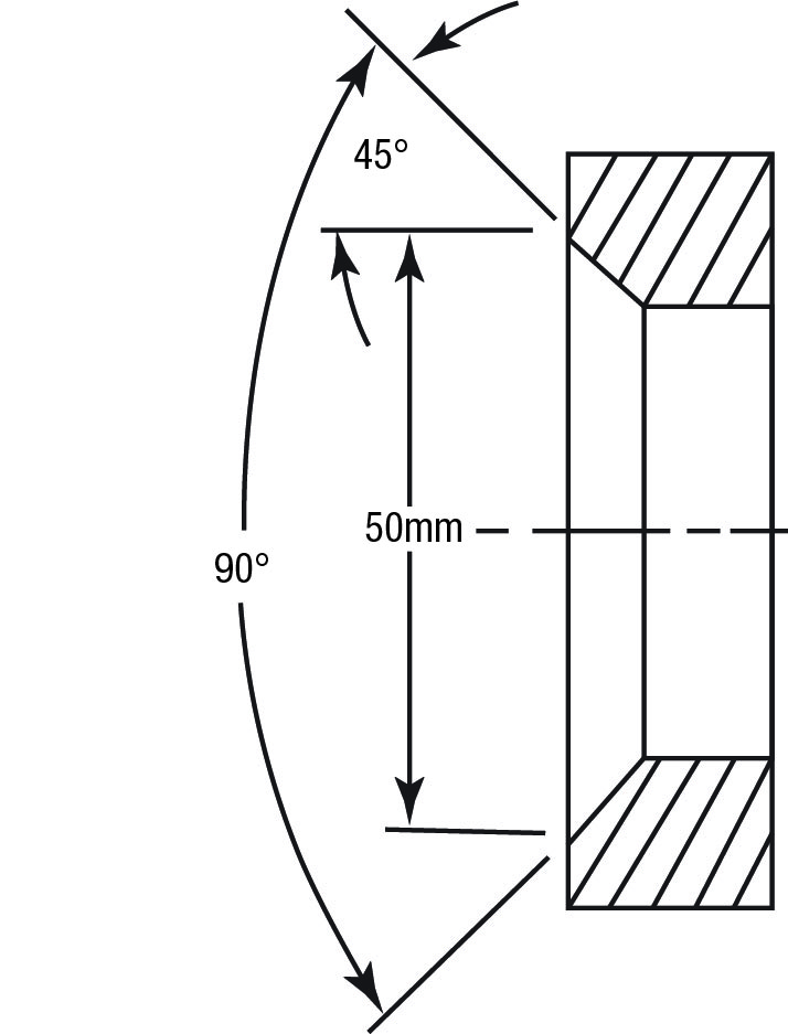

Countersinks and chamfers are called out in various ways on blueprints or can be left to the machinist's discretion. Image courtesy of Emuge. Countersinks and chamfers are called out in various ways on blueprints or can be left to the machinist's discretion. Image courtesy of Emuge. Countersinks and chamfers are called out in various ways on blueprints or can be left to the machinist's discretion. Image courtesy of Emuge.
Countersinks and chamfers are called out in various ways on blueprints or can be left to the machinist’s discretion.
In addition, care should be taken when aligning a tool to countersink or chamfer a hole. Misalignment can be detrimental to part quality and function. A chamfer mill can cut a circular chamfer via circular interpolation but may not be the best design for straight plunging. Conversely, traditional HSS countersinks are designed for plunging applications, but they are not designed for following a helical circular interpolation toolpath.
