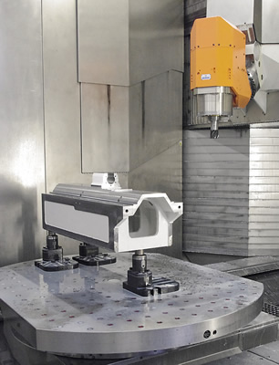

Unilock 5-axis riser chucks from BIG Kaiser Precision Tooling Inc. come in many different lengths and are available on base plates and as stacking modules to elevate a workpiece off the table for clearance or reach issues during multiple-axis machining. Image courtesy BIG Kaiser Precision Tooling.
