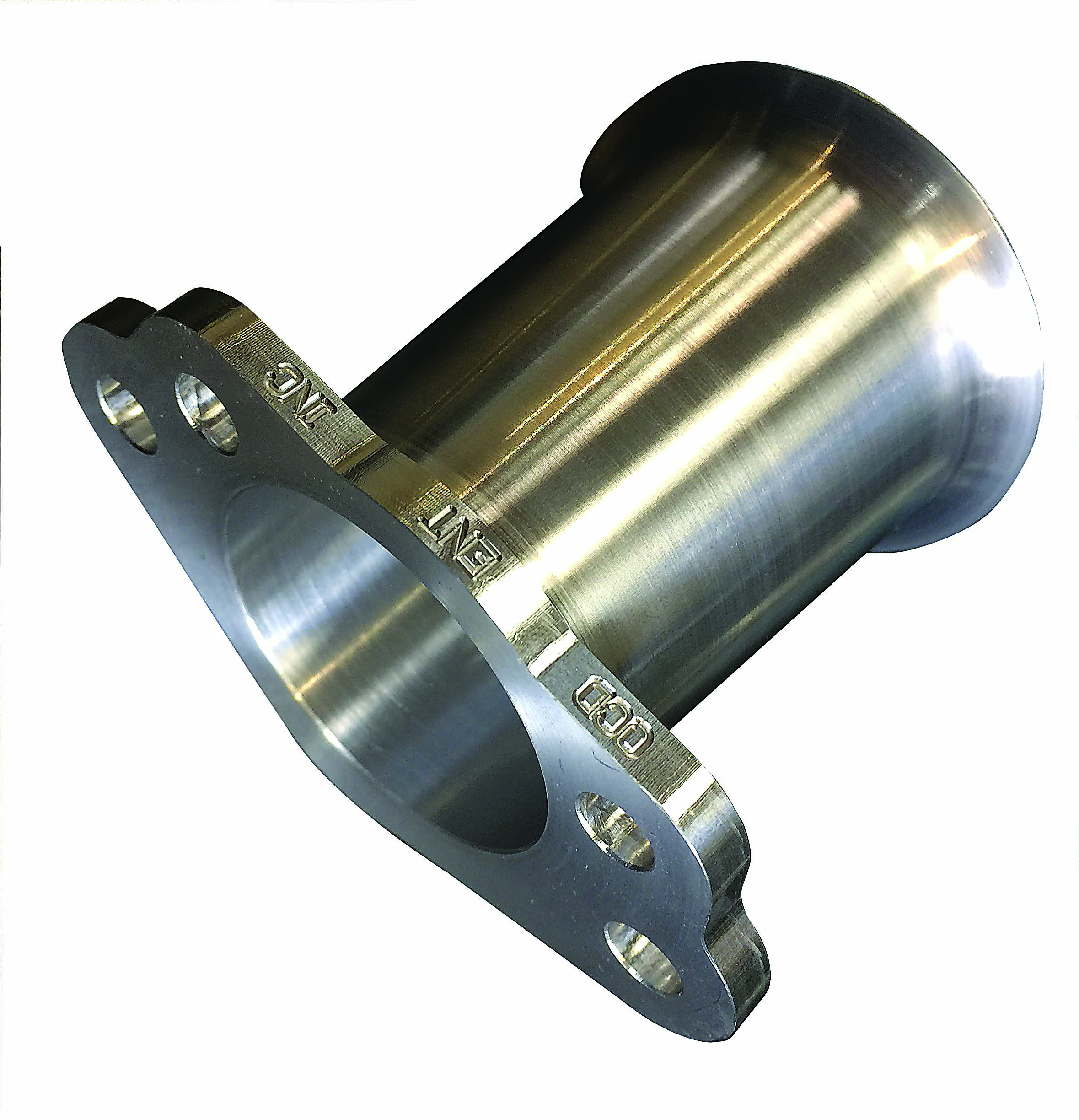

In one MTM application, Beistel said his company produced completed parts in two operations on a multitask machine that would have typically required two lathe operations and two milling operations. After facing the part and boring the ID in the first operation, the second operation involved loading the part onto a mandrel, groove-turning the OD, cylindrical milling (C-axis) the flange, drilling the off-center holes and inscribing the company initials on the outside of the flange.

With GibbsCAM’s MTM option, Beistel Machining completed this part in two operations on a multitask machine that would have typically required two lathe operations and two milling operations.
