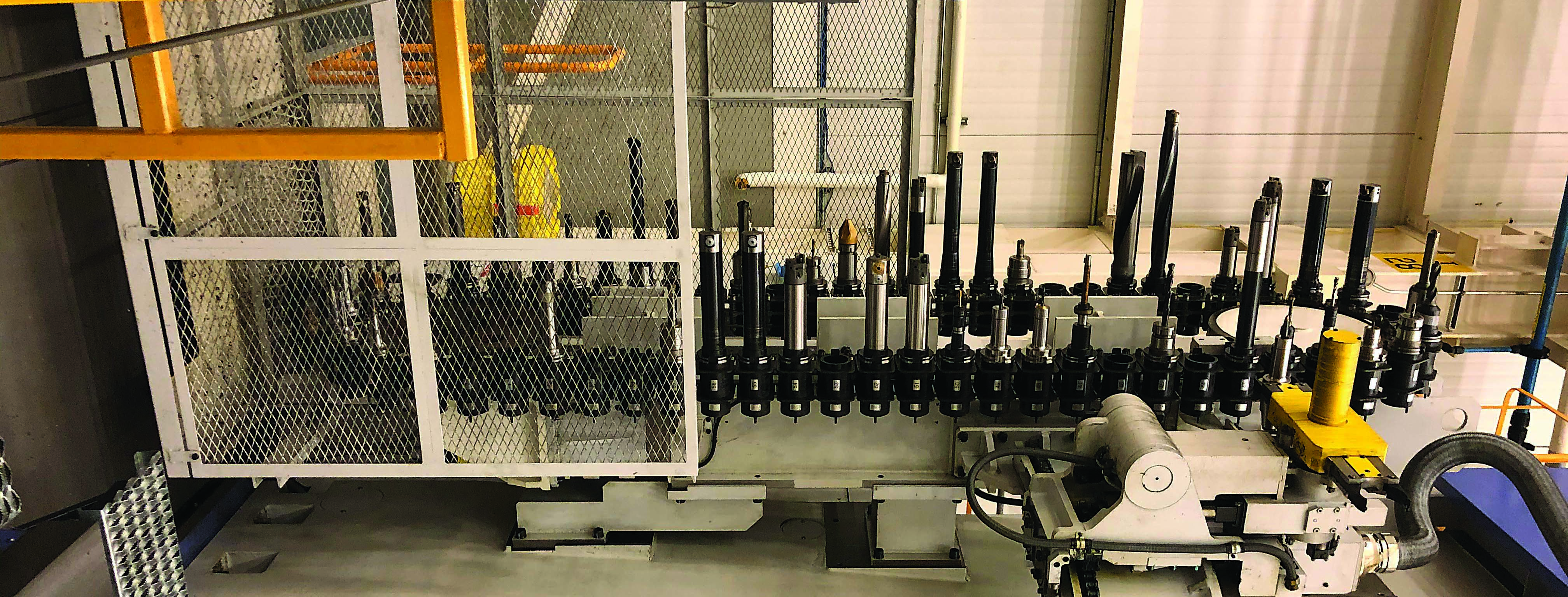

Mitsubishi Hitachi Power Systems Americas stores a large number of tools in horizontal boring mills, reducing the risk associated with moving tools in and out of a machine. Image courtesy of C. Tate
Counters and timers are effective and easy to use but can have drawbacks. Monitoring the spindle load to determine edge condition is more accurate. Devices capable of sensing changes in amperage can be used to determine when a tool has reached the end of its useful life. As cutting edges wear, spindles consume more energy. When the maximum spindle load for a tool has been reached, the control discontinues use of the tool. These devices are the most accurate and offer the most flexibility, but they are also expensive and require someone to develop a set of parameters for each tool.

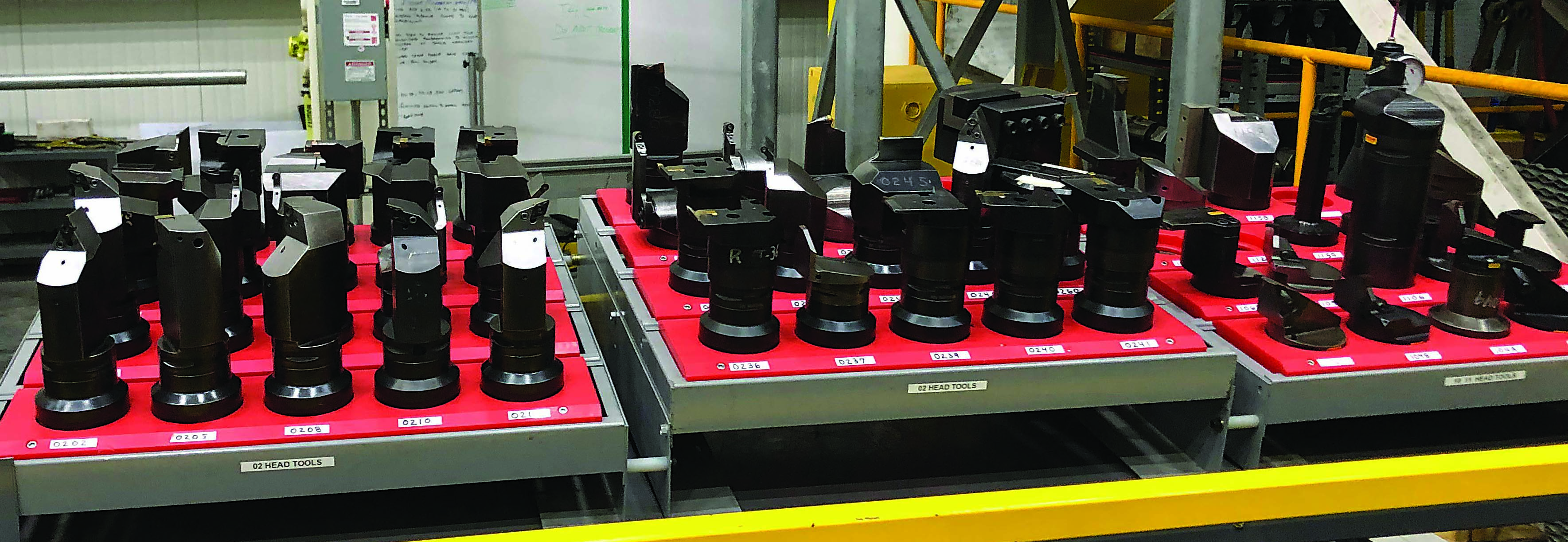

Mitsubishi Hitachi Power Systems Americas opted for Capto toolholders, eliminating the need to set a tool each time it is changed. Image courtesy of C. Tate
For many years, using offline tool presetters has been a common method of obtaining tool data. A tool typically is measured at the presetter, and a machinist enters the data into the control. This approach has two major flaws. First and more significantly, entering data by hand risks putting in incorrect data, also known as fat fingering. Such mistakes can cause scrap, machine tool damage and undetected geometry errors that are not found until much later. Second, the machine almost always is stopped while the activities occur, impacting productivity.
