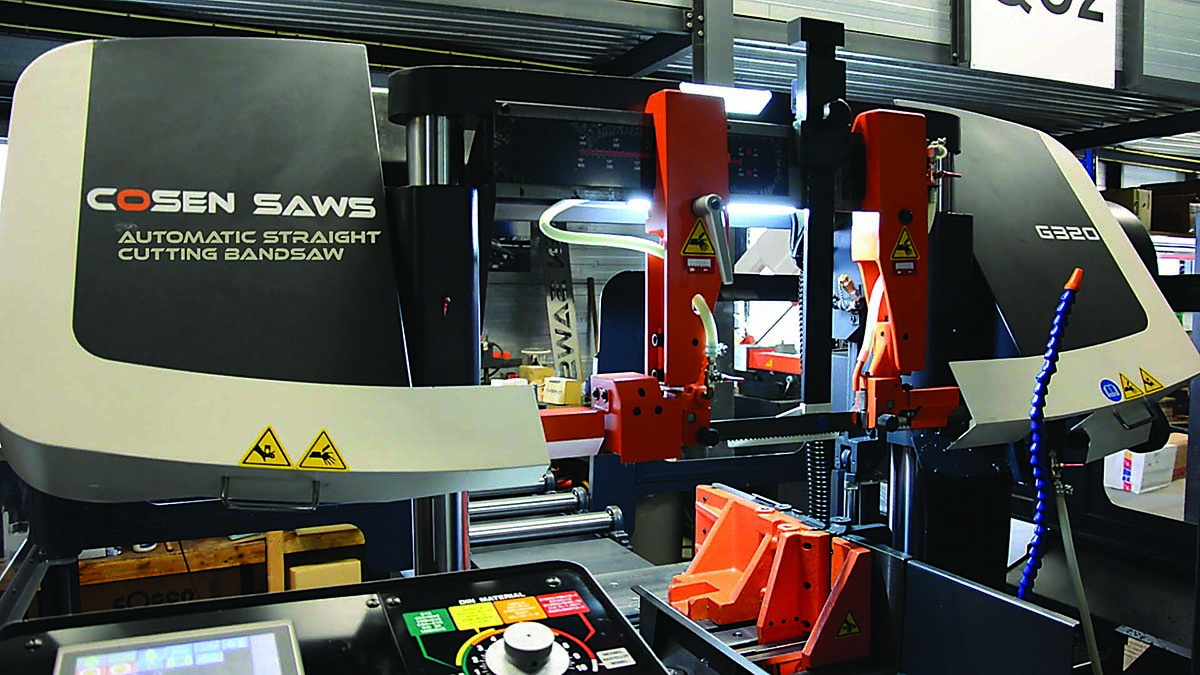

When it comes to sawing raw material, shops typically have two options: doing it themselves or leaving it to a service center or processor that supplies pre-cut material, said Kent Hughes, vice president of sales and marketing at Cosen Saws International Inc. in Charlotte, North Carolina. He pointed out that some shops may feel it’s more efficient to buy pre-cut material than to purchase and store uncut material and then cut it themselves. On the other hand, he said, shops that want to be in control of the process will purchase a sawing machine so they can cut material whenever they need it. He added that an in-house sawing machine is also the less expensive option in the long run and should pay for itself in three to five years, according to most customers he’s spoken to.

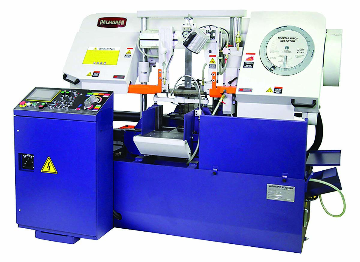

Bandsaws can be fully automatic like this 0.305 m × 0.305 m (1’×1′) dual-column machine. Image courtesy of Palmgren

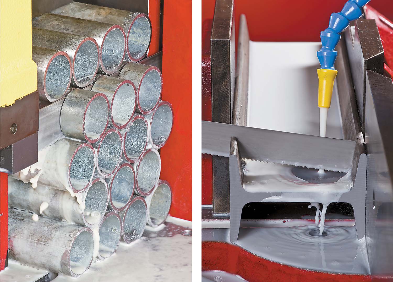

In addition to knowing the specific material being cut, shops should adjust saw speeds and feeds for different materials and use the right coolant for the process. In some cases, he said misting coolants are used instead of conventional liquid coolants when sawing tubing and structural materials.
“The big advantage of that is that there is no (coolant) going down the end of the tube and onto the floor, so it’s a lot less messy” than traditional liquid coolants, Gordon said. “But an argument could be made (that) it doesn’t work as well either, so it’s kind of a trade-off.”
