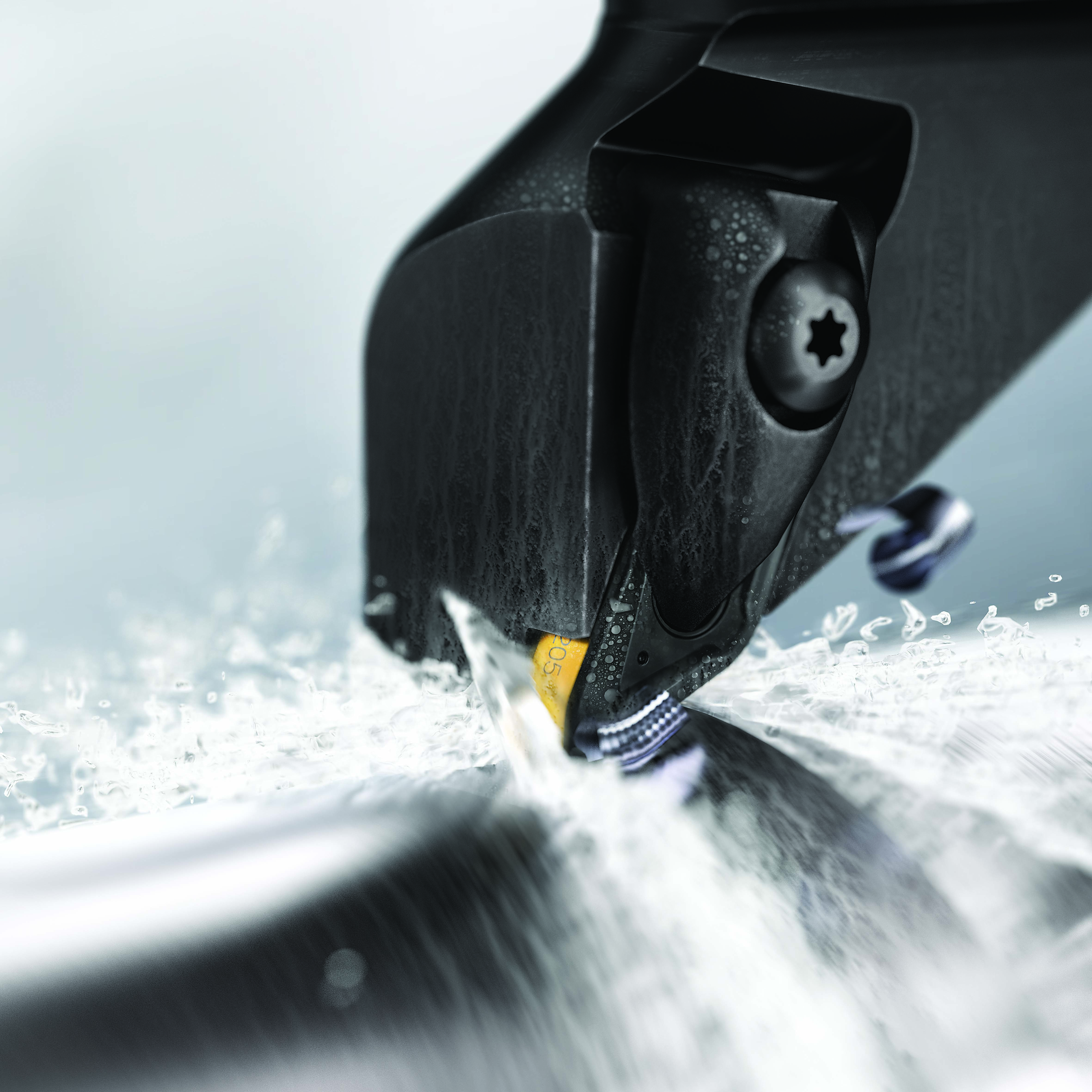

In addition, machining heat-resistant superalloys (HRSA) is common in aerospace applications but challenging, nonetheless. To assist when finishing nickel-base superalloys, Durow said Sandvik Coromant developed the S205 turning grade for indexable inserts. The inserts have a second-generation Inveio coating for high wear resistance and long tool life, and are enhanced with a post-treatment technology that alters mechanical properties, the company reports. The Inveio layer features tightly packed, unidirectional crystals, which create a strong protective barrier around the insert to maximize thermal protection, improve crater wear and better resist flank wear.
Sandvik Coromant developed the S205 grade for intermediate and last-stage turning of heat-resistant superalloy aerospace engine components. Image courtesy of Sandvik Coromant
Because cutting a HRSA sends heat back into the tool rather than being primarily carried away with the chips, HRSA-specific grades are harder than other grades, Durow added. With light DOCs typically employed, the grades also have sharper geometries to shear rather than rub the material, creating less heat at the tool/workpiece interface.
Also helping to dissipate heat is high-pressure coolant streamed through channels that are targeted directly where it’s needed, he notes. “If you have flood coolant, usually what happens is there’s so much heat generated in the cut, you’re just vaporizing coolant in the cutting zone. Also in some applications, it helps move the chip off the top of the insert, so you’ll avoid crater wear on the top of the insert.”
