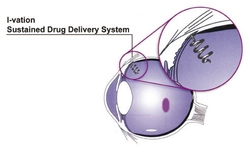

Courtesy of SurModics
The cap at the end of the I-vation intravitreal implant anchors it to the eye, and medicine is delivered via the dissolvable polymer-drug coating.
Innovative eye implant treats retinal diseases
A new coil-shaped, micro drug delivery system called the I-vation intravitreal implant could mark a major advance in treating patients with retinal diseases such as age-related macular degeneration (AMD).
Devised by SurModics Inc., Eden Prairie, Minn., the I-vation is a 5mm-long, 2mm-dia. nonferrous metal and polymer implant that’s placed in the back of the patient’s eye. It’s designed to provide sustained drug delivery. “We’ve had patients in our Phase I study who have had a single implant for up to 3 years,” said Signe Erickson, Ph.D., SurModics’ director of R&D for ophthalmology.
The implant is undergoing clinical trials with the U.S. Food and Drug Administration. Upon successful completion of the agency’s review, which may last several years, I-vation could offer patients a more convenient, minimally invasive alternative to present treatments.
Today, patients with retinal diseases such as AMD and diabetic macular edema typically receive injections of drugs (triamcinolone and others) in the back of the eye every 4 to 6 weeks. Aside from being cumbersome, the repeated regimen poses a risk of infection and tissue damage.
By contrast, placement of the I-vation system entails a one-time, 15-minute surgical procedure, said Erickson. Key to the device’s minimally invasive features are its design and composition.
First, the metal alloy wire “is wound into shape with traditional coiling machines, and a thin cap is laser-welded onto the end that anchors it to the eye,” Erickson said. Its nonmagnetic (MRI-compatible) metal scaffold is then layered with a proprietary SurModics polymer coating that contains the active drug.
“The implant is inserted through a 25-gauge needlestick in the sclera, which is the white of the eye,” Erickson continued. The cap at the end of the implant anchors it to the eye, and medicine is delivered via the dissolvable polymer-drug coating.
Drug delivery rates are controlled by adjusting the drug-to-polymer components. Another advantage of the I-vation implant “is its removability,” said Erickson. “It’s designed to be simply dialed out of the eye in a fairly straightforward procedure.”
