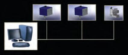

A marking controller (left) can be programmed via LAN or Ethernet, enabling multiple marking systems (top) on the shop floor to be programmed simultaneously.

Today’s most advanced controllers offer the same technology available in the newest PLCs. These controllers have no built-in user interface—they must be programmed with a separate computer. But they represent the next level of marking technology, enabling marking equipment to offer many of the capabilities that usually require a PLC.
Users of such systems can download programs via Ethernet or LAN and program multiple marking systems simultaneously. Advanced control capabilities also allow the marking system to output fault logging and monitoring via a LAN. The logging information contains the exact time stamps for all operations within a cycle and may be studied to see where the operation might be improved. The historical log files contain detailed information about the marking process and show exactly where in the process a fault has occurred.
In addition, detailed monitoring of the machine shows the exact information provided to the marking system from external sources, including operational commands and data strings to print. This combination provides machine information that improves the marking process and troubleshooting.
