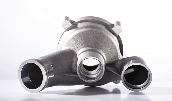

Toolcraft produced this automotive pump housing via metal laser melting. Image courtesy Toolcraft.

MBFZ toolcraft GmbH is another manufacturer that uses Scalmalloy to 3D print those types of parts. According to Managing Director Christoph Hauck, toolcraft uses an innovative process in which the design data for manufacturing a part is divided into cross sections, which are then formed on top of one another during the laser-melting process.
“Due to a special construction process in which the laser jumps back and forth between predetermined melting points, the precision part is produced with a low amount of tension,” he said. “Heat treatment follows the completion of the manufacturing process and makes the final workpiece completely free of tension and ensures it possesses the desired mechanical properties.”
