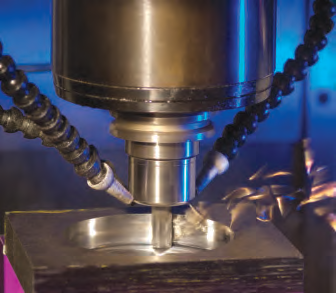

A RampMill consistently produces short chips while circular interpolating a 4140 steel workpiece at 2 diameters deep and a 260-ipm feed rate.
Anyone who’s ever listened to an endmill chomping and grinding on recut chips knows high-pressure through-coolant is a huge advantage. “You can’t recut chips in titanium and Inconel,” Fike said. “If you try, any tool will fail almost immediately. Our center coolant hole solves this problem. Toolmakers have always steered away from this in endmills because it kills the tool’s center-cutting ability, but by designing a tool that ramps rather than plunges, we’ve eliminated that limitation. As a result, tool life when pocketing goes up two to seven times.”
