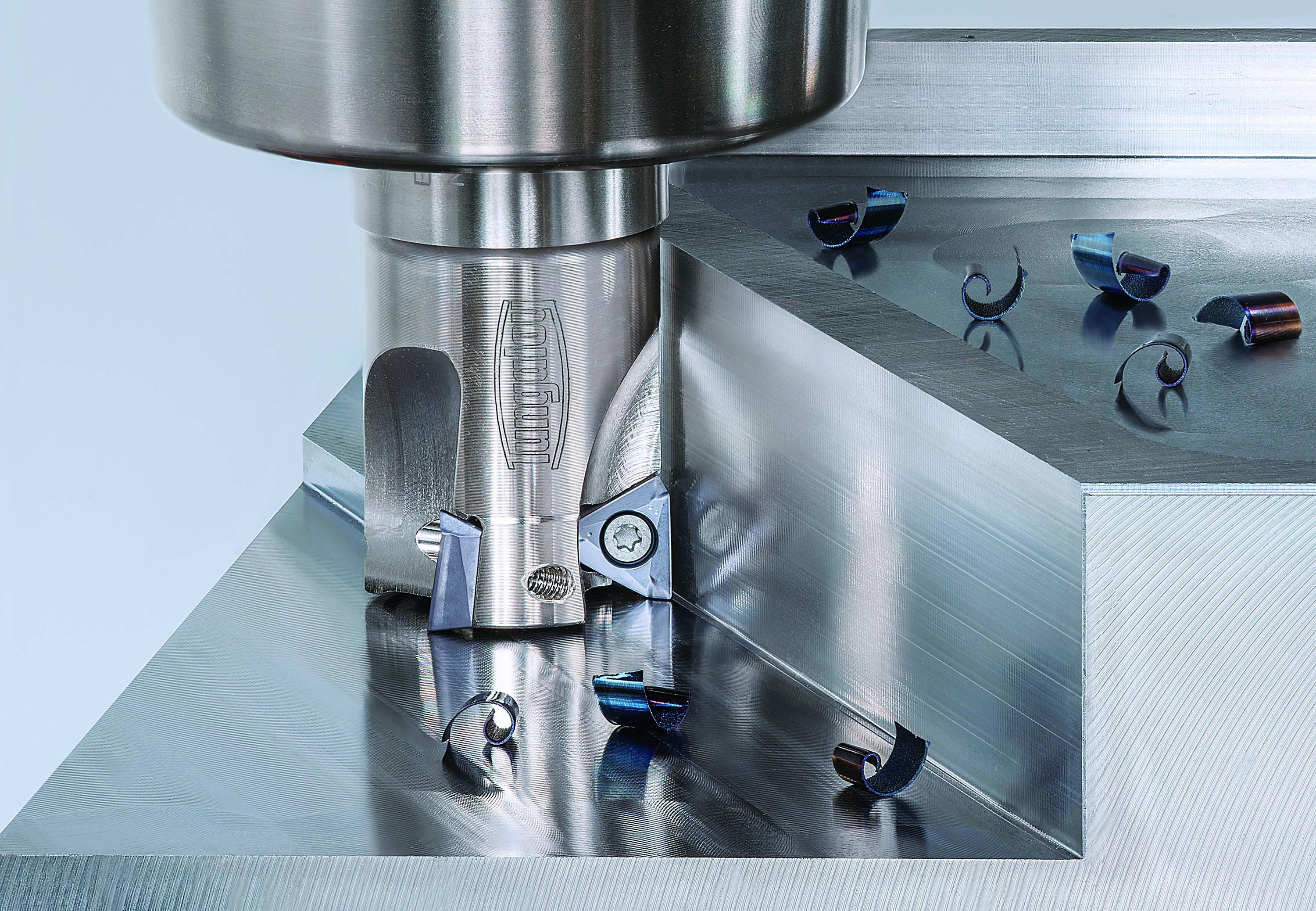

The Tung-Tri shoulder mill has a differential pitch on the cutter to prevent chatter, according to Tungaloy. Image courtesy of Tungaloy America

In contrast, Nagy noted that the shop initially used a 1.5″ shoulder mill but switched to a 2.5″ mill to reduce cycle time when machining the forged steel part, which has a hardness of about 30 HRC. The original cycle time was about 17 minutes, including part loading and unloading, but Seeb Industrial reduced it to 11 minutes. “That high-feed mill took two and a half minutes out of that cycle time.”

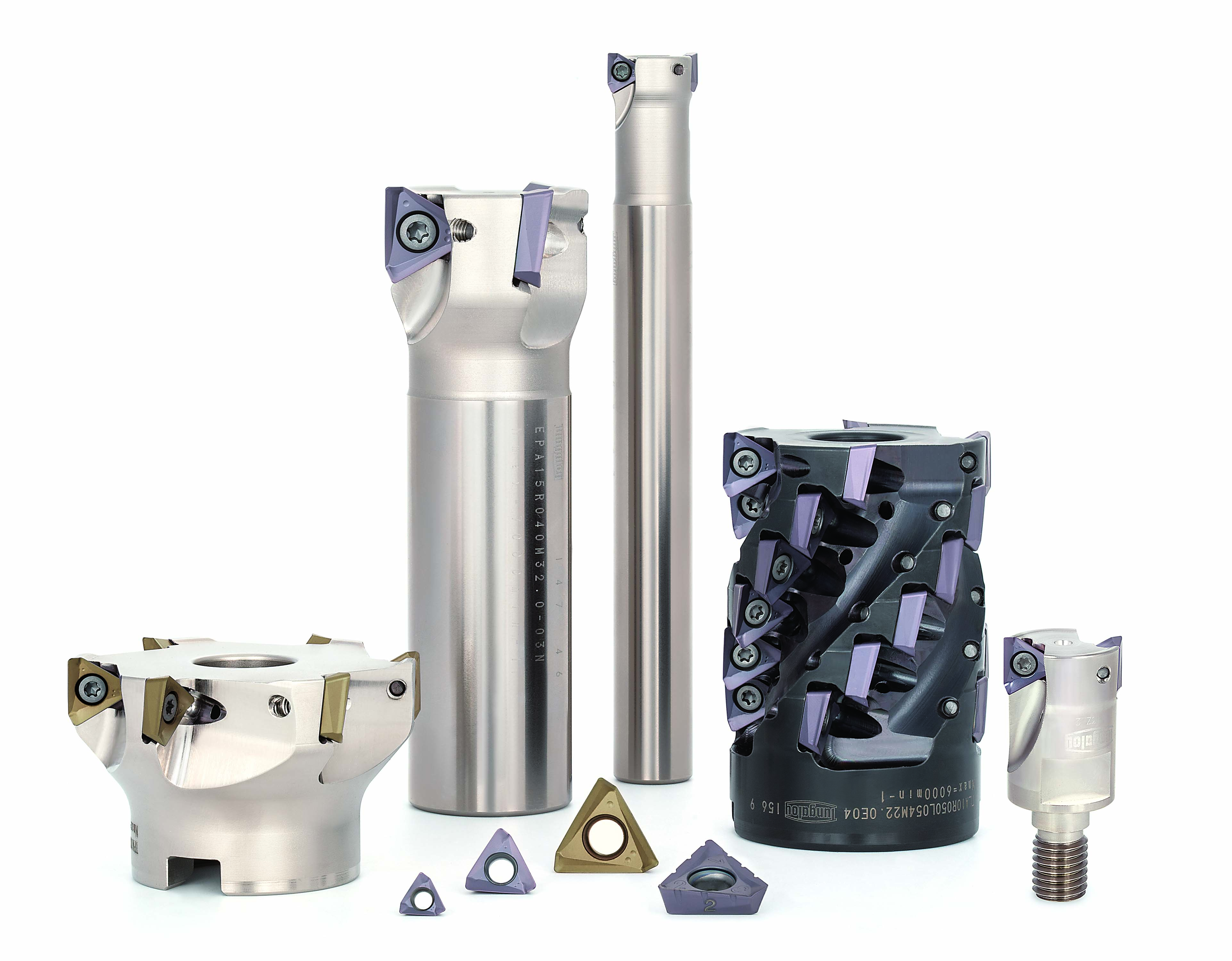

A selection of Tung-Tri indexable shoulder mills from Tungaloy America. Image courtesy of Tungaloy America ​
